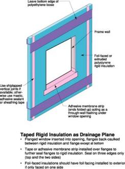

  • Drainage plane, air barrier, and vapor control - In this wall assembly, the 3/8" extruded polystyrene (XPS) fan-fold rigid insulation is acting as the drainage plane (as well as providing a contribution to the thermal barrier). While the XPS does function as a secondary air barrier, the primary air barrier is the interior gypsum board installed using the Airtight Drywall Approach. Note that on the second floor cantilever, there is both an interior and an exterior air barrier. Sealing the joints between sections of the fiber cement soffit is difficult, so blocking is installed and sealed between the floor joists directly above the top plate of the first floor wall.

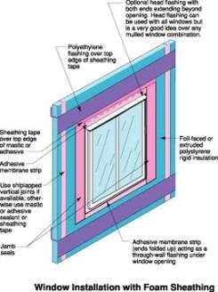

  • Window flashing – Window flashing details are wall assembly or cladding specific. See Figures 2a and 2b or refer to the Water Management Guide.

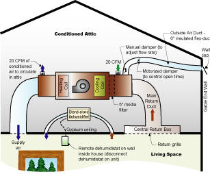

  • Supplemental dehumidification - All homes in this climate call for supplemental dehumidification; the reduced sensible load of high performance homes reduces the dehumidification the AC unit provides, extends shoulder seasons, and raises the impact of occupant-generated moisture. There are a number of different ways to accomplish supplemental dehumidification with varying costs and performance advantages (For a detailed discussion see Supplemental Dehumidification.) Described below is one low-cost yet effective approach and one more costly but higher performance/systems-engineered approach:
     1. Ducted stand-alone dehumidifier: This system is a "site-constructed" and consists of an off-the-shelf standard dehumidifier ducted in the attic and controlled by a dehumidistat located in the living space. This arrangement of individual components has proven to be an effective and economical system for the production home building setting. The installed cost ranges from approximately $350 to $550. The system is comprised of any Energy Star dehumidifier that uses a blower wheel instead of a paddle fan to move air past the coil (dehumidifier located in attic in an insulated enclosure and ducted to living space), Honeywell dehumidistat model H8808C located in living space and Honeywell switching relay (with transformer) model RA89A 1074. See Figure 3.

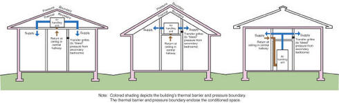

  • Ducts in conditioned space - The preferred method for keeping HVAC ducts and mechanical equipment inside conditioned space is moving them down from the attic, moving the conditioned boundary up (to the underside of the roof sheathing) so that the attic is conditioned also works as shown below. In no case should HVAC ducts be placed within exterior wall assemblies-this is not part of what is meant by ducts in conditioned space. A vented attic assembly may be used in this climate as long as the ceiling plane is air tight and no ductwork or air handling equipment is located in the attic. See Figures 4a-c.
Figure 4a-c

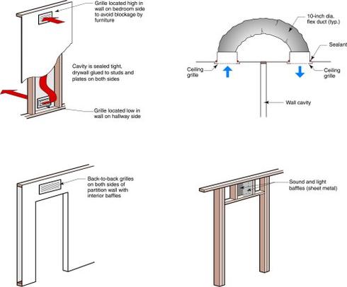

  • Transfer grilles and jump ducts – Single air returns require transfer grilles to provide return pathways that prevent pressurization of bedrooms. Appropriate sizing for ducts, including these pressure relief methods, can be found in the BSC paper, Cooling System Sizing and see Figures 5a-d.

  • 3/8" XPS fan-fold rigid insulation - In order for this material to function as a drainage plane, all joints must be overlapped or sealed. This thin material is easily penetrated – all holes must be sealed.
