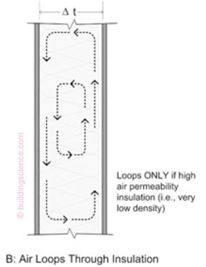

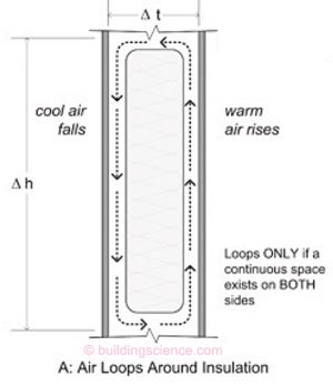

- Convective looping in and around the insulation
The first factor is a contributor to the second. Gaps, voids, and incomplete cavity fills leave spaces in which convective looping can occur.
An omission or degradation in any type of insulation will reduce the insulating performance of the overall assembly.
One of the heat exchange mechanisms that cavity insulations are intended to control is convection. When convective looping is able to occur in or around the insulation, its function is subverted. Also, air moving through insulation because of wind or other pressures can also subvert its performance. Therefore, low density fibrous insulations should be covered by air barriers in areas subject to air movement.

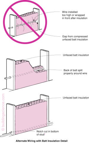

Batt insulation can be a very cost effective option where the framing cavities are of uniform size and where the width and depth matches that of the rolled batt insulation. With rolled batt insulation care must be taken to cut the insulation to fit snugly in cavities and around all obstructions without compression. When batts are cut too short, too narrow, or too wide around obstruction, gaps and the associated problems result. Also when batts have been cut too big for the cavity or have not been cut to adequately accommodate obstructions there will tend to be compression and gaps of incomplete thickness (“rolled shoulders” at framing or wrinkles in the field of the batt). Compressing batt insulation also reduces its thermal resistance (effectively, its R-value). Batts should also be fluffed to full thickness so that they will be in contact with the cavity enclosure on all six sides and not leave gaps for convective looping. Higher density rolled batts are more effective at inhibiting convective looping within the insulation.

Figures 1A and 1B
Convective Air Loops that Reduce Thermal Control of Insulation

Installing Batt Insulation in Cavity with Electrical Wiring
- Roll batt insulation should not be shoved behind obstructions
- Insulation materials should be slit, cut or notched to fit neatly around obstructions
- Insulation material should be fluffed to full thickness
