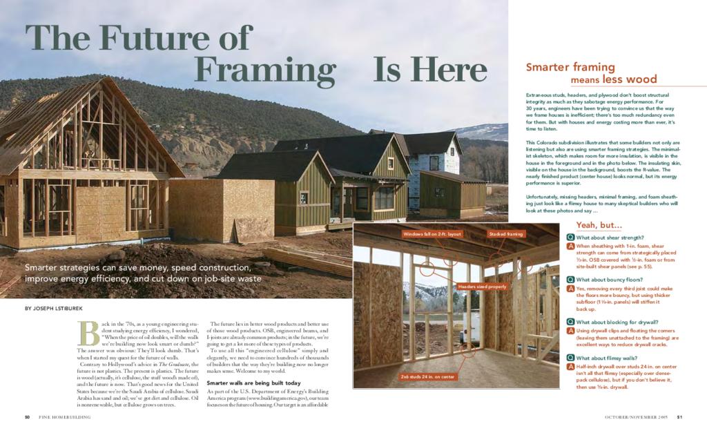

To accomplish the goal of an affordable net-zero house, we have focused mostly on the enclosure. The enclosure of the future will be a lot like today’s best enclosures, which use foam sheathings, housewraps, and spray insulations. But the materials of the future will be smarter (more on that later), and framing redundancies will be gone.
The easy part of our job is figuring out how builders should be framing houses (drawing p. 54). Thirty years ago, the NAHB Research Center developed optimum-value engineering (OVE) to cut the cost of houses by omitting unnecessary lumber (FHB # 84, pp. 46-49). OVE framing increases joist, stud, and rafter spacing to 24 in.; places doors and windows on stud layout; and demands that framing members be lined up (or stacked) for direct load transfer. Coupled with better insulation detailing, those same smart-framing strategies also can reduce the cost of heating and cooling houses.
Lining up framing members directly on top of each other shouldn’t be a big deal, but apparently it is because many builders don’t do it. Stack framing makes everything simpler. Connections for high-wind, seismic, and high snow-load areas are easier to detail, and mechanicals are easier to run when floor framing is spaced farther apart. You have fewer holes to drill and more room to work. Old-school builders may argue that framing on 24-in. centers makes bouncy floors, but if you glue and screw thicker sheathing, you can have a squeak- and bounce-free floor. The extra cost of thicker sheathing is offset by the lower cost of floor framing. Unfortunately, stack framing requires planning. Therein lies the problem.
