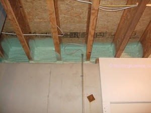

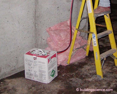

An alternate detail that addresses these condensation and air barrier details quickly and easily is known as the “critical seal”: spray urethane foam insulation is applied to the relevant surfaces, connecting them as an air barrier. In practice, our measurements have shown that this detail provides outstanding building airtightness (when combined with cavity-fill insulation above-grade walls with good airtightness detailing).
High density (closed cell, 2 pounds/cubic foot) or low density (open cell, 0.5 pounds/cubic foot) foams provide acceptable results; open cell foams might require additional vapor and condensation control measures in DOE Zone 6 and higher. Foam can be applied by a spray foam subcontractor, or by the use of small spray foam kits.

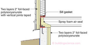

Cold-Climate Rim Joist Detail
- Non spray foam detail that handles condensation and air barrier issues
- Exterior rigid insulation board provides condensation control at interior of rim joist
- Caulk or sealant connection required between framing components and subfloor to maintain air barrier continuity; workmanship-sensitive application

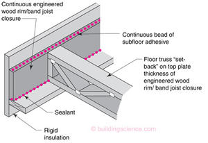

Figure 2
Critical Seal Detail
Figure 3

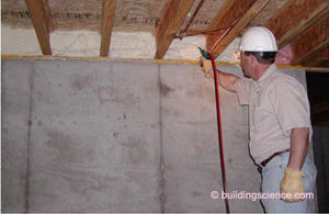

Critical Seal Application at Basement Rim Joist
- Spray foam can be left exposed in basement or conditioned crawlspace application
- For air barrier purposes, spray foam must connect from foundation wall, up rim joist, and to floor sheathing
- Photo above shows basement insulated mid-thickness within concrete (foam insulation placed in concrete forms); exterior insulated basement would be similar

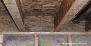

Figure 4
Critical Seal at Rim Joist Between First and Second Floors
- For air barrier purposes, spray foam must connect from first floor wall top plate, up rim joist, and to floor sheathing; of course, connections to remainder of air barrier system (e.g., Air Drywall Approach) must be made.

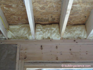

Figure 5
Critical Seal Application with Small Spray Foam Kit
Figure 6
