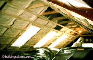

In went some skylights on the back-side (Photograph 1) and the rafters got sprayed full of 2 lb/ft3 density spray polyurethane foam (SPF) (Photograph 2). The attic was turned into living space. Got two bedrooms and a bathroom, a place to store old ASHRAE Journals and a place for mechanicals. Got ourselves a kinda R-35 roof assembly when you factor in the thermal bridging. In 1995 that seemed pretty good. Installed new shingles over a fully adhered membrane and the house looked pretty darn good (Photograph 3). I felt pretty clever. Life was good.
Photograph 1 (above left): Original Roof
– Uninsulated rafter framing with board roof deck. Furring straightens out rafter plane for smooth plaster finish. Yes, skylights went in. Yes, they are big thermal holes. But a space needs to be a space or what is the point. It took us many millennia to get out of caves. Kind of dumb to build one on the top of your house. Let the light shine in. Dormers were considered but we didn’t want to change the appearance that drastically.
Photograph 2 (above right): Rafter Cavity Insulation – high-density spray polyurethane foam fills rafter cavity (2 lb/ft3 density).

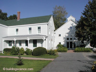

Photograph 3: Finished Roof Back Then
– Looked pretty good seventeen years ago. New shingles were installed over a fully adhered membrane applied directly to the original roof decking.

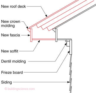

Figure 1: Roof Edge Detail
—Overhang extended to hide the thickness of the over-roofing rigid insulation.

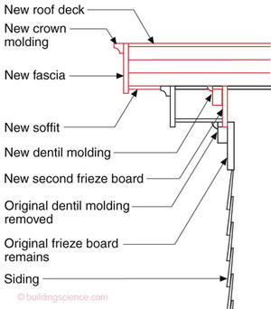

Figure 2: Gable End Detail
—Overhang cut and then rebuilt to hide the thickness of the over-roofing rigid insulation.

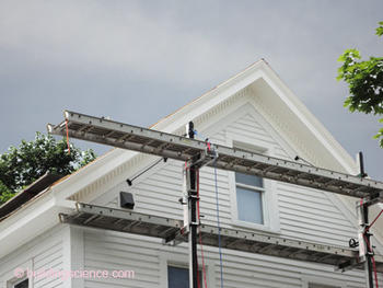

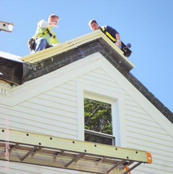

Now comes the really, really big point. The 6 inches of rigid insulation added to the top of the existing roof deck needed to be done in a manner that was “invisible”. The trim, the frieze boards, the fascia and the overhangs all had to look like they “belonged”. They had to look “original”. Don’t believe me? Ask an architect. Trust me on this. I didn’t get it at first. I get it now. If it does not look “right” it is not “right”. Don’t do ugly things. Figure 1 and Figure 2 show the general approach. The overhangs on the gable ends were cut off, rigid insulation added to the top (Photograph 6) and then the overhangs rebuilt as box beams (Photograph 7). Then the box beams were trimmed out (Photograph 8) and a double frieze board installed to hide the increase in roof thickness without requiring redoing the gable end siding (Photograph 9).
Photograph 6: Over-Roof Insulation
—The gable overhang has been cut flush with the wall sheathing. Also note that a new fully adhered membrane is installed on the original roof deck replacing the one installed 17 years ago is folded down to catch the top edge of the wall water control layer. Further note that the 3 layers of 2-inch rigid insulation are cantilevered over the wall to take into account the likely possibility of retrofitting exterior continuous insulation on exterior wall framing in the future. The exposed edges of the 3 layers of rigid insulation are to be sealed with another layer of membrane.

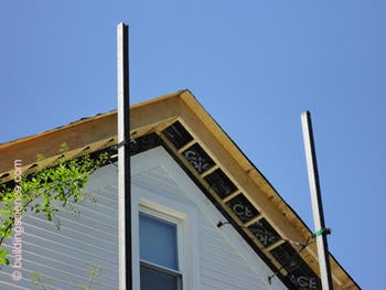

Photograph 7: Box Beam Gable Framing
—New gable overhang is framed in the form of a box beam hanging off of a new layer of roof plywood roof sheathing cantilevered over the top of the 3 layers of rigid insulation. The exposed edges of the 3 layers of rigid insulation are no longer exposed.

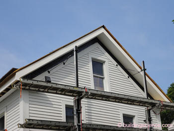

Photograph 8: Cellular PVC Trim—Trim fascia and soffit installed. Dentil molding and crown molding and frieze board to come.
Photograph 9: Trim Installed
—Dentil molding, crown molding and double frieze board done. Note that a second frieze board is installed catching the top edge of the original frieze board. Double frieze boards are not uncommon in New England so that the second frieze board does not look out of place. This approach allows us to leave the original frieze boards in place along with not having to remove and reconstruct the gable siding. Next step stainless steel drip edges and shingles.

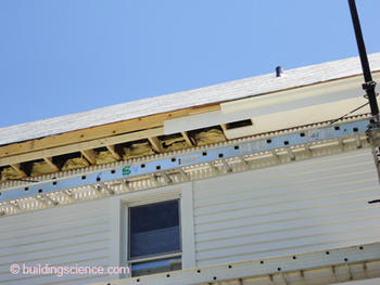

On the front of the roof edges of the roofs, the overhangs were extended to hide the thickness of the roof insulation (Photograph 10). The original rafters are extended—but original roof deck sheathing cut back to be flush with the original wall sheathing. This allows the new roof membrane installed on the original roof deck to run down and catch the wall water control and air control layer. Why not just cut the original rafters flush with the wall as well and do the box beam thing on the front similar to what was done on the gable ends? Good question. I felt the overhang would have been a bit too large for that treatment on the front. Had I added a bunch of insulation to the walls as well at the same time making the wall much thicker thereby reducing the overhang I would have done the box beam approach like I did when I fought the ants (see BSI-056: Leiningen vs. The Ants Redux). Since I intended to phase the work—do the over-roof first—and then the walls later—maybe a lot later—the rafter extension approach was the one I went with.
Photograph 10: Roof Edge Framing and Trim
—Original rafters are extended – but original roof deck sheathing cut back to be flush with the original wall sheathing. This allows the new roof membrane installed on the original roof deck to run down and catch the wall water control and air control layer. Original dentil molding and frieze board are left in place. New cellular PVC fascia, crown molding and soffit installed. Note the 2 lb/ft3 spray polyurethane foam enhancing the air seal around the extended rafters. This foam is applied over the top of the membrane that came down from the roof deck catching the wall control layers.

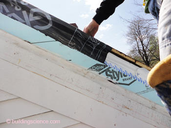

One of the keys to over-roofing is to tie the air control layer of the roof assembly to the air control layer of the wall assembly. On the gable ends this was pretty easy. The fully adhered membrane wrapped down over the cut back roof deck to tie into the wall water control layer and air control layer (Photograph 11). On the front of the roof edges the original roof deck sheathing was cut back flush with the wall and the fully adhered membrane folded down around the rafter tails to catch the wall water control layer and air control layer. This was then “foamed” to complete the air seal. Go back and check out Photograph 10.
Photograph 11: Roof to Wall Air Seal
—Note the connection of the new roof deck membrane overlapping the trimmed back original gable overhang and catching the “white” housewrap water control layer and air control layer behind the wall exterior insulation (the “blue” layer of foam). The three layers of rigid insulation have yet to be installed over the top of the roof decking at this point. This air seal is pretty darn good. Note that there was no air seal at this location originally. Dumb. I have to come clean here as well. I resided 17 years ago over one layer of continuous rigid insulation. Not enough. Dumb. Should have installed much more. I will get around to fixing this eventually as well. Yes, I will share the experience. I can point out just how dumb I was on the walls as well 17 years ago. But the real mistake was not making the air seal at the top of the walls 17 years ago. No excuse, I knew better then. Got sloppy, careless. It happens, even to self proclaimed gurus.

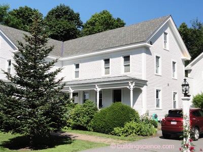

The finished roof hides the insulation over-roofing (Photograph 12 and Photograph 13). Compare the trim details of Photograph 13 with the original trim details of Photograph 5. Not bad eh? This stuff needs to be “invisible” or it will not happen. Find yourself an architect who gets it and helps make it invisible.
Photograph 12: New Shingles Installed
—Neighbors were pretty nervous until the shingles got installed. What is the crazy guy up to this year? I sure hope it does not end up looking dumb. I heard he had ants. Sheesh. Talk, talk, talk. Neighbors are such a pain.

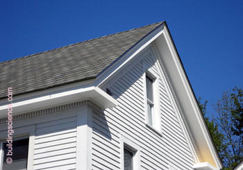

Photograph 13: Finished Trim Details
—Hah! Can’t tell this roof is a super insulated over-roof – which was the whole point. This stuff needs to be “invisible” or it will not happen. Find yourself an architect who gets it and helps make it invisible.
Notice the increase in overhang dimension on the gable ends. This is not just to match the overhang on the front. Apparently, I did not add enough insulation to the walls 17 years ago either. The increased overhang sets the stage for my next project, over cladding the walls.5  Later. Maybe much later. Just remember, whatever you do, don’t do ugly things.
