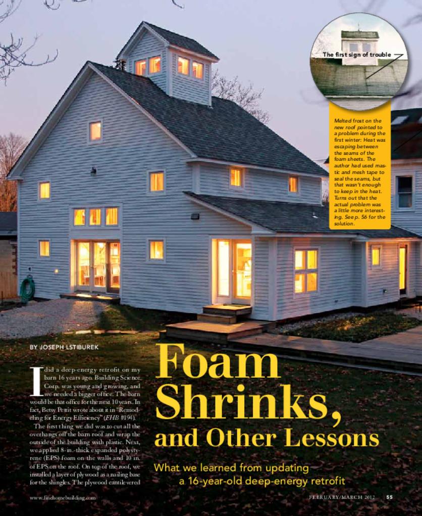

I did a deep-energy retrofit on my barn 16 years ago. Building Science Corp. was young and growing, and we needed a bigger office. The barn would be that office for the next 10 years. In fact, Betsy Pettit wrote about it in “Remodeling for Energy Efficiency” (FHB #194).
The first thing we did was to cut all the overhangs off the barn roof and wrap the outside of the building with plastic. Next, we applied 8-in.-thick expanded polystyrene (EPS) foam on the walls and 10 in. of EPS on the roof. On top of the roof, we installed a layer of plywood as a nailing base for the shingles. The plywood cantilevered past the edge of the barn’s roof to form the
new overhang.
Our first lesson came about four months after the retrofit was complete: When the first frost hit the roof, I discovered an obvious melting pattern. At the seams between the foam panels, warm air was escaping and melting the frost. Rather than installing one thick layer of foam, I should have installed multiple layers, offsetting the joints and staggering the seams. I decided to fix that when I replaced the shingles.

When I took the photo of my frosty roof on p. 55, I thought the heat loss was the result of using a single layer of foam, which meant that I couldn’t stagger the sheets and offset the seams. That is what I’ve been telling people all these years in my confessional speeches about deep-energy retrofits. That, however, was only part of the problem. Now I know the rest of the story.
When we installed this foam, we covered the joints with mesh tape and mastic. Over time, the panels shrunk, and the tape/mastic combination cracked, opening the seams. This is where the heat came through to melt the frost on my roof.
