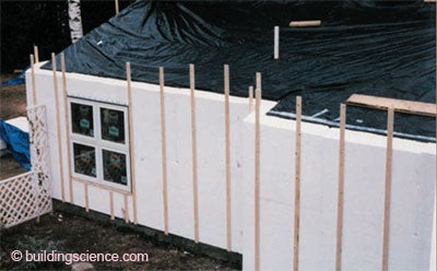

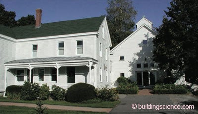

I had seemingly done the perfect barn renovation 15 years ago. I installed a continuous water control layer, a continuous air control layer, a continuous vapor control layer and a continuous thermal control layer. I back ventilated my cladding system. It was all perfect (Photographs 1, 2 and 3). It looked great. I gave myself an award.2

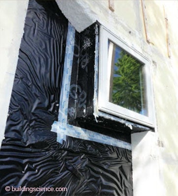

Photograph 1: Perfect Wall—Water control layer, air control layer and vapor control layer outside of structure. EPS rigid insulation thermal control layer held in place with 1x4 wood furring strips over the top of everything else. The world’s largest Canadian Beer Cooler built in Boston 15 years ago. Back-ventilated siding yet to be installed on wood furring strips.

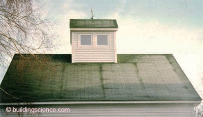

Photograph 2: Rigid Roof Insulation—Note the billowing polyethylene air barrier/vapor barrier. I should have known then.

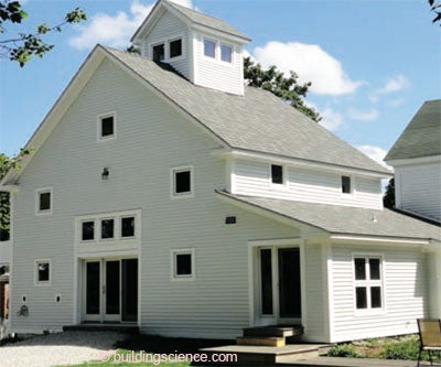

Photograph 3: Good Looking Barn—In this case the beauty is only skin deep.
Apparently, the perfect renovation was not so perfect. The ants didn’t come right away. Only a few in the first couple of years. The scouts to an invading army? My imagination getting the better of me? “Nah, get a grip,” I kept telling myself. But I couldn’t stop thinking of Charlton Heston, or was it Eleanor Parker? Then more ants came. And still more. The ants were winning. Suddenly they were everywhere.3 Where were they coming from? Why were they coming here? Why my perfect barn? Were the old wise men of building science wrong? How could that be?

It was so obvious it was embarrassing. I had already had enough embarrassment with the barn renovation. I learned about three-dimensional airflow networks the first year after the renovation—the first winter in fact (Photograph 4). I should have never installed the roof foam in one layer. It should have been done in several layers with the joints off-set horizontally and vertically.4 This was nothing that some old roof guy couldn’t have figured out or prevented. Ouch. But I already knew about this. Dumb, yes. But dumb that I knew about already. I needed to find new dumb. It didn’t take long.
Photograph 4: The Embarrassment Starts—Can anyone say 3-D airflow network?

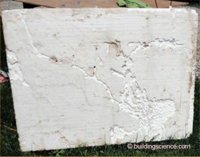

I found the ants. Tracked them layer by layer. Yes, they loved my foam. They made themselves a fabulous ant condominium—a fabulous ant “gallery” (Photograph 5)—in two spots. But I was ecstatic. Huh? The crew thought I was nuts. I was jumping around all happy about ants in my foam. Why so happy? The ants were only in two spots in the whole damn building. They were in the only two “wet spots” in the whole damn building. The ants only loved my “wet foam.” Where there was dry foam there were no ants. Duh. And it gets even better.
Photograph 5: Ant Gallery—The ants don’t eat the foam, they live in it. But they like and need water. Good thing I made sure they had some. This is a 4 ft x 6 ft (1.2 m x 1.8 m) ant gallery. There was one other like it. That was it for the entire structure: two of these bad boys. But the gallery went through the 10 in. (245 mm) thickness. Lots of space for lots of ants and lots of aggravation.

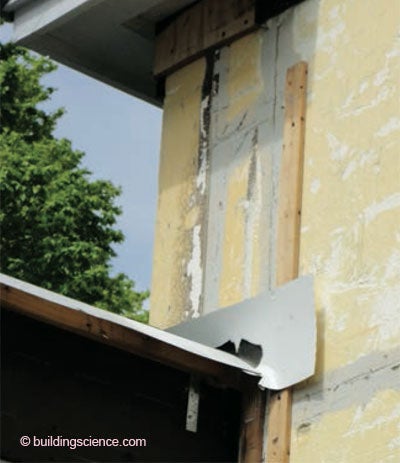

The wet spots were due to something really obvious—something unbelievably embarrassing—reverse flashing. Reverse flashing in two critical areas lead to a whole bunch of water getting into my roof insulation and wetting it. But not enough water leaked in to get past my water control layer. So my roof leaked because of two dumb mistakes—but my roof didn’t leak “inside” for me to see it. A bush league mistake—reverse flashing of all things (Photograph 6). And in two spots. In the entire building two flashing mistakes, two wet spots and two ant galleries. How long have I been talking about flashing issues? The shoemaker’s children are, in fact, barefoot.
Photograph 6: Reverse Flashing—This image makes me ill just looking at it. The sheet metal should have been tucked under the furring strips and sealed—and even better there should have been a membrane that extended under the 8 in. (203 mm) of foam on the wall and tied into the wall water control layer behind the EPS foam. This happened twice. Guess where the ants were? You absolutely know that when this puppy was rebuilt, this did not happen again. Check out Figure 2 if you want to see the way it should have been built originally, and the way we rebuilt it.

What else did I learn? Some neat stuff. Obvious, but neat nevertheless. Polyethylene sheets make a lousy air barrier, even when supported on both sides. It is just too difficult to get it done right with something so “flimsy.” There were lots of gaps, rips and tears. Original construction defects for sure. Stuff that I missed 15 years ago that I shouldn’t have missed. But, even so, it is not a very “robust” approach. I should have known better. Dumb again.
Having said that, the tape used to seal the polyethylene was fabulous (Photograph 7). In fact the same tape was used to seal sheets of XPS together on the main house and performed fabulously there as well. I opened up a bunch of spots on the main house to check adhesion and after 15 years the sheathing tape was like new (Photograph 8). There was nothing wrong with the main house; I just needed to know. I really, really needed to know. I have been finding this to be the case pretty consistently in other projects that I have opened up, as have others. Sheathing tapes are proving to work over the long term in terms of sealing XPS joints, foil-faced isocyanurate board joints and joints in housewraps/buildingwraps.
Photograph 7: Poly Air/Vapor Barrier—The sheathing tape worked well. The polyethylene had trouble withstanding the construction process. The membrane wrap around the window boxes held up well, except where it was reverse lapped and fishmouthed. Easy to prevent now that we know about the problem. Yes, I know, face-sealed window. I know better now. They didn’t leak, but I should have known better.

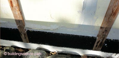

Guess what? No bees. Say what? Yup, no bees in the air gap behind the siding. After 15 years absolutely no bees, wasps, or critters of any kind anywhere behind the siding. For years, decades actually, I have been hearing the argument that vented cladding systems are prone to insect infestation. And for years, decades actually, I have not been finding that to be the case. Here is the caveat: don’t leave the air gap completely open at the bottom or at the top. Check out Photograph 9. I used a polypropylene mesh at the bottom of the assembly to allow airflow and drainage but to block insects. I also used an aluminum “C-Section” to seal the bottom cantilevered portion of my exterior foam insulation to keep squirrels and chipmunks and other animals from getting into the foam. No insect damage (except for the ants discussed earlier), and no critter damage have occurred after 15 years.
Photograph 9: Insect Mesh—Polypropylene mesh acting as an insect barrier is installed between the furring strips at the bottom of the wall. This particular mesh typically is used in attic ridge vents to keep bugs out of roofs.

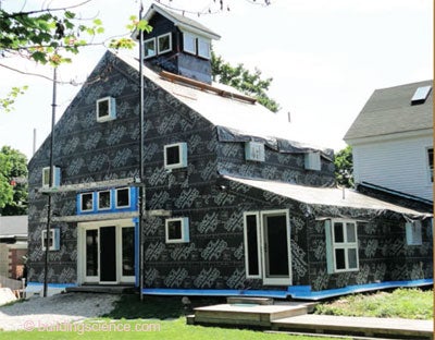

The plywood sheathing was then wrapped with a fully adhered peel and stick membrane (Photograph 12). This layer acts as a water control layer, an air control layer and a vapor control layer. Note the control layer continuity between the roof assembly and the wall assembly. Reverse laps in the membrane were taped with sheathing tape.
Photograph 12: Control Layers—An even more beautiful sight: a fully adhered membrane acting as a water control layer, air control layer and a vapor control layer. Reverse laps are taped with sheathing tape. No more poly for me.

How did it turn out when all was said and done? Check out Photograph 15. New shingles. Lots of new insulation. Lots of shear.7 No three-dimensional airflow networks. Not quite the plantation house of Charlton Heston and Eleanor Parker—but it will do—the Marabunta be damned.
Photograph 15: Done—Looks almost normal. R-65 roof and an R-52 wall more or less. And tight. How tight? Pick an outrageous phrase. The actual numbers are for another column. Check out the two round holes where the heat recovery ventilator (HRV) intake and exhaust goes. The extreme tightness leads to some interesting problems with exhaust fans and extreme pressures that require some nifty solutions. Later babe.
