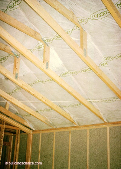

The “flow through” approach is limited to hot dry climates such as Las Vegas and Phoenix. The roof cladding needs to be “back-vented” and the roof sheathing and roofing membrane need to be vapor open. The most typical manifestation of this is a tile roof over batten strips over a roofing felt over plywood or OSB sheathing (Figure 5). Any moisture that accumulates on the underside of the roof sheathing (the “first” condensing surface) is able to pass through (“flow through”) the sheathing and the roofing felt into the air gap under the tile roof and be vented away. New materials allow the roofing felt to be replaced with a vapor permeable fully adhered membrane or a semi vapor permeable taped OSB sheathing6. The most common insulation is netted cellulose (Photograph 1) although spray applied fiberglass, netted fiberglass and fiberglass batts are options.
Figure 5: “Flow Through” Roof
—This approach is limited to hot dry climates such as Las Vegas and Phoenix. The roof cladding needs to be “back-vented” and the roof sheathing and roofing membrane need to be vapor open. The most typical manifestation of this is a tile roof over batten strips over a roofing felt over plywood or OSB sheathing. Any moisture that accumulates on the underside of the roof sheathing (the “first” condensing surface) is able to pass through (“flow through”) the sheathing and the roofing felt into the air gap under the tile roof and be vented away. New materials allow the roofing felt to be replaced with a vapor permeable fully adhered membrane or a semi vapor permeable taped OSB sheathing.
Photograph 1: Flow-Through Assembly
—The most common insulation is netted cellulose although spray applied fiberglass, netted fiberglass and fiberglass batts are options.

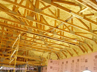

You can use closed-cell in all climate zones. You cannot use open-cell in IECC climate zones 5 or higher unless the foam is used with a Class II (or Class I) vapor retarder. The reason should be fairly obvious. With open-cell foam (Photograph 2) a significant amount of moisture via vapor diffusion will pass upwards through it during cool periods and during the winter in cold climates–too much to be driven back down during sunny weather and during the summer. Additionally, with open-cell foam the attic space it encloses must be conditioned to remove moisture (see “BSI-077: Cool Hand Luke Meets Attics”).
Photograph 2: Open-cell Spray Polyurethane Foam (SPF)—
You cannot use open-cell in IECC climate zones 5 or higher unless the foam is used with a Class II (or Class I) vapor retarder. With open-cell foam a significant amount of moisture via vapor diffusion will pass upwards through it during cool periods and during the winter in cold climates–too much to be driven back down during sunny weather and during the summer. Additionally, with open-cell foam the attic space it encloses must be conditioned to remove moisture.

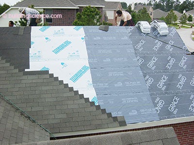

Back in the day some of us were worried about inward vapor drive through shingles into the roof deck in hot-humid climates. With an unvented assembly underneath there was some concern about the durability of the roof deck. The first code change in 2000 called for a vapor impermeable underlayment to control this inward drive. At the time we had no idea how big the inward drive could be. We looked at it over a couple of years in test structures in hot-humid climates (Photograph 3). It turned out not to be large enough to worry about and so in subsequent code revisions the requirement for a vapor impermeable underlayment was taken out. But some folks never forget. They keep citing it as a code requirement. Stop it already. Inward drive is not an issue.
Photograph 3: Test House in Houston, TX
—Back in the day some of us were worried about inward vapor drive through shingles into the roof deck in hot-humid climates. With an unvented assembly underneath there was some concern about the durability of the roof deck. At the time we had no idea how big the inward drive could be. We looked at it over a couple of years in test structures in hot-humid climates. It turned out not to be large enough to worry about.

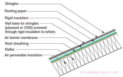

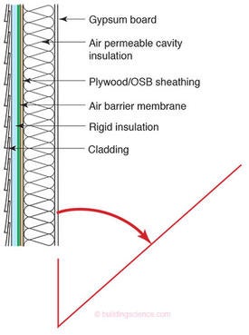

Finally, let’s take a run at the “adding the insulation to both the topside and the underside of the roof deck” approach. The most common way to do this is to use “air permeable” insulation on the underside of the roof deck and rigid insulation on the top of the roof deck. One way to explain this approach is that it is the roofing version of a wall with insulating sheathing on the outside of it. Take a wood frame wall with insulating sheathing and slope it (Figure 6). As in a wall the insulation on the top of the roof sheathing controls the temperature of the condensing surface. The amount of insulation necessary to do this depends on the climate zone and the amount of insulation applied to the underside of the roof deck (Figure 7).
Figure 6: Slope The Wall
—The roofing version of a wall with insulating sheathing on the outside of it. Take a wood frame wall with insulating sheathing and slope it.
Figure 7: Insulation on Both Topside and Underside
—The most common way to do this is to use “air permeable” insulation on the underside of the roof deck and rigid insulation on the top of the roof deck. As in a wall the insulation on the top of the roof sheathing controls the temperature of the condensing surface. The amount of insulation necessary to do this depends on the climate zone and the amount of insulation applied to the underside of the roof deck.

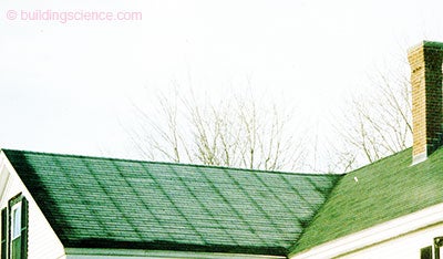

Photograph 4: Thermal Bridging
—Guess whose house that was? Yup. It was mine. I am not as smart as I think I am most of the time. At the time this photograph was taken the underside of the roof was insulated with closed-cell spray polyurethane foam (SPF).
