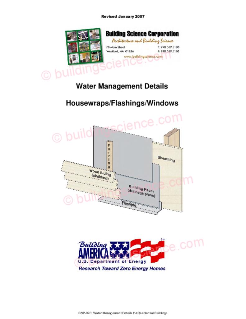

An integral part of many water management systems is the use of building paper or housewraps as the drainage plane in the wall system. The basic concepts with these products are that they should always be installed in a shingle lap fashion and have enough space to drain moisture down and out to the exterior. With house wraps, the joints are often also taped to provide increased protection from water entry and to increase the air tightness of the assembly. With no other factors to consider, following these basic ideas should result in long-term performance of the material. While the concept is simple, certain construction methods and details have interfered with the performance of the house wraps and building papers.
Figure 1: Shingle lap of drainage plane material

For all sidings (except vinyl) it is recommended that they be installed over some form of drainage matt or furring strips in order deal with the problems of water retention and potential surfactant contamination. This spaces the siding off of the housewrap to prevent surfactant contamination, increases drainage, and often increases drying by ventilation as well. Furring strips are a more traditional method of moving the siding off of the back up wall construction, however from past experience both methods have been very successful at managing the moisture problems with board sidings and housewraps.
Figure 5: Drainage matt installed behind wood shingle
