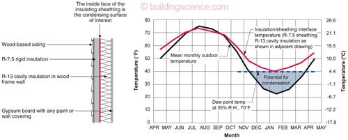

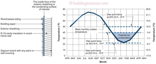

This type of simple analysis can be conducted on a monthly basis and plotted to help visualize the condensation risk. An example of a wood-framed wall in the Chicago climate is shown in Figure 2.
Figure 2
: A monthly analysis of the condensation potential of two walls in the Chicago climate
Adding more air-permeable insulation to the stud bay (e.g., if a 6” stud is required structurally, a well-intentioned contractor may fill the stud cavity with an R-20 batt) will of course lower the safety against condensation—dangerously in this case. Adding significantly more insulation to the exterior (going from R-7.5 to R-15 for example), will significantly reduce risk. Regardless of the wall assembly, exterior climate and indoor humidity, the same trends will always hold: adding insulation value to the exterior decreases condensation risk, adding air-permeable insulation value to the stud space increases the risk of condensation.

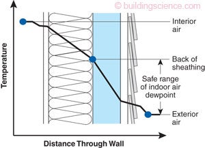

Consider the two steel stud framed wall designs shown in Figure 3 during a period of cold weather. Applying R-10 (RSI 1.76) of insulating sheathing (continuous insulation of any type) on the exterior of the framing will result in a sheathing temperature of above 60 °F (15 °C) everywhere within the stud space, including at the sheathing, during a night when the outdoor temperature drops to 4 °F (-15 °C). Hence, condensation is practically impossible within the stud space or on the sheathing (typically one of the moisture sensitive components in the assembly). This is true even if air leakage occurs, as all the surfaces are above the dew point temperature of the interior air.2 If R-19 (RSI3.5) insulation is placed between the framing, the sheathing temperature will be approximately 10°F (-12 °C), well below the temperature at which condensation can occur. The latter design relies on perfect air barriers (air impermeable spray foams are one solution) to avoid air leakage condensation. If the cavity fill is highly vapour permeable (e.g., fiberglass, rockwool, or open cell, half-pound density foam), a vapour control layer (Class II) is also necessary to reliably manage vapor diffusion.
Figure 3:
 Insulating sheathing as condensation control measure. Continuous exterior insulation on the left, framing cavity insulation on the right. The red line plots the temperature through the two assemblies on a 4°F (-15°C) night. Blue line shows back side of sheathing temperature.
The design with all of its heat flow control as a continuous layer of insulation on the exterior can perform very well even if air leakage occurs, and requires no special care in the selection of interior layers for vapour control. It should also be recalled that the wall with only exterior insulation would have an overall R-value of around R-12 (RSI2.1), whereas the wall with framing cavity insulation would have an overall R-value of between R-6 to R-8 (RSI 1.1 to 1.4) (depending on floor and wall framing intersection details and the type of cladding).
