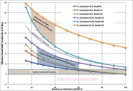

You want to save serious energy and serious money? Easy, use less glass. Windows and curtain walls are the most expensive component in a building and provide the worst energy performance. The more you use the more energy and money you burn. Limit the glazing area to approximately 30 percent—and use really good glass and frames (Figure 1).
Figure 1: Enclosure R-value versus Glazing Ratio Bottom line is use less glass and use good glass and frames. Chart is courtesy of John Straube (6). Bad glass ruins good walls. Rock beats scissors, paper beats rock… The impact of thermal bridging through commercial wall assemblies, and heat flow through window systems can be calculated with relatively good accuracy by calculating an area-weighted average of the R-values of the windows and opaque wall sections. The equation takes the form: Uoverall = (WWR *Uwindow + (1-WWR) * Uwall), where U = 1/R. The results of a number of scenarios are plotted in the chart below. Typical curtainwall systems have an R-value of only 2 or 3, with "high performance" systems (not shown) using highly insulated spandrel panels and best-in-class double glazing may achieve R-4. Only a few systems, such as the Kawneer 7550 series, can achieve R-values of 6 or more.
Curve 1 above is for standard U=0.50 thermally-broken aluminum punched windows with air-filled double-glazed insulated glazing units in a R-12 batt-filled steel-stud brick veneer wall system (R-6). The overall effective R-value of this wall is around 3-to-4 over the normal range of window-to-wall (WWR) ratios of 25 to 50%. Curve 2 shows that Increasing the R-value of the wall to R-11 by adding an inch of foam on the exterior, results in an increase of only R-0.5 to R-1.5 for the overall R-value for the same range of WWR. Curve 3 shows how significant an impact window performance can make if a good wall is provided. An externally insulated R-16 wall, when mated with poor windows produces a vertical enclosure with an R-value of only R-3 to R-6 for the normal range of window area. Curve 4 assumes a good quality window frame with top quality glazing (low-e, argon-filled): the result for the overall vertical enclosure is still only R-4 to R-7. These first four curves cover the performance of a wide range of commercial enclosures with a wide range of cladding types. The conclusion is that modern commercial vertical enclosures actually have an R-value that is rarely over 7, and more likely in the range of 3-to-5! Curves 5 and 6 provide an idea of the significant improvements that are possible. Using best-in-class thermally broken aluminum frames and high-performance glazing (U=0.30), Curve 5 shows that even with an R-40 wall, the overall R-value will be in the 7-to-12 range for WWR of less than 40% (the highest ratio recommended for high-performance buildings). Even though this is a low-level, it is still about significantly more than the alternative. The grey curve below Curve 5 shows the slight benefit gained by increasing wall R-value from 20-to-40, particularly at high glazing ratios. Curve 6 employs low-e, argon-filled triple-glazed units in an insulated fiberglass frame, to deliver a U-value of only 0.14. Even with a wall insulated to "just" R-20, such a combination can deliver an overall R-value of 12-14, two to three times more than typical commercial vertical enclosures. In all cases, it can be seen that high glazing ratios generate enclosure walls that are expensive to purchase with very high heat loss and heat gain. This high ratio should be avoided in both individual spaces, such as meeting rooms, as for the whole building on average. |

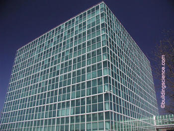

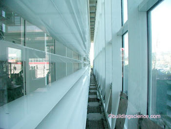

Double façades? Green? What’s with that? I thought we killed that dumb idea after all the nonsense associated with “double envelope” houses in the 1970’s.2 It seems that really dumb ideas keep coming back every other generation—typically after the generation of adults that dealt with the dumb idea the first time around retires (Photograph 1 and Photograph 2).
Photograph 1: Hooker Chemical Company—The folks that brought us the Love Canal also brought us the first double façade building in the United States in the 1970’s.
Photograph 2: Mind the Gap—More Hooker Chemical Company building double façade. Not a heck of lot more needs to be said here. The population of a small village could live in this space.
Here is the general premise behind the double façade. The outer façade creates a buffer space between it and the inner façade tempering the environment the inner façade sees. So we have to build two walls—not one—an outer wall and an inner wall with a bunch of space in between. Seems to me that if you built the inner wall correctly you don’t need the outer wall—and vice versa. We call that a “duh” where I’m from. And then you get to use the space between them because there is no space between them—it is all inside—we call that rentable floor area where I’m from. Double façades are a low energy way to provide an all glass enclosure, but they always use more energy than a decent façade with less than 100 percent glass. Why ever go there?
Oh, I forgot about all the passive ventilation “magic” that happens between the two facades and the operable windows you can have between the inner façade and the “magic” space. All brought to you with the precision and predictability of computational fluid dynamics (CFD) and the stack effect. Emswiler (2) and Hutcheon (3) are rolling over in their graves and Shaw and Tamura (4) are none too pleased. I call on the ghosts of building science past to rise up and put a pox on all your houses.
I have got news for all you façadists—you can have operable windows in a single façade and you can get a lot more control and predictability with things called fans, ductwork and controls. Oh, by the way, you can get it at a lot less cost, using a lot less materials (i.e. “resource efficiency”) and using a lot less energy. But, but, fans use energy—it’s not natural to use fans. The other way, the “magic” way uses “natural” forces that are good because nature is good and man is inherently evil. Didn’t we have this argument over two hundred plus years ago with a dead French guy called Rousseau? If we taught architects more physics and less philosophy they wouldn’t fall for this garbage—and while I’m at it shame on you engineers for using bad physics to deceive gullible architects.

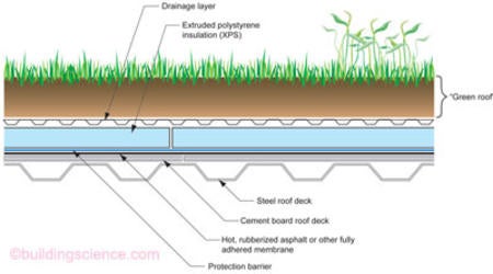

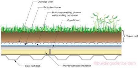

Green roofs? Grass and dirt are not energy efficient. Work with me here. Which saves more energy—2 inches of dirt or 2 inches of insulation? Which saves more energy—grass or a white colored membrane? Which is more expensive and does not save energy— grass and dirt or insulation and a white colored membrane? Which needs to be watered to keep the grass from dying and blowing away? But they are beautiful and look cool. And that apparently is more important than cost and energy savings. Okay, I can live with the beautiful and looking cool argument if that is in fact the argument—but don’t clutter it with half-truths such as heat island effects and water run-off. There are other ways to deal with each.
I know I will not win the argument on green roofs, so my advice is to at least build the green roofs correctly. In the “green world” folks sometimes get so pre-occupied with “green materials” that they forget that at the end of the day the assembly still has to work (Figure 2 and Figure 3).
Figure 2: Bad Green Roof—The insulation is under the membrane. This is bad. The insulation can collapse and loose support for the membrane. The membrane can tear and leak. The reason for this bad design choice is often a preoccupation with the "greenness" of the blowing agent of the rigid insulation. Successful green roofs have historically used extruded polystyrene (XPS). XPS can get wet and still perform. The blowing agent of XPS is arguably not the "greenest of the green." Uproven "green" blowing agents used with polyisocyanurate insulation seem attractive at first blush, but insulation assemblies need to be protected from water and hence the location under the membrane and the structural loading of the overbuild assembly needs to be taken into account.
Figure 3: Good Green Roof—The insulation is over the top of the membrane. This is good. This configuration has a multi-decade track record.
