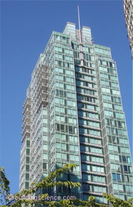

Photo 02
Photograph 2:
Almost the entire façade of this condominium tower is covered with low R-value and high solar gain curtainwall. It is almost impossible to achieve a low energy, comfortable building with this approach.
