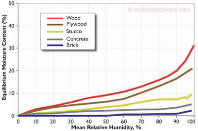

Figure 1: Sorption Curve for Common Building Materials—Note that moisture content goes up as relative humidity goes up. There is no temperature dependence or vapor pressure dependence except where temperature affects relative humidity or where vapor pressure affects relative humidity.
Quick, snap quiz, psychrometric chart stuff….as the temperature drops, and vapor pressure is kept constant, what happens to the relative humidity? Buzz/Clang/Bell. Yes, folks, you are correct, the relative humidity goes up. The implications are staggering. Just making things on the outside of your building cold, hygroscopic things, makes them wetter. Period, end of story. But, but, the moisture content of the outside air in the wintertime is low. Yes, grasshopper, it is, but its’ relative humidity is high. The amount of moisture in the absolute sense is low, but in the relative sense it is high. And hygroscopic materials don’t care about the absolute sense; they only care about the relative sense. Why? Second Law stuff—isn’t it always?

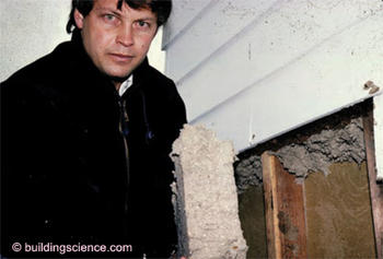

Photograph 2: Retrofit Cellulose Cavity Insulation—Dry blown cellulose packed into exterior wood frame walls. Injected from the exterior at top of cavity. This author, very young at the time, amazed at how well the insulation worked. Cavities were dry when opened.

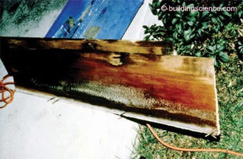

Photograph 3: Wet Cladding—Problems with mold and decay were worse on north and east elevations. Problems with peeling paint were worse on west and south elevations. Solar radiation cycled the cladding moisture content more on the west and south elevations stressing the paint. UV cross-linked the paint making it less flexible. Less flexibility, more movement on the south and the west led to the peeling paint. Less energy on the north and the east led to the mold and the decay.

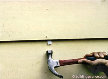

Photograph 4: Wedgie—So simple and so obvious. After the problem is understood. Wedges created gaps that reduced capillary uptake of surface water, promoted drainage and back ventilation.

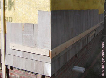

Photograph 5: Drainage and Ventilation Matt Behind Cladding—This is easy for new construction and re-cladding. Existing buildings are going to be a problem. Don’t say you weren’t warned.
