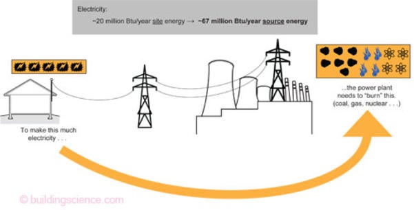

If you add up all the energy (Btus) you are consuming at the meter, this is what is known as “site” energy. However, this is not the full picture. The problem is that the process of generating electricity incurs substantial losses—enough that for every unit of electricity at the plug, it might have been necessary to “burn” about 3 times that amount of energy (coal, gas, nuclear, etc.) at the power plant—see Figure 1.
Figure 1: Source energy from power plant to electric service entrance
Although transmission losses are a part of this inefficiency, they are rather modest—roughly 10%. Transmission losses are what causes the hum of high-voltage electrical lines, and are the reason why the millions of transformers in the grid are air cooled. These losses can be reduced by better technology and will be reduced in the future by distributed power generation (i.e., the “Smart Grid”), especially if power is generated reasonably close to where it is used (e.g. in the same community for example).
In general, it can be said that “the grid” is “~30% efficient”: with the majority of the losses occurring at the plant. To be specific: the power plant cooling towers that are dumping steam (i.e., waste heat) into the sky are where most of that missing 2/3 is going.

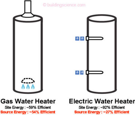

A Household Example
Converting to source energy has a major effect on electricity (factor of 3), and has a small effect for fossil fuels like natural gas. So what difference does this make? Here is an example:
- A typical gas tank water heater has an efficiency level (energy factor or EF) of 0.59, or 59%.
- In comparison, a typical electric tank water heater has an EF of 0.92 or 92%.
So in terms of site energy, the electric tank has an efficiency level about 1.5 times better than that of gas tank. But if you factor in source energy:
- The same gas tank has a “source efficiency” of roughly 54%
- The same electric tank has a “source efficiency” of roughly 27%
Figure 2: Site-Source Comparison for Domestic Water Heating
So the electric tank is half as efficient, in terms of source energy and, loosely, environmental impact. Obviously, if one doesn’t account for source vs. site differences, there are some pretty serious distortions when comparing electric heating with gas heating.

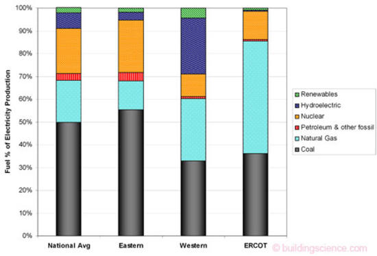

Based on the 2004 EIA data cited by Deru and Torcellini, the fuel mix for the US average and these three grids is shown below (Figure 4). It is clear that the US grid is largely powered by fossil fuels (71% on average), and 50% by highly polluting coal plants. In comparison, only 2% of the grid is powered by renewable energy, which includes renewable fuels, geothermal, wind, and solar (PV).
Figure 4: Electricity generation fuel mix for the continental United States (national) and three interconnections, for 2004 (EIA 2006) (via Deru and Torcellini 2007)
Of course, over time, the fraction of renewable energy is expected to increase, making the grid “greener.” With the retirement of old coal, the addition of wind, high efficiency gas, biomass, tidal, or even nuclear, the carbon intensity of producing electricity will drop, and the source-site ratio will drop. Perhaps the largest change will be as a result of millions of buildings feeding energy into the grid from PV arrays or co-generation facilities, since these have a source-site ratio of nearly one.
