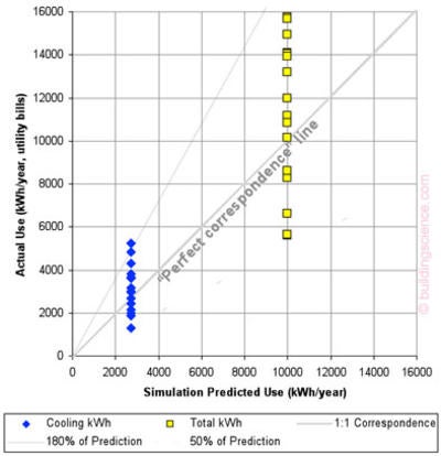

Figure 1 shows an example of the variability is seen in real houses: it plots the annual electric usage of 17 identical houses in Oklahoma, all by the same builder from the same time period. It plots simulation values against actual values—perfect correspondence would be on the diagonal line. Instead, we saw a range from 50% of the prediction to 180% of the prediction.
Figure 1: Simulation (horizontal) vs. actual (vertical) electric use for 17 identical houses in Oklahoma
These problems start to explain how you end up with disappointing situations where the building on paper (i.e., simulation) was “rated better than the standard,” while it only achieved middling performance when the energy use was actually measured (see BSI-007: “Prioritizing Green—It's the Energy Stupid”).

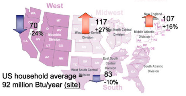

On the residential side, one commonly cited figure is the energy use per household: the US average is 92 million Btu/year. Note that this is stated in terms of site energy. This (and the following calculations) comes from the Department of Energy/Energy Information Administration’s (DOE/EIA) Annual Energy Review. Digging a little deeper, you can also find the averages broken down by census region, as shown on the map below (Figure 3), which shows usage million Btu/year per household, and how it compares with the US average (±%).
Figure 3: Site Energy: regional per household energy use (million Btu/year)
Clearly, the Northeast and Midwest have a higher per household site energy use, due to their higher heating loads. In addition, the West has lower site energy use—it has a milder climate, overall, than the other regions (especially when weighted by population location).

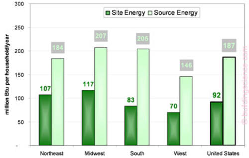

The numbers from the previous two figures (site and source per household use) are plotted in the bar graph below.
Figure 5: Site and Source Energy per household (million Btu/year): regional and US averages

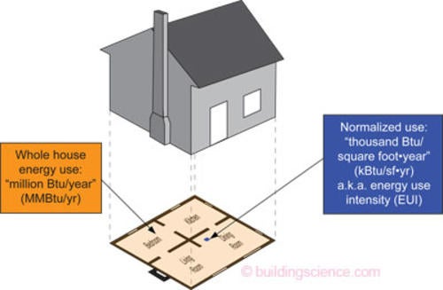

The way the size problem is addressed is by dividing the energy use by the square footage. This is probably the most common energy metric out there: it is known as “energy use intensity” (EUI). It breaks down energy use (either source or site) by square foot of floor area; the common forms are kBtu/sf·year, and kWh/m2·year. It is used, for instance, by Architecture 2030’s 2030 Challenge, and the Passive House program, when they are defining their targets.
The 2030 Challenge also deals with the “usage type” question very well—they provide EUI targets for a wide variety of types of buildings. Similarly, the EPA ENERGY STAR Portfolio Manager (also online) compares an entered building with a database of similar buildings (based on usage type). That database is the Commercial Building Energy Consumption Survey (CBECS) (also from the EIA), which includes building characteristics and energy use from thousands of buildings across the United States.
Calculating EUI from energy bills and comparing it to values for similar buildings is a very useful comparison, because it looks at real numbers, as opposed to models vs. models, or models vs. reality.
Figure 6: Household energy use vs. EUI (million Btu/year vs. kBtu/sf·year)

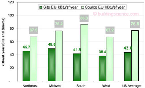

Figure 7 graphs site and source EUIs for single family houses, from Architecture 2030 data. It is broken down by Census Region, and includes the US average.
Figure 7: Site and Source Energy Use Intensity (EUI, in kBtu/sf·year): regional and US averages for single family houses. Source: Architecture 2030

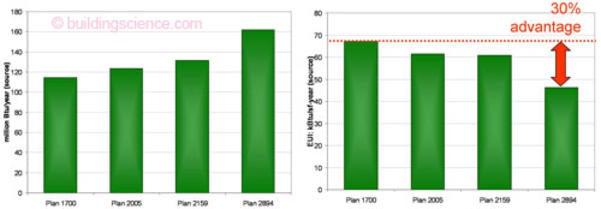

Small House Penalty: Another problem is that EUI—just by how it is calculated—puts smaller houses at a disadvantage. This problem has also been demonstrated for the HERS system (Prahl 2000), and is true for the older version of the Building America Benchmark. Figure 8 shows the results of a set of building energy simulations, comparing household use vs. EUI.
Figure 8: Square footage effects on household consumption (million Btu/year, left), and energy use intensity (kBtu/sf·year, right)
The four houses have square footage ranging from 1700 sf to 2894 sf, and the following characteristics
identical enclosure (shell) insulation values and air leakage rates
identical mechanical systems
similar operating schedules
all modeled in the same climate
Household use increases with house size, as would be expected (left hand graph). But EUI decreases with increasing house size (right hand graph), despite all other characteristics being identical. This is such an effect that the largest house has a 30% EUI advantage over the smallest, despite the houses having the same characteristics.

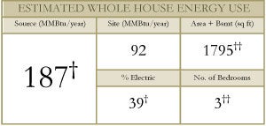

The number of household members would be calculated based on floor plans; a typical method uses the number of bedrooms plus one (#BRs + 1). However, US Census data provides information on the number of bedrooms and the number of occupants; which indicates that only 26% of US households had over 1 person per bedroom. The majority of the surveyed households (73%) have less than 1 occupant per bedroom. Therefore, a more reasonable calculation might be one person per bedroom.
Note that this metric would tend to reward small houses, as opposed to penalizing them.
