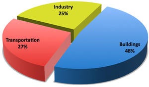

Reducing the operational energy use and increasing durability should be the prime concerns of architects who wish to design and build “green” buildings. I have reached this conclusion after spending years looking at actual building energy consumption, reviewing countless computer simulations, and being involved in numerous green building charrettes. It has even been suggested (Lstiburek, 2008) that 80% of a green architect's concern should be directed towards reducing energy consumption during operation.
Figure 1: US Building Energy Use (from architecture2030.org)

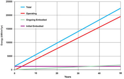

Scientific life-cycle energy analyses have repeatedly found that the energy used in the operation and maintenance of buildings dwarf the so-called “embodied” energy of the materials. Cole and Kernan (1996) and Reepe and Blanchard (1998) for example found that the energy of operation was between 83 to 94% of the 50-year life cycle energy use (Figure 2).
Figure 2: Embodied energy is swamped by operational energy in almost all building types (based on Cole & Kernan, Bldg & Environ, 1996)

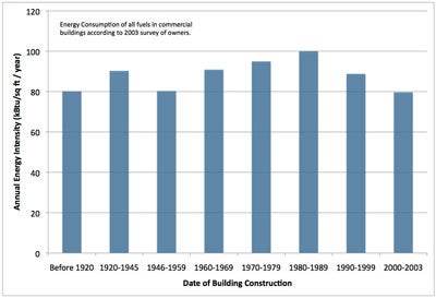

The trend in the last decades has not been encouraging. According to the Department of Energy’s Commercial 2003 Building Energy Consumption Survey, the energy consumption is not less than buildings built before 2003 (Figure 3). A New Buildings Institute study has shown that LEED buildings use essentially the same amount of energy. The real savings from improved window technology, more efficient equipment, and better design tools have disguised the fact that we are wasting more energy because of over-ventilated, over-glazed, and under-insulated buildings.
Figure 3: Actual Measured Energy Consumption versus Year Constructed for US Commercial Buildings (data from DOE Energy Information Agency CBECS 2003 Survey)
