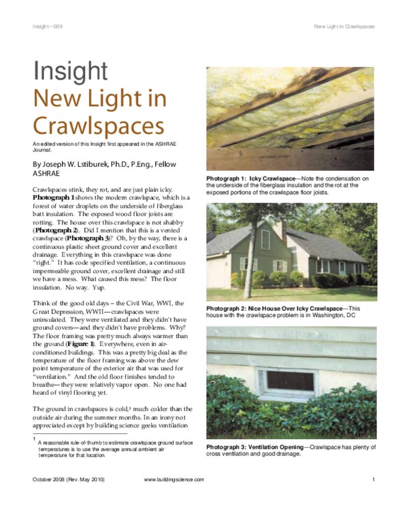

Crawlspaces stink, they rot, and are just plain icky. Photograph 1 shows the modern crawlspace, which is a forest of water droplets on the underside of fiberglass batt insulation. The exposed wood floor joists are rotting. The house over this crawlspace is not shabby (Photograph 2). Did I mention that this is a vented crawlspace (Photograph 3)? Oh, by the way, there is a continuous plastic sheet ground cover and excellent drainage. Everything in this crawlspace was done “right.” It has code specified ventilation, a continuous impermeable ground cover, excellent drainage and still we have a mess. What caused this mess? The floor insulation. No way. Yup.
Photo_01
Photograph 1:  Icky Crawlspace
—Note the condensation on the underside of the fiberglass insulation and the rot at the exposed portions of the crawlspace floor joists.
Photo_02
Photograph 2: Nice House Over Icky Crawlspace
—This house with the crawlspace problem is in Washington, DC
Photograph 3: Ventilation Opening
—Crawlspace has plenty of cross ventilation and good drainage.
