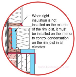

Crawlspace walls should be insulated with non-water sensitive insulation that prevents interior air from contacting cold basement surfaces—the concrete structural elements and the rim joist framing. Allowing interior air (that is usually full of moisture, especially in the humid summer months) to touch cold surfaces will cause condensation and wetting, rather than the desired drying. The structural elements of below grade walls are cold (concrete is in direct contact with the ground)—especially when insulated on the interior. Of particular concern are rim joist areas—which are cold not only during the summer but also during the winter. This is why it is important that interior insulation assemblies be constructed as airtight as possible.

- Rim joist assembly must be insulated with air impermeable insulation or insulated on the exterior

Interior Rim Joist
- Air barrier needed to protect the rim joist from interior moisture-laden air in summer and winter
- Seams in rigid insulation and joints to other materials sealed to provide air barrier
