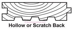

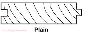

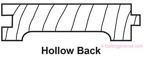

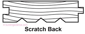

Over the top of this felt covered bitumen layer (or two bitumen layers) wood sleepers and wood plank flooring was installed. It worked fabulously. Old guys also got very clever at machining the backside of the wood flooring so that it would not warp due to differential drying between the top and bottom surfaces during seasonal moisture content changes (Figure 2a, 2b, 2c and 2d).
Figure 2a, Figure 2b, Figure 2c and Figure 2d: Clever Stuff—The backside of wood flooring was machined so that it would not warp due to differential drying between the top and bottom surfaces during seasonal moisture content changes.
The only improvement over a century was to replace the wood sleepers with plywood (Photograph 1) that was covered with a slip surface to keep the wood flooring from squeaking as it changed moisture content seasonally.

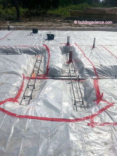

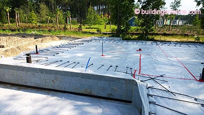

So how do you separate the concrete from the ground underneath? Well you have to first understand that concrete slab foundations have a bottom and sides. Most people forget the sides. The sides are a really, really big deal. We plant things on the sides of buildings. We water the things that we plant on the sides of buildings. The ground is very wet on the sides of buildings.
Figure 3: Monolithic Slab—A continuous polyethylene vapor barrier and capillary break needs to wrap the entire concrete surface that contacts the ground – especially the perimeter. It is also a good idea to paint the exposed edge of the slab above grade to keep it from getting wet from “splash back” (rainwater hitting the ground and bouncing back up) and enthusiastic over irrigation by occupants. The paint needs to be “liquid water” closed and “vapor water” open – hygrophobic and vapor permeable – that would be typical acrylic latex paint formulated for concrete substrates.
Photograph 2: Perimeter Slab Protection—The plastic vapor barrier is run over the top of the form boards and trimmed later after the form boards are stripped.
When we have a monolithic slab a continuous polyethylene vapor barrier and capillary break needs to wrap the entire concrete surface that contacts the ground—especially the perimeter (Figure 3). This means attaching a plastic “skirt” to the perimeter form boards or running the plastic over the top of the form boards (Photograph 2) and trimming the plastic later after the form boards are stripped. Both of these approaches are not common but need to be in place if you are installing water sensitive flooring like wood on a concrete slab foundation. Without the slab edge protection water can wick dozens of feet inward via capillarity (Figure 4) and then you end up with flooring problems such as discoloration, movement and decay (Photograph 3).

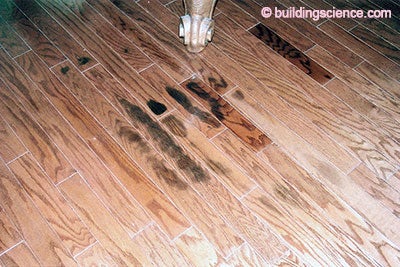

Figure 4: Capillary Wicking—Without the slab edge protection water can wick dozens of feet inward via capillarity.
Photograph 3: Wood Flooring Problems—Discoloration, movement and decay.
It is also a good idea to paint the exposed edge of the slab above grade to keep it from getting wet from “splash back” (rainwater hitting the ground and bouncing back up) and enthusiastic over irrigation by occupants. The paint needs to be “liquid water” closed and “vapor water” open—hygrophobic and vapor permeable—that would be typical acrylic latex paint formulated for concrete substrates.

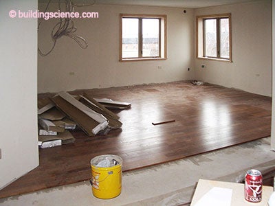

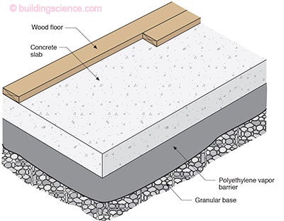

So lets say we separate the concrete from the ground—both from underneath and from the sides. Now what? We need dry concrete. What’s the big deal? Just wait for the concrete to dry before you install the wood flooring (Figure 6 and Photograph 5). Problem with this strategy is that with “wet” concrete mixes this might mean many, many months. In new construction we might only have 90 days between placing the concrete and installing the flooring. To make this timeline work we need concrete without much water in it. We need low water-to-cement ratio concrete. The good news is that to make good concrete you need a low w/c ratio. The lower the w/c ratio the better the concrete. Period.
Figure 6: Separate the Concrete from the Ground—This needs to be done from underneath and from the sides. We also need dry concrete. We need low water-to-cement ratio concrete or we need to wait for the concrete to dry before we install flooring.
Photograph 5: Glue Down Wood Floor—A decade old and still going strong. Amazing what works if the concrete is dry when the wood goes down and stays dry over time.
How low do you need to go? A w/c ratio below 0.6 for sure3. How do I know that? Well, one of the secret numbers that old time concrete masters know but don’t share with the riff raff is that “bleed water” typically disappears when the w/c ratio is less than 0.6. Now this is not a hard and fast rule. Mixing, fines, aggregate types all factor in—but it is a pretty reasonable “rule”. Without bleed water you can easily place concrete on plastic vapor barriers or on fluted metal decks and not mess up you finishing by having water separate from the mix and float to the top surface and pond. One of the dirty secrets to finishing crappy concrete was to place it on a sand layer so that the sand layer would act like blotter paper and suck up the bleed water.4
Unfortunately, most residential concrete slab foundations have a w/c ratio higher than 0.6. To get to less than 0.6 you typically need a lubricant to allow you to get the concrete out of the truck and have it placed with a pump (“superplasticizer”). With a stiff mix folks always try to add water to the concrete in order to place it. And if you don’t watch them continuously the water gets added and you end up with crappy concrete with a lot of water in it. Adding what seems like a little water can do a lot of damage. With the superplasticizer there is no incentive to add water and you get the stiff mix (low w/c ratio) you need.

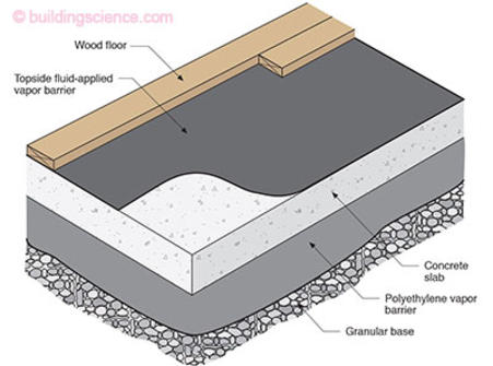

So what do you do if you don’t have a low w/c concrete and you don’t have time? And even worse, what do you do if you don’t have an effective vapor barrier and capillary break? Well, you go back to the old way of doing things. You install a topside vapor barrier. But you do it smart with new materials.
The smart way is a fluid applied vapor barrier (Figure 7). Epoxies work well. The dumb way is to use a plastic sheet.
Figure 7: What if Your Slab is Wet? —If you don’t have a low w/c concrete and you don’t have time and if you don’t have an effective vapor barrier and capillary break you need to install a topside vapor barrier. A fluid applied vapor barrier such as epoxy work well. The dumb way is to use a plastic sheet. Don’t use a plastic sheet.

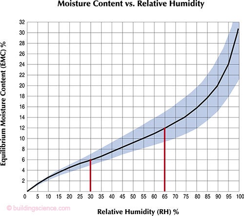

Are we done yet? Nope. Wood likes to move and no power in the universe will stop it from moving. It moves with relative humidity changes, as it is a hygroscopic material (Figure 9). In most places the interior winter relative humidity is low (typically 30 percent) and high during the summer (typically 65 percent). That means the wood flooring is going to float between 6 percent moisture content by weight and 12 percent moisture content by weight.
Figure 9: Conditioning the Wood Flooring—Wood expands and contracts with relative humidity changes as it is a hygroscopic material. In most places the interior winter relative humidity is low (typically 30 percent) and high during the summer (typically 65 percent). That means the wood flooring is going to float between 6 percent moisture content by weight and 12 percent moisture content by weight - a 6 percent seasonal swing. If you install wood flooring at 6 percent it will buckle when it goes to 12 percent. If you install wood flooring at 12 percent it will shrink and leave big gaps when it goes to 6 percent. Old guys knew this and conditioned wood to the mid range moisture content it would see during service. For most of the lower 48 states that would be 9 percent moisture content by weight.
Using “Joe math” that is a 6 percent seasonal swing. If you install wood flooring at 6 percent it will buckle when it goes to 12 percent. If you install wood flooring at 12 percent it will shrink and leave big gaps when it goes to 6 percent. Old guys knew this and conditioned wood to the mid range moisture content it would see during service. For most of the lower 48 states that would be 9 percent moisture content by weight. Most people have forgotten about this—so the folks who make wood flooring typically precondition the wood to 9 percent before they ship it and cross their fingers. Flooring manufacturers also like narrower planks as that results in more joints that can accommodate more movement. Unfortunately, the trend is to wider planks as they are currently “in style”. And don’t forget to leave gaps at the perimeter of rooms. Did I mention that wood likes to move—even “waswood”?
