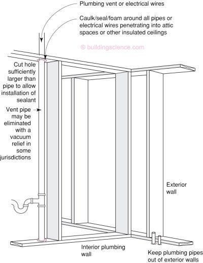

Vertical plumbing runs are typically sealed at the floor plane or bottom plate for floors over unconditioned space or over a separate dwelling unit. While holes to accommodate pipes, conduits and wires represent potential breaches in the air barrier, serious lapses can result from utility chases. Utility chases must be draftstopped wherever these intersect an intended air barrier plane. In colder climates this is also an important freeze-protection measure. Diagrams below illustrate measures to draftstop the utility chase.

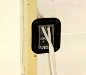

Electric boxes can be made air tight by caulking or sealing all openings in the box (including around wire penetrations) and by sealing the face of the box to the drywall. Specially designed airtight electric boxes with flexible boot seals at wire penetrations and a gasketed flange at the face can also provide air barrier continuity.

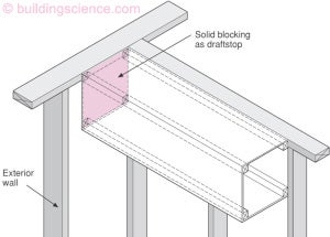

Interior soffits that are not constructed entirely inside of the air barrier may result in lapses in the air barrier if not treated properly. In terms of air barrier performance, such soffits are similar to utility chases: they must be thoroughly draftstopped wherever these intersect an intended air barrier plane.

Air Sealing at Vertical Plumbing Penetrations
- Plumbing penetrations through the floor plane are sealed either to the subfloor or to the bottom plate.
- Penetrations through the top plate must also be sealed if the top plate is in the plane of an intended air, smoke or fire separation

Draftstop of Utility Chase at Exterior Wall or Demising Wall
- Solid draftstop material sealed to framing to isolate utility chase cavity

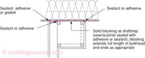

Inerior Soffit at Ceiling Air Barrier
- Solid draftstop material is sealed to framing and surrounding air barrier material.
- Alternatively, the soffit may be constructed after the sealing gypsum board is installed and sealed
