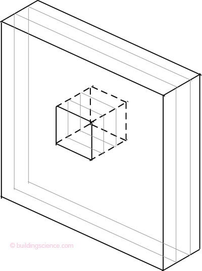

The above reasoning can be made more rigorous by applying simple mathematical rules. Consider the enclosure assembly element shown in Figure 1. This n-layer wall system can be discretised into smaller sub-elements, each chosen to be sufficiently small so that the drainage, storage and transmission characteristics are constant over the element.
Figure 1: Discretisation of enclosure into sub-elements and layers

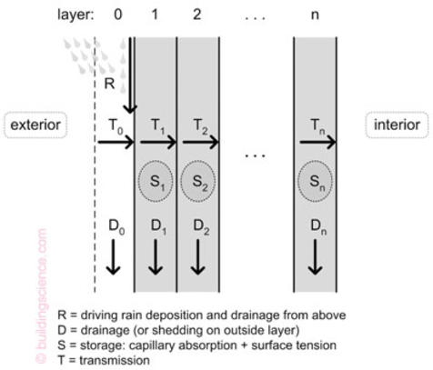

At each layer i, the water from the previous layer, i-1, must be either stored (Si), drained (Di) or transmitted to the next layer (Ti) (Figure 2). Since the sub-element under consideration is one-dimensional, drainage is considered as water that leaves the assembly. In a 2-D (height and layers) or 3-D (height, width, layers) analysis, drainage (Di,x,y) may subsequently become stored (Si,x,y) or transmitted water (Ti,x,y) in an adjoining sub-element.
Figure 2: Distribution of rain within a multi-layer enclosure assembly
From observation of Figure 2 and conservation of mass:
   (Eq. 1)
for any given period of time, ranging from a few seconds to an entire rain event. This constant relationship will henceforth be termed the DST ratio for brevity. R is the amount of surface water from both rain deposition and drainage from above. C is the amount of water that splashes back or is removed from the surface by features such as drips, ledges, etc.

Since the total amount of rainwater that reaches an interior enclosure layer (Ti-1) acts as if rain were being deposited on that layer, then for any given layer:
Di + Si + Ti = Ti-1 for all layers i = 1 to n    (Eq. 4)
It is useful to generalise values for each layer by providing fractions of rainwater. Since Di + Si + Ti =Ti-1 , then
 = 1.0 or,    (Eq. 5)
di + si + ti = 1.0      (Eq. 6)
where lower case letters denote rainwater fractions, e.g. di = Di / Ti-1

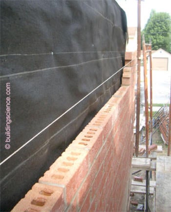

Rain Control Strategies
Three design strategies are used to control rain penetration through building enclosures. It has been shown above that the behavior of an enclosure system may change with time, rainfall intensity, temperature, etc. However, a designer must chose a strategy so that s/he can design and specify a system, and typically this means the system must be designed for the worst likely rain scenario. In some cases this “worst case” is an intense short-duration rainstorm. In other cases, the worst case may be a series of long-duration moderately intense storms.
The design options that are available to designers are discussed in the context of the relative fractions of rainwater dealt with by each mechanism at each wall layer. Regardless of the control strategy, the amount of water drained from the surface is D0 and the amount that penetrates the outer surface of the envelope is T0. Bear in mind that R denotes the volume of rainwater deposited on the surface and/or drained from above and C the amount of previously deposited water removed.

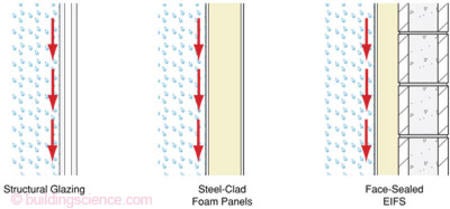

Face-Sealed (Barrier Wall) / Perfect Barrier System
A multi-layer enclosure assembly may contain a single layer where the amount of rainwater transmitted inward must be zero, i.e., at one layer, j:
Tj = tj = 0,   j ≤ k,     (Eq. 7)
The general term "perfect barrier" system (or “barrier wall”) is preferred.1 If the perfect barrier is located at the exterior-most face of the wall, the rain control strategy is termed "face-sealed." Although the perfectly watertight layer j is often located on the exterior face of an assembly, e.g., for a face-sealed EIFS cladding, j=1 and t1=0, it need not be so. If the perfect barrier is located within the assembly the term “concealed barrier” (and occasionally “protected membrane”) has been coined. Concealed barriers have the advantage that they are exposed to less UV radiation, fewer aesthetic restrictions in material choice, small temperature variations, and less moisture loading.
Since the transmission characteristics of most perfect barrier layers (such as asphaltic and polymeric membranes) is almost always moisture content independent in practical systems, the rain control performance of a perfect barrier system is independent of previous weather conditions. However, in the case of a building paper concealed barrier behind stucco, the perforations by fasteners, and the moisture sensitive nature of the material, means failures can often occur under prolonged and high exposure to rain.
Figure 3: Perfect Barrier Walls
Concealed or protected barrier systems (i.e., perfect barriers with j greater than 1) must also provide drainage or storage for layers n j. For example, although inverted roofs are classed as perfect barrier systems, they must still provide drainage. They do not rely on drainage for good rain control, merely to reduce structural loads and enhance their durability and fault tolerance.
Figure 4: Metal-cladding is being placed over a concealed barrier (a waterproof fully-adhered “self-sealing” membrane) to form the rain control system of this sloped roof.
In the special but common case of a face-sealed perfect barrier, j = 1, and the following characteristics apply:
T1 = t1 = 0   (Eq. 8)
and so,
D0 = R - C    (Eq. 9)
i.e., all driving rain deposition and surface drainage from above must be drained on the surface. Drainage and storage within the assembly therefore do not play a role in providing rain control in functional face-sealed perfect barrier systems.

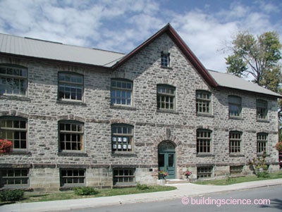

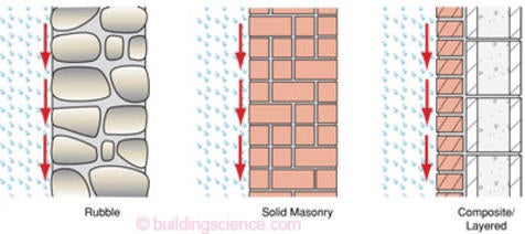

Storage or Mass System
The oldest rain control strategy is to provide an assembly with enough storage mass to absorb all rainwater that is not drained or otherwise removed from the outer surface. By draining or absorbing all rainwater, such an assembly can prevent inward transmission, i.e.,
     (Eq. 10)
Although enclosures employing this strategy might be termed "moisture storage", or “reservoir” systems, "mass" is often used because a large quantity of material is usually required to provide sufficient storage. Unlike perfect barrier or drained systems the maximum quantity of rain that can be controlled is limited by the storage capacity available. Therefore, the performance of mass systems is highly dependent on weather conditions, e.g. if a series of rain events occurs and drying conditions are poor, the storage capacity may be exceeded and failure to control rain will result. Also, unlike perfect barrier or screened drained systems (see next), mass systems do not need to use drainage within the assembly.
Figure 5:
Storage Wall Systems
The storage capacity of the system is not the only characteristic in such a system that is important in rain control. The water transmission of the various layers and interfaces can play a critical role. For example, consider a 400-mm thick, solid brick masonry wall with a certain amount of storage capacity. By applying a thin 15-mm thick, polymer-modified cement rendering, the storage capacity is only marginally increased, but the liquid water transmission of this outer layer is so low, even if cracked or otherwise imperfect, that the rain penetration control of the system is vastly improved.
Figure 6: This old enclosure controls rain penetration by storing moisture in many layers of masonry. Note that overhang and window details shed rain off the surface, thereby reducing the amount of rainwater that needs to be stored between wetting events.
Hence, any treatment that reduces surface water absorption while not reducing the water storage capacity of a wall will increase the ability for the assembly to control rain. However, if water is not absorbed at the surface it will increase the frequency and duration of a film of flowing water on the surface of the enclosure. This in turn will increase the importance of controlling surface drainage and also increase the likelihood of rain penetration through flaws, cracks, and other openings, intentional or not, in the enclosure.
The drying potential of a mass wall relative to the frequency and quantity of rain deposition is also important. Hence, when historic masonry buildings are retrofit, care must be taken not to decrease the drying capacity without an associated decrease in wetting or rain control may suddenly cease to be acceptable (see also BSD-114: Interior Insulation Retrofits of Load-Bearing Masonry Walls In Cold Climates).
Therefore, the rain control of mass systems will be dependent on the moisture storage provided relative to the liquid water transmission through the exterior surface and the drying potential of the wall in its microclimatic exposure.

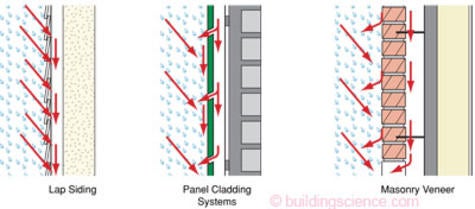

Drained Systems
Another approach to controlling rainwater is to accept that some water will penetrate the outer surface (the cladding “screens” rain) and remove this water by designing an assembly that provides drainage. This approach is labelled the “drained” or “drained-screened” approach. Drainage is required for proper function but need not be provided at one layer only. In fact, if drainage were required to be provided at one layer only, the wall would be acting as a perfect barrier system, since an enclosure in which Dj = T0 and tj = 0 for any layer j, is the definition of a perfect barrier. Screened and drained walls control rain penetration by reducing the amount of water transmitted at each of several layers, i.e.:
     (Eq. 11)
Although the dominant control mechanism is drainage, the layered and screening nature of the assembly is also important in this approach. The defining characteristics of a screened-drained wall system are that the drainage need not be complete at any one layer, transmission need not be completely controlled at any given layer, and storage is not required. The lack of required perfection at any layer is one of the most important features that has lead to the rapid acceptance of drained systems in modern enclosure design.
Because drained enclosure systems control rain penetration by reducing the successive fractions of water that are transmitted inward, the following relation can be defined:
     (Eq. 12)
Figure 7: Drained Wall Systems
Figure 8:
Drained brick veneer, employing lapped building paper as the drainage plane
The practical implications of Equation 12 can be better understood by considering an example assembly with three layers, each with a small penetration fraction, say 10%. The amount of rain penetrating the third layer would be only 0.1·0.1·0.1·(T0) = 0.001·(T0). If all rain deposited on the envelope were to penetrate the screen (T0 = R - C), the amount of water penetrating the third layer during a typical heavy rain storm (e.g., 10 l/m2/hr) would be 0.1% of 10 l/m2/hr, or 10 ml/m2/hr, the equivalent of a water film 0.01 mm thick! Therefore, providing even a small amount of storage in the third layer of this wall will ensure that rain penetration is controlled. In fact, failure to control rainwater in such walls is usually the result of a failure to drain since the required amount of drainage in this wall equals 0.999·(T1). This line of reasoning supports the "drained" part of the label applied to this type of system.

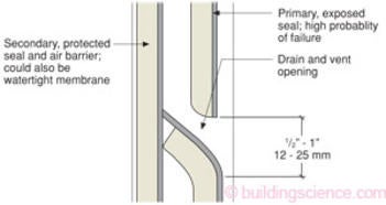

The term “rainscreen” has been rather loosely applied by practitioners and researchers to several special cases of drained walls, especially those that use several layers and several mechanisms to control rain. A rainscreen system typically contains a drainage layer as the second layer of the assembly, (i.e. d2 ≈ 1.0). The first layer (j=1) is the screen, and the second layer (j=2) is often the backside of the screen. Almost without exception, functional rain screen walls provide several additional drainage layers, for example, the front and back of the sheathing paper. Modern windows, car doors, and two-stage joints are exceptions, in that they typically have precisely two layers (hence the term two stage weather tightening). Although these types of joints provide an “almost” perfect inner layer, the intent of the outer layer is to significantly reduce the potential for any water on the second layer.
Figure 9
: A vertical section through a two-stage joint
It must be noted that the outer layer of a multi-layer drained wall is much more than a rain screen; it must also resist wind, snow, solar radiation, impact, etc.
A pressure-equalised rain screen is a very special type of screened and drained system that equalises (or moderates) air pressure differences acting on the screen to reduce the transmission fraction of the screen. Since all field measurements of pressures behind screens have shown that the pressure is rarely equalised, pressure-moderated rain screen would be a more accurate label for most practical systems. Some types of two-stage joints may also be pressure-moderated and should be labelled pressure moderated two stage joints.

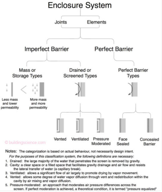

Wall Classification
An enclosure wall classification system based on the above analysis is presented in Figure 10. This system, developed over the last several years (Straube 1993, Straube and Burnett, 1997), is based on the method by which the wall system controls rain penetration. Because the control of rainwater penetration has historically been a major function of above-grade enclosure walls, the classification is widely useful. The classification is independent of materials, building function, or design intent. Although the focus of this classification is on wall systems, it can be extended to the other above-grade building enclosure systems, especially windows and roofs.
A fundamentally important point is that walls should be considered to be comprised of elements and the joints between these elements. Both the elements and joints may be classified in the same manner, but the classification of the joints in any given system may be quite different than for the element. This distinction is critical for some systems; perfect barrier elements made of modern materials rarely fail (often because they are built of high performance materials under tight quality control in factories), but the joints between the elements are a common source of problems, e.g., joints between metal or precast concrete panels, window openings in EIFS, laps of flashing, etc. Windows are commonly designed assuming that the glazing unit is a perfect barrier and that the joints must be drained.
The primary and initial classification of this system is whether a wall is a perfect barrier or an imperfect barrier.
Perfect barriers stop all water penetration at a single plane, as much as a perfect air barrier would prevent airflow. Examples of perfect barrier walls are some window frames, EIFS, and metal and glass curtain wall systems. Because it is very difficult to build and maintain a perfect barrier wall, most walls are designed as, or perform as, imperfect barrier wall systems of either the mass type or the screened type.
Mass or storage systems control rain penetration by absorbing and storing rainwater which penetrates the exterior surface. In a functional mass wall this moisture is eventually removed by evaporative drying before it reaches the inner surface of the wall. Some examples of mass walls include adobe, solid brick masonry, and single-wythe block masonry. Poorly drained masonry cavity walls (i.e., those with blocked air spaces or blocked weep holes) often behave as multi-layer mass walls.
Figure 10:
 Wall classification with regard to rain penetration control
Screened and drained walls control rain penetration by draining any water that is not shed from the front face. Such walls are also imperfect-barrier type wall systems in that this approach acknowledges that some rainwater will penetrate the outer surface. A supplementary mechanism, such as a capillary break, storage, and multiple drainage planes are usually employed to resist further inward movement of the water that penetrates the screen. The dashed lines in the figure indicate that, while not desirable, poorly drained walls do exist. Some examples of drained wall systems include cavity walls, brick and stone veneer, vinyl siding, two-stage joints, and drained EIFS.
Although the above is all that is necessary to classify a design, the multiple and important roles of air spaces and cavities means that further practical classifications are possible.
