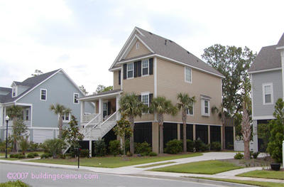

The obvious point is to build up – as high as possible and practical. In coastal regions such as Charleston, SC and Florida’s panhandle the first level in new buildings is typically used for parking, storage and building access. Utilities, services and equipment are also elevated (Photograph 1 and Photograph 2). This should be the fundamental basis for construction in high flood risk areas. Farther inland, elevated crawlspaces and pier foundations can be constructed (Figure 1 and Figure 2). Slabs should be avoided. If and when slabs are constructed they should be constructed as raised slabs (Photograph 3 and Figure 3).
Photograph 1: New Home – Charleston, SC. First level used for parking, storage and building access.

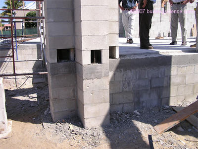

Figure 3: New Home Under Construction – Ft. Myers, FL. Note the elevated slab relative to the surrounding grade and the non-water sensitive structure (masonry wall).

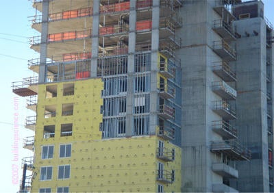

Additionally, we should build out of non-water sensitive materials. Again FEMA has it right [8] and [9]. Recent work has demonstrated the efficacy of constructing assemblies from water resistant materials [10]. Once again, not surprisingly, Florida leads the way. Most commercial buildings in Florida are constructed from masonry and concrete (Photograph 4).
Photograph 4: Commercial Office Under Construction in Orlando, FL—The basic structure is constructed from completely non-water sensitive materials – the building has ‘good bones.'

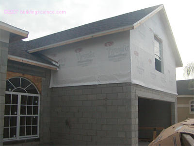

Also in Florida, in a modern adaptation of the medieval practice of rustication residential buildings are typically constructed from masonry on the first level and wood frame on the second level (Photograph 5; see also Figure 3). In medieval times the lower level was constructed stronger to resist the marauding rabble, in modern times (in Florida) the lower level is constructed to resist the marauding water.
Photograph 5: Residential Rustication in Florida—The first level is masonry and the second level is wood frame.

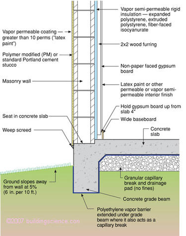

In commercial and residential masonry mass wall assemblies non-water sensitive semi-vapor permeable rigid foam insulation should be installed on the interior (Figure 5 and Photograph 7).
Figure 5: Masonry Mass Wall—Assembly insulated with non-water sensitive semi vapor permeable rigid foam – interior cavity designed to be opened after moisture event and ventilated.

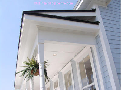

On exterior surfaces, wood and wood based cladding and trim materials should be avoided (Photograph 8). Fibercement and plastic composite materials should be used for exterior cladding and trim. All exterior cladding and trim should be “back vented.’ If wood trim and cladding is used (“grudgingly”) it should be coated on all six sides prior to installation to reduce water absorption.
Photograph 8: Look Ma, No Wood—Non-water sensitive plastic and fiber cement exterior trim and cladding elements installed over a ventilated exterior air space (i.e. cladding is ‘back-vented’).

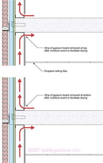

Nothing dries like airflow - especially when no power is available. Cavities should be designed to be ventilated. Interior cavities should not contain absorptive insulation – or any insulation for that matter. The interior cavities should be designed to allow vent openings to be easily provided at the top and bottom to provide ventilation airflow.
The materials themselves should be vapor open in addition to being non-water sensitive to facilitate drying by diffusion.
The “caveat” to consider is that interior vented cavities have fire consequences. Cavities should be “sealed and compartmentalized” under normal service conditions and only “opened” after a moisture event to facilitate drying.
