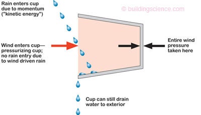

Let’s make it a bit more complicated. Let’s add wind (Figure 2). Wind enters the cup and pressurizes it. If the wind can’t get out the back of the cup (assume the cup has no holes) no more wind can enter into the front of the cup. Presto–no wind entry into the cup therefore no wind driven rain entry into the cup. That pesky momentum thing is still happening with the raindrops, but no matter we drain those suckers back to the outside as before. There’s that drainage thing again.
Figure 2: Cup in the Wind—Wind pressurizes cup so that wind driven rain cannot enter. Rain still enters cup due to momentum but this rainwater drains back to exterior. Note the drainage thing.

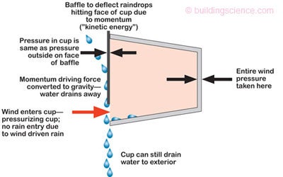

Now, let’s add a baffle to the front of the cup (Figure 3). We don’t want to completely cover the cup opening—we will leave the baffle a little short so that the bottom of the cup remains open. This opening at the bottom of the cup still allows the cup to drain. Remember drainage is good. We will keep coming back to that. The opening at the bottom of the cup still allows the wind to enter the cup and pressurize it. But think what the baffle does? It intercepts the momentum driven raindrops and keeps most of them from entering the cup. It gets better. There is little pressure drop across the baffle; the majority of the air pressure drop is across the back of the cup.
Figure 3: Cup with Baffle—Wind still pressurizes cup so that wind driven rain cannot enter. Baffle reduces rainwater entry due to momentum. Drainage back to exterior makes everything work.
This is the magic part—apart from the holes and the drainage. Even though I might have holes in the baffle, not much rain will be sucked through those holes because there is little air pressure drop across the baffle since the cup is pressurized. We call this concept “pressure moderation.”2

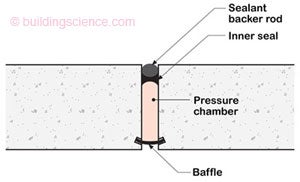

We can apply the principle to joints in precast panels (Figure 7 and Figure 8). With precast systems we call this approach “two-stage joints” rather than pressure moderation because the concrete folks have always been better and more descriptive in naming their stuff than the glazing geeks. Fewer geeks in concrete beget better language in concrete. Also, the biggest benefit is the drainage rather than the pressure moderation. We take everything we can get, but if we can only get one thing we take the drainage.
Figure 7: Precast Panel—Two-stage joint has vent holes that facilitate drainage.
Figure 8: Baffled Two-Stage Joint—Baffle handles momentum; inner seal drains water to exterior.

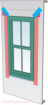

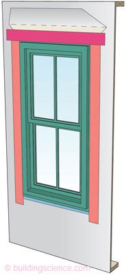

Figures 10a through 10h—Note that bottom of window is unsealed on exterior to permit drainage to exterior. Window drains into a pan flashing that is drained to the exterior. Air seal is on interior perimeter (continuous around 4 sides) to provide pressure moderation of air cavity surrounding window inboard of exterior perimeter flashing tape and outboard of interior perimeter air seal.
Figure 10a | Figure 10b | Figure 10c
Wood frame wall with housewrap and sheathing | Modified "I" cut in housewrap | Housewrap folded in at jambs and sill; housewrap folded up at head, backdam installed
Figure 10d | Figure 10e
Formable flashing installed | Window installed plumb, level and square
Figure 10f | Figure 10g | Figure 10h
Jamb flashing tape installed | Head flashing tape installed | Housewrap folded down at head and corners taped; inner seal installed around perimeter
