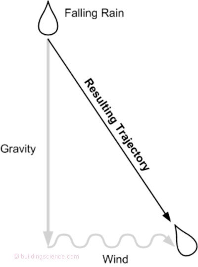

Driving Rain
Driving rain is defined as the quantity of rain that passes through a vertical plane in the atmosphere. Driving rain occurs because raindrops which are falling to the ground at their terminal velocity are blown sideways at the speed of the wind at any given height above grade (Figure 1).
Figure 1
The amount of driving rain in unobstructed wind flow can be calculated with reasonable accuracy. The speed at which raindrops fall is a function of the size of the drop. Essentially, as the drop size increases the rain drop terminal speed increases at a decreasing rate. The wind carries the drops along horizontally due to drag. The combination of gravity and wind forces determines the trajectory of the drop, and simple geometry can then be used to assess the amount of rain passing through a vertical plane. Complicating this assessment is the fact that there is a range of raindrop sizes in any rainstorm. Research by various meteorologists can be used to correlate the distribution of drop sizes in a rainstorm with the intensity of the rainfall.
Subsequent theoretical work and a considerable amount of field measurement [Straube 1998] has allowed us to extend and generalize Equation 3 to

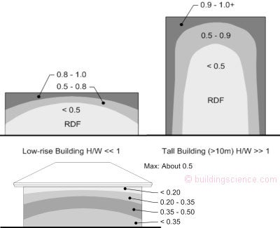

Building Shape
Building shape and overhang effects can be accommodated through the use of different Rain Deposition Factors (RDF).
The RDF is a function of the building's shape, aerodynamics, the wind's angle of attack, raindrop diameter, and wind speed. In general, since most rain events are of low intensity and have a similar distribution of raindrop sizes, average values of RDF measured in the field over a range of driving rain events have shown somewhat consistent results (Straube 1998) and have been shown to be capable of predicting a special case on a 15 minute basis (Straube 1997). It is interesting to note that recent computer modeling backed by field measurements (Blocken and Carmeliet 2004) have recently provided strong evidence that a single RDF factor independent of rainfall intensity is a reasonable approximation over a broad range of rainfall intensities. Again, this conclusion would need to be confirmed in hurricane regions because of their different pattern of rain and wind. The most important dependencies are with the building shape and aerodynamics, and hence these are investigated below.
Other than Straube (1997, 1998) and Schwarz (1973) the literature contains few references of simultaneous measurements of driving rain in the environment and the driving-rain deposition on a building. However, when results from the literature of field measurements (Schwarz 1973, Frank 1973, Sandin 1988, Flori 1992, Henriques 1992, Kuenzel 1994, Straube 1998, Blocken and Carmeliet 2000), wind tunnel tests (Inculet 1994), and computer modeling (Choi 1994, Karagiozis et al 1997, Blocken and Carmeliet 2000) are evaluated in terms of calculated RDF there is a reasonable agreement of results. Until the results of further research are available, the RDF values given in Figure 2 (compiled from the references listed) are recommended. An RDF of 1.0 appears to be appropriate near the upper corners of blunt-edged, rectangular buildings. Over small areas with unusual or complex geometries (eg. notches in the elevation of a building), much higher RDF values may be more realistic. An RDF of much less than one is likely over most areas of most buildings, but the upper corners of high rise buildings could have limited areas of much greater than one.
Figure 2: Rain deposition factor (RDF)

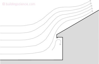

Peaked roofs and overhangs redirect airflow up and over the building at a distance further from the facade (Figure 3) and can thereby have a significant effect on rain deposition (regardless of the building size). This has been shown at the one-storey UW Beghut (Straube 1998), unpublished measurements conducted for MEWS (on a 4 storey apartment) and in wind tunnel studies of a high-rise apartment building (Inculet and Surry 1995). For example, adding a 1.5 m wide canopy to a multi-storey building will result in a lower RDF value and can, in theory, be an effective and economical means of improving rain control. Similarly, a peaked roof not only leaks less than a low-slope roof, it may also reduce the amount of driving rain on walls by deflecting the wind (Straube 1998).
Figure 3: Influence of overhangs on wind around buildings
It is clear from Equation 7 that rain deposition will increase directly with wind speed. Hence, building facades exposed to high wind speeds are also exposed to higher levels of driving rain. Equation 7 is only accurate if the wind speed at the height of interest is applied and the influence of terrain and site features are accounted for in the velocity used. Weather data files almost always provide the unobstructed wind speed at 10 m (33 ft) above grade. Wind speeds increase with height above grade and are accelerated close to the ground on hilltops, and will be higher in exposed conditions (open country) than for buildings protected by other houses, trees or by hills. To correct for height, the type of upwind terrain roughness, and sharp terrain features, such as hills and escarpments, the wind speed, used in driving rain calculations, must be modified.

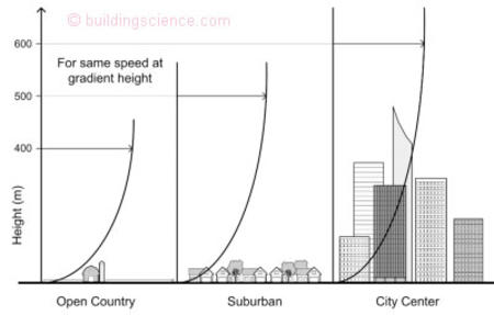

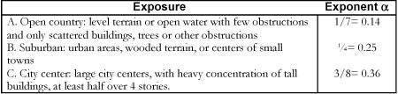

Height and Upwind Roughness
The fact that wind speed increases rather rapidly with height means that the driving rain exposure of tall buildings is much higher than for low-rise buildings. The standard approach used to correct wind speed with height is provided in ASCE 7 and the National Building Code of Canada (NBCC 1996). The wind speed at any height, V(z) can be found from:
V(z) = V10 · (z/10) α (8)
Where V10 is the standard wind speed 33 ft (10 m) above grade normally reported by weather stations (m/s),
z is the height above grade (in meters) and
α is the exposure exponent, shown in Figure 5.
Figure 4: Different upwind exposure types
Figure 5: Exponent for different upwind exposure

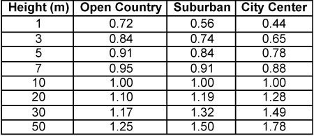

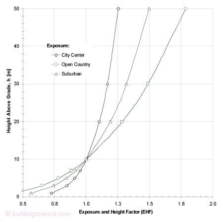

The increase in velocity with height has been calculated for the three different exposure classes and the results summarized in Figure 6 and plotted in Figure 7.
Figure 6: Wind velocity multipliers (EHF) for different heights and exposures
Recommended multiplication factors to apply to above:
Sheltered: 0.5 if buildings or obstruction of building height are within a distance equal to twice the building height
Hilltop or Cliff top: See speed-up correction factor in text
Figure 7: Correction factors for different exposures and heights (EHF)
This exposure and height factor (EHF) can be used directly to adjust the amount of driving rain predicted by Equation 7.

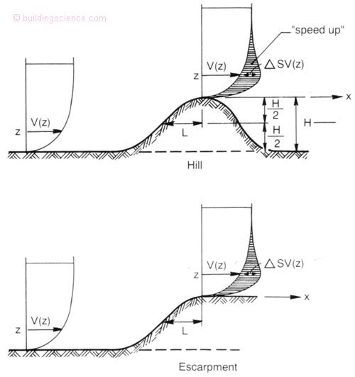

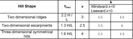

Hills and Escarpments
It is well known that wind speed increases as it is forced over hills and escarpments. The higher wind speeds result in higher driving rain deposition and higher wind pressures on buildings, and experience suggests that more rain penetration problems occur. The speed-up factor can be calculated with the aid of the NBCC as well. Figure 8. defines the variables needed to use the following equation to find the wind speed corrected for topography (NBCC 1996):
TF = {1 + ΔSmax {1 – |x| / (k · L) } e(-az / L) }½ (9)
Where TF is the topography wind speed correction factor,
H and L are topographic geometric values defined in Figure 8. (m),
x is the distance from the crest (m),
z is the height above the crest (m)
k, ΔSmax and a can be found in Figure 8.
Figure 8: Speed-up factor definitions (NBCC 1996)
Figure 9a: Parameters for topography factor calculations (NBCC 1996)

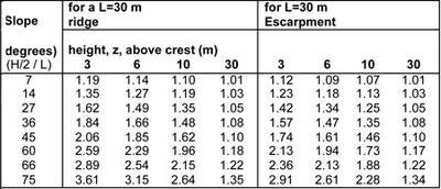

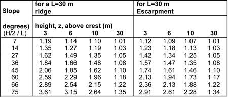

To provide a sense of the size of the TOF , an example calculation has summarized in Figure 9.
Figure 9b: Topography factor example calculations

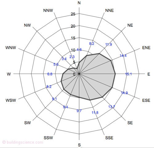

The same factors are used to find the driving rain load from the worst direction, the annual total, or other values.
Example
As an example of using the data and methods described, consider two different walls in Toronto, one facing east and one west. Inspection of the Toronto driving rain graph in Figure 10 shows a free wind driving rain quantity of 6.8 inch/yr (170 mm/yr) for the west and 15.1 inch/year (380 mm/yr) for the east. If one considers a west-facing bungalow wall 9 ft (2.7 m) above grade, sheltered by closely spaced houses in a suburb, the 6.8 inch/yr would be modifying by a factor of 0.7 (from Figure 7) and a further reduction factor of 0.5 (from the note on sheltering). If the bungalow had a peaked roof with a 12” (300 mm) overhang, an RDF of 0.5 would capture the highest likely rain deposition values. The result would be a driving rain total of 6.8*0.7*0.5*0.5= 1.2 inch/year or 30 mm per year, which is equivalent to 30 liters per m2 or 0.75 gallons/square foot per year.
For an east-facing wall on the top floor of a 50 m (175 ft) tall blunt edged (RDF=1.0) condominium in a suburban exposure, Figure 6 provides a wind speed correction factor of 1.5. Using an RDF of 1.0 for the top corners, the driving rain deposition would be predicted to be 15.1 * 1.5 * 1.0 * 1.0 = 22.6 inch/yr or 575 mm per year which is 575 l/m2/year or 14.1 gallon/f2/yr– almost 20 times as much rain as the sheltered low-rise bungalow wall facing west.
This example demonstrates the very significant influence of exposure and orientation in a specific climate. It should also be noted that the combination of high exposure and choice of building shape (high RDF) in a low driving rain climate (such as Phoenix) can result in much more rain deposition than a sheltered low rise building in a high driving rain climate (such as Seattle).
Summary
These data and methodology, although partially validated through field measurements, should be used with care and professional judgment. Many more field measurements of tall and complex building shapes are needed, as are measurements in a range of exposure conditions. Computational Fluid Dynamic approaches have been successful in intense research programs where they could be calibrated to measured data on test buildings: their accuracy and reliability are not likely any better than the simple methods presented here for the prediction of rain loads of buildings without measurements.
Figure 10: Driving Rain Rose for Toronto Canada (inch/year)
