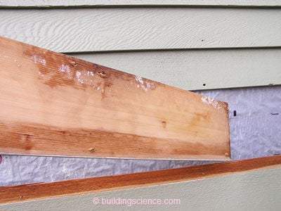

Photograph 3 - Wet Siding:
Water that used to drain and not be absorbed now passes through the field of the building paper and is absorbed. More water is now retained for a longer period of time.

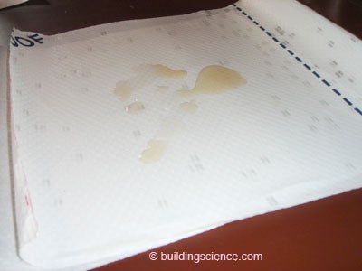

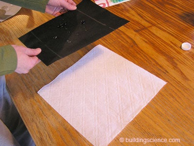

Photograph 4 - Tar Paper Test
: A teaspoon of water is placed on tar paper placed over a paper towel. Look at how the water beads up on the surface. A beautiful sight.
Photograph 5 – No Wet Spot:
If the water beads up and does not wet the paper towel – it passes Joe Test 1.

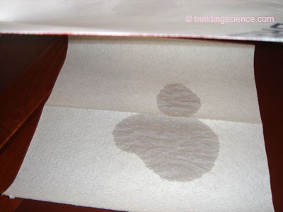

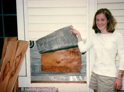

Photograph 6 – Nice House Gone Bad Stuff:
In the case of the house we were looking at, the sample product removed from the wall failed Joe Test 1. Most products pass Joe Test 1 before they are installed. But all products that fail in the field seem to fail Joe Test 1.

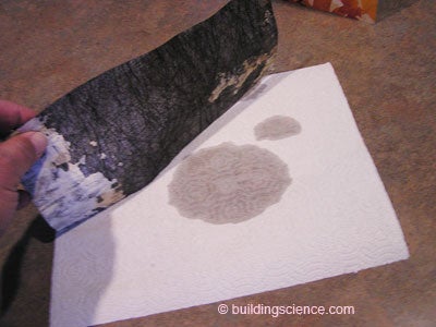

I first started doing Joe Test 1 in 1995 (Photograph 7 and Photograph 8). It was not very predictive with new materials but pretty conclusive with field failures. Weathering it seems was also important. Interesting. Needed to add to the Joe Test method. I mean once it has failed it is pretty much too late, eh?
Photograph 7 - Joe Test 1 in 1995:
It was not very predictive with new materials but pretty conclusive with field failures. That is my daughter helping me out.
Photograph 8 – Failed Material:
Weathering it seems was also important. Stuff seemed to be getting on to the stuff changing things . . .

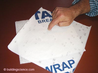

Joe Test 2 was a pretty impressive add. It was a variation on the old “tent test.” Ever been camping and in a tent when it starts to rain and some misbehaving little rat8 puts his finger against the side of the tent and it starts to leak? Photograph 9 demonstrates Joe Test 2. How long do you leave your finger in the water? Until you get bored. With me, that is about 3 minutes. Four minutes tops. Lots of perforated housewraps began to fail Joe Test 2 in the late 1990’s prior to exposure. I was definitely on to something. ASTM eat your heart out.
Photograph 9 – Tent Test:
Breaking the surface tension to wet the surface. Joe Test 2.

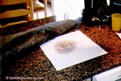

I began to notice that when I held failed housewraps up to the light they were darker in some spots than others. They would fail Joe Test 1 in the dark areas and pass Joe Test 1 in the non-dark areas. It became very obvious with lighter colored housewraps (Photograph 10). What caused the discoloration? That part was easy. Wood sugars and tannins. Water-soluble extractives. “Weak” surfactants by another name. This lead to Joe Test 3 and Joe Test 4.
Photograph 10 – Wood Sugars and Tannins:
I began to notice that when I held failed housewraps up to the light they were darker in some spots than others. They would fail Joe Test 1 in the dark stained areas and pass Joe Test 1 in the non-dark areas. It became very obvious with lighter colored housewraps. What caused the discoloration? That part was easy. Wood sugars and tannins. Water-soluble extractives. “Weak” surfactants by another name.

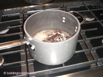

Both Joe Test 3 and Joe Test 4 involve boiling water. So this should not be done at home without adult supervision. Take a half dozen cedar chips (“mulch”) and boil in water for 30 minutes and allow to cool to room temperature (Photograph 11). Go have a beer while you wait. Then use a teaspoon to drop this weak surfactant solution on the sample (Photograph 12). This is Joe Test 3. Failure is pretty dramatic when it happens (Photograph 13). It should fail in less than 60 minutes if it is going to fail.
Photograph 11 – Boiling Water and Mulch:
This should not be done at home without adult supervision. Take a half dozen cedar chips (“mulch”) and boil in water for 30 minutes and allow to cool to room temperature.

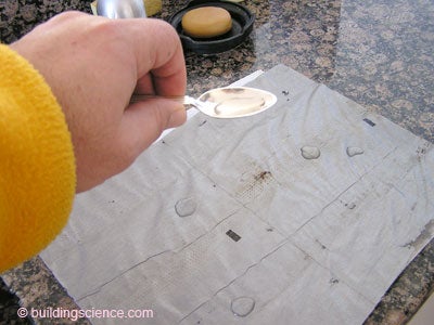

Photograph 12 – Weak Surfactant:
Use a teaspoon to drop this weak surfactant solution on the sample. This is Joe Test 3.
Photograph 13 – Wet Spot:
Failure is pretty dramatic when it happens. It should fail in less than 60 minutes if it is going to fail. The water solution just stays there for a long while and nothing happens. Then, all of a sudden, it goes through. More exciting than watching paint dry.

Joe Test One
Drop a droplet of water on a product sample placed over a paper towel. If the water beads up and does not pass through the product sample to wet the paper towel the product sample passes Joe Test 1.

Drop a droplet of water on a product sample placed over a paper towel. Put your finger in the droplet of water to break its surface tension. Leave your finger in the droplet of water pressing against the product sample for 3 to 4 minutes. If the water does not pass through the product sample to wet the paper towel the product sample passes Joe Test 2.
Joe Test Three
Take a half dozen cedar chips (“mulch”) and boil in water for 30 minutes and allow to cool to room temperature. Take a droplet of this water-soluble extractive solution and drop on a product sample placed over a paper towel. If the water does not pass through the product sample to wet the paper towel after about 60 minutes the product sample passes Joe Test 3.
