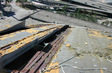

I remind everyone that the roof of the Superdome experienced one of the more spectacular failures in enclosure history. It unzipped during Katrina like a cheap prom dress on a Saturday night in less than catastrophic wind conditions (Photograph 1). Let’s toy with this memorable failure a little—just hypothetically of course because there is litigation.1
Photograph 1: Should Have Never Happened—The Superdome roof membrane is missing after Hurricane Katrina.
It is quite something when a roof blows off. To have one blow off during a national disaster with the world watching puts it into a class by itself. But the roof blow off of the Superdome is not an isolated incident. We seem to be experiencing more uplift problems with roofs lately and it begs the question why?

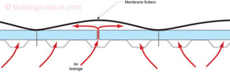

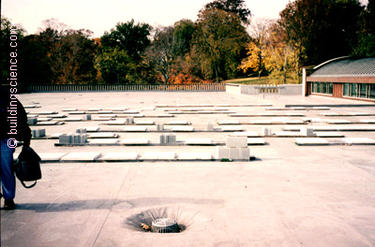

When mechanically attached membranes became common—a bad idea in my humble opinion – the lack of an air barrier lead to fluttering of membranes (Figure 2) and some interesting failures (Photograph 2) and some interesting solutions (Photograph 3).
Figure 2: Fluttering Membrane—Mechanically attached membrane flutters due to air leakage from interior when air barrier is omitted.
Photograph 2: Fluttering Membrane—No air barrier at deck leads to an idea for a Disney World ride…
Photograph 3: Fluttering Membrane Fix—“I’ll fix that darn moving membrane, Bubba get me some pavers and blocks…”
Fluttering, besides stressing the membrane, leads to the pumping transfer of airborne moisture from the interior into the roof assembly. This has typically been a cold climate phenomenon but the problems are migrating south as membranes become white rather than black. Dark membranes get very hot—duh—and the heat drives the moisture back down into the building. In the south mechanically attached dark membranes roofs typically dodged the moisture bullet because the moisture that was pumped up was driven back down by the huge temperature gradient. No harm, no foul. But that all began to change with energy conservation and light colored membranes. Many roofs no longer get hot enough to drive flutter driven moisture back down into the building. Failures that were limited to cold climates now happen in Georgia.
Air barriers make fluttering go away and make the world safe for mechanically attached light colored membranes. The fluttering is controlled since any attempt by the membrane to lift off the insulation layer is resisted by suction—air from the interior is not able to enter the roof assembly due to the presence of the air barrier. The lack of an air barrier and a leaky deck will allow replacement air to enter the roof assembly from the interior and the suction resistance is lost.

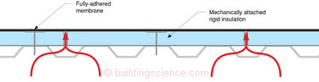

Here is a trick question_what is the tightest element of a roof? That would be the element without any holes. That would be the membrane since it can’t have holes because if it does it leaks. Duh. If I have a tight membrane, rigid insulation installed in boards/sheets with gaps over a fluted steel deck with seams and holes the majority of the wind load is taken by the membrane. That was the case in the Superdome roof (Figure 3). We know that how? Well, the membrane is gone and the insulation was left behind—double duh (Photograph 4).
Figure 3: Failed Superdome Roof Section—Mechanically attached rigid insulation boards on fluted metal deck with fully adhered membrane. Note the absence of an air barrier. Membrane takes full wind load.
Photograph 4: Superdome Roof Damage—Missing membrane and exposed rigid sheet insulation - note the mechanical connectors. The membrane was adhered to the top of the sheet insulation boards and to the mechanical connectors. Also note the metal deck and the flutes that allowed lateral airflow and lateral water migration.
With an air barrier a significant portion of the wind pressure is transferred to the air barrier and its attachment to the deck. The tighter the air barrier, the greater the load transfer. The greater the load transfer to the air barrier, the less stress on the membrane. Figure 1 rocks, Figure 3 sucks–literally–wind suction.
The Superdome roof did not have an air barrier—at least not the replacement roof installed in 2002—the one that failed during Katrina. It was reported that the smoke dampers at the top of the roof were sucked off during Katrina and that allowed the wind to enter exacerbating building pressurization and stressing the roof assembly. The membrane took the majority of the load, unzipped and traveled to a neighboring parish.

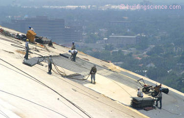

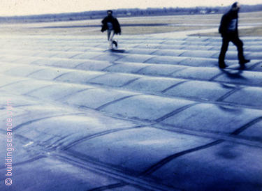

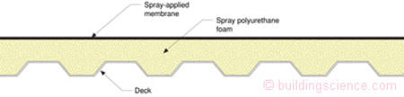

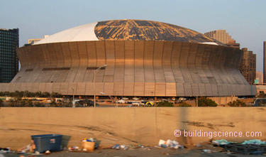

The good news is that the post Katrina repair is both bulletproof2 and has an air barrier. The new roof is similar to the original roof. It is spray polyurethane insulation system applied directly to the roof deck (Figure 4 and Photograph 5). A spray applied fully adhered membrane is installed over the top of the insulation (Photograph 6). The spray polyurethane insulation also acts as the air barrier.
Figure 4: New Superdome Roof Section—Fully adhered spray-applied membrane over fully adhered spray polyurethane foam insulation layer and integral air barrier.
Photograph 5: Spray Foam Application—New, fully adhered roof insulation and integral air barrier.

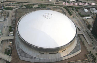

Photograph 6: Better than Before—Welcome back Saints…

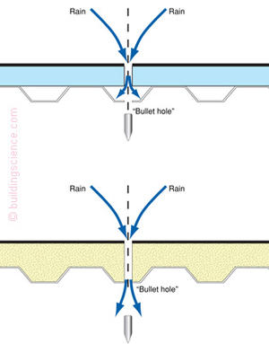

So how are bullets handled in the new roof? The bullet goes right through the roof system providing a “straight-through-the-assembly” water path. The spray foam does not allow the lateral migration of water that occurred in the 2002 roof (Figure 5). OK, so the roof isn’t really bullet proof, but bullets don’t cause anything besides a minor annoyance. The bullet holes are easy to fix—the hole and the leak are coincident – and corrosion is limited and controlled.
Figure 5: Bulletproof—Bullet holes in upper roof section allow for lateral migration of rainwater due to the gaps in the roof system layers and the channels provided by the fluted steel deck. In the lower roof section bullet holes result in a “straight-through-the assembly” flow path for water thereby limiting damage to the hole only.
