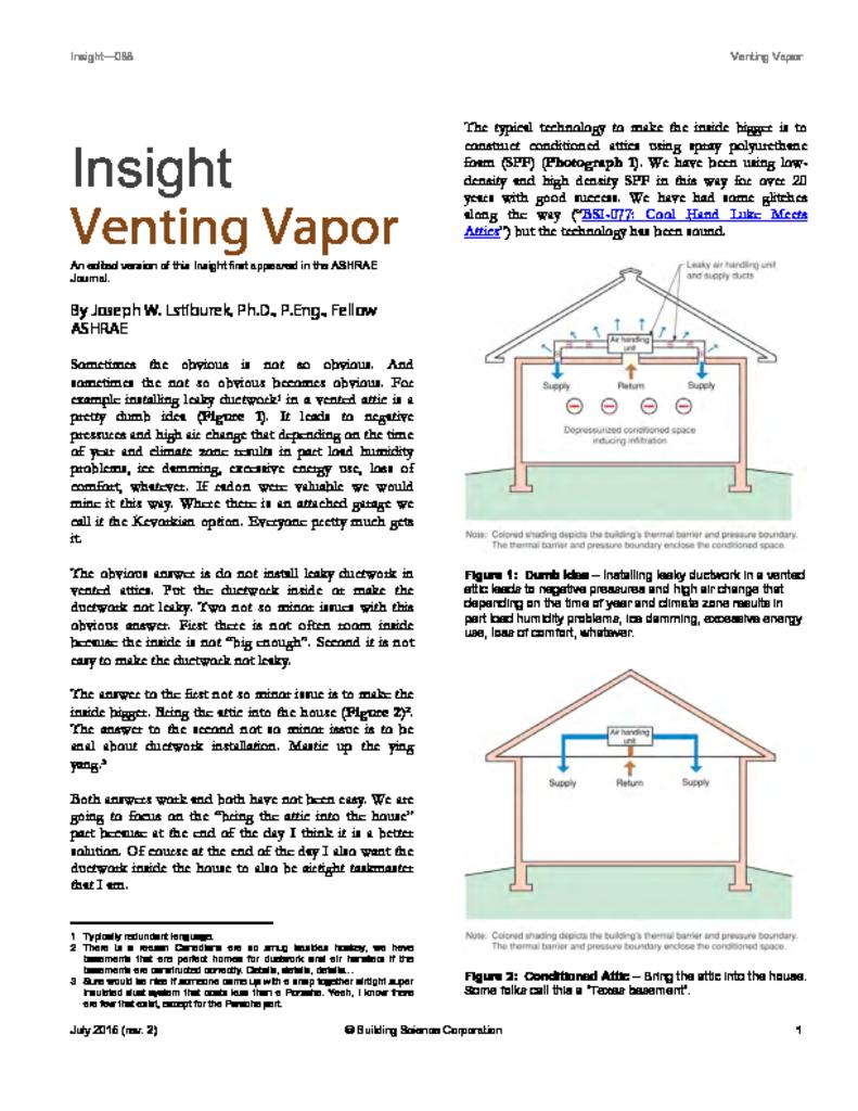

Sometimes the obvious is not so obvious. And sometimes the not so obvious becomes obvious. For example installing leaky ductwork1 in a vented attic is a pretty dumb idea (Figure 1). It leads to negative pressures and high air change that depending on the time of year and climate zone results in part load humidity problems, ice damming, excessive energy use, loss of comfort, whatever. If radon were valuable we would mine it this way. Where there is an attached garage we call it the Kevorkian option. Everyone pretty much gets it.
Figure 1: Dumb Idea
—Installing leaky ductwork in a vented attic leads to negative pressures and high air change that depending on the time of year and climate zone results in part load humidity problems, ice damming, excessive energy use, loss of comfort, whatever.
The obvious answer is do not install leaky ductwork in vented attics. Put the ductwork inside or make the ductwork not leaky. Two not so minor issues with this obvious answer. First there is not often room inside because the inside is not “big enough”. Second it is not easy to make the ductwork not leaky.
The answer to the first not so minor issue is to make the inside bigger. Bring the attic into the house (Figure 2)2. The answer to the second not so minor issue is to be anal about ductwork installation. Mastic up the ying yang.3
Figure 2: Conditioned Attic
—Bring the attic into the house. Some folks call this a “Texas basement”.
Both answers work and both have not been easy. We are going to focus on the “bring the attic into the house” part because at the end of the day I think it is a better solution. Of course at the end of the day I also want the ductwork inside the house to also be airtight taskmaster that I am.
