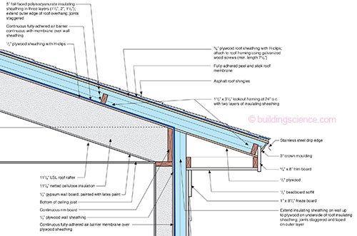

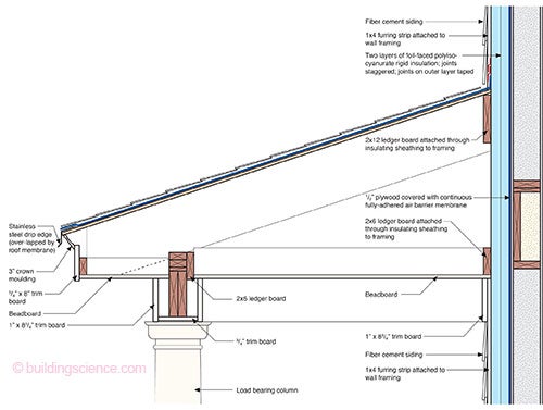

So how do you get the house to be ultra tight? And ultra insulated? We have pretty much settled on one approach because it is robust and gets us consistently tight. Real tight. Ultra tight. Tighter than even “my metric”. German tight. We like advanced frame 2x6 construction (“BSI-030: Advanced Framing”) fully sheathed with plywood or OSB and wrapped with a fully-adhered membrane. Outboard of the membrane we with go with continuous insulation. Lots of continuous insulation. And we don’t care whose. They all work.
This is laid out in Figure 1, Figure 2, Figure 3 and Figure 4. This is the “perfect wall” put into practice (“BSI-001: The Perfect Wall”). The roof is an unvented compact roof. The basement is insulated on the interior. Exterior insulation has too many problems. We will save that discussion for another day. Until then, remember that the critters and insects will probably win if you don’t listen to me.
Figure 1 – Roof Assembly: Note the continuity of the water control layer, air control layer, vapor control layer and the thermal control layer. The “lookout” framing for the overhang is embedded in the rigid insulation. You want a higher R-value roof than this? Easy. Add another layer of rigid insulation. Or two layers. Don’t like the cellulose in the cavities? Use fiberglass. Or use low density or high-density foam. Whatever.
Figure 2 – Wall Assembly: Note that the “hood” framing does not penetrate the layers of exterior continuous insulation. Further note that the roof is flashed to the exterior face of the rigid insulation. If rockwool is used then the roof would need to be flashed to the exterior face of the fully-adhered membrane. You want a higher R-value? Add another layer of continuous insulation.

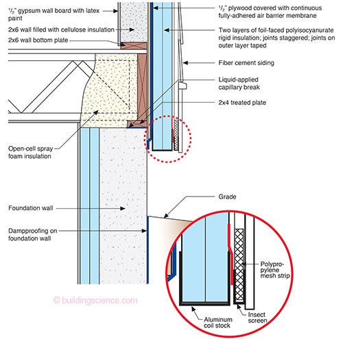

Figure 3 – Top of Foundation: Note that the fully-adhered membrane is sealed to the top of the exterior face of the concrete foundation wall. The membrane will have to be sealed with a mastic or a primer. Also note the physical protection of the bottom of the continuous insulation. This is absolutely necessary to deal with critters. Also note the insect screening.
Figure 4 – Bottom of Foundation: Note the capillary break at the top of the footing. Also, note the two “red” sealant beads. They are absolutely necessary to create an airtight seal between the basement slab and the interior of the perimeter concrete foundation wall. Also note the filter fabric under the gravel pad. Not standard, but a really good idea.

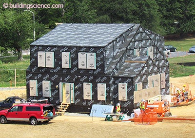

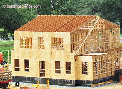

The big thing to note is that there are no “overhangs” when the sheathed structural fame is wrapped with the fully-adhered membrane (Photograph 1 and Photograph 2). The fully-adhered membrane is sealed to the exterior face of the concrete foundation. We end up with an airtight concrete box at the bottom of the house (the basement floor slab is sealed to the perimeter concrete foundation wall that is sealed to a membrane wrapped sheathed structural frame. It does not get tighter than this. In terms of airtightness, it is so simple, so straightforward, so effective even a caveman can do it. And you can have complex shapes, massing and geometries. Try that with a double wall and an architect from California.
Photograph 1 – No Overhangs: Not yet anyway. Framing is 2x6 @ 24 inch o.c, advanced framing sheathed with plywood structural sheathing. Could have been OSB
Photograph 2 – Darth Vader House: Wrapped in a back fully-adhered membrane. This membrane is the water control layer, the air control layer and the vapor control layer. It is clearly continuous. It is mastic sealed to the exterior face of the perimeter concrete foundation wall. We end up with an airtight concrete box at the bottom of the house (the basement floor slab is sealed to the perimeter concrete foundation wall that is sealed to a membrane wrapped sheathed structural frame. It does not get tighter than this. In terms of airtightness, it is so simple, so straightforward, so effective even a caveman can do it. Don’t like black? Use a blue membrane. Don’t like vapor closed? Use vapor open it does not matter. The plywood or the OSB is the vapor “throttle”.

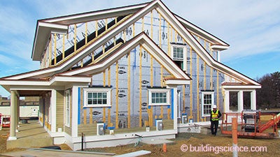

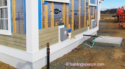

Over the 1x4 furring goes the cladding (Photograph 5) and then you are done (Photograph 6).
Photograph 5 – Cladding Attachment: Pretty straightforward. Cladding is installed over the 1x4 furring.

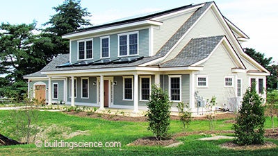

Photograph 6 – Done Deal: NIST Net Zero Energy Residential Test Facility, Gaithersburg, MD.

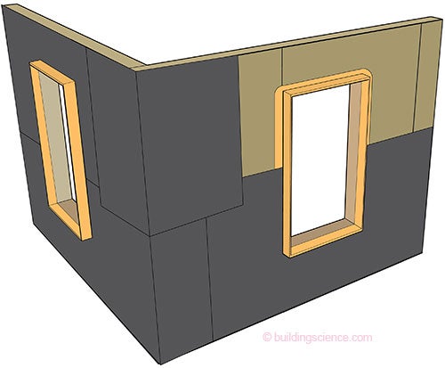

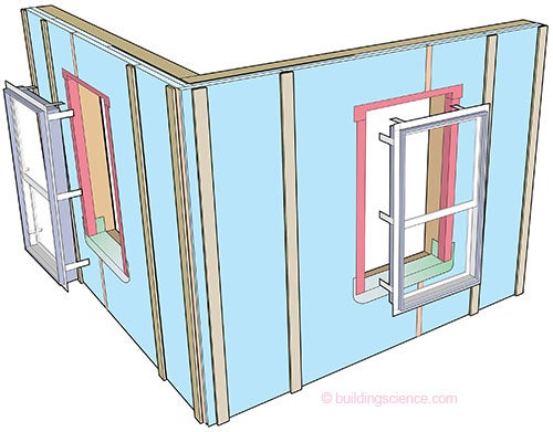

All the details remain the same. Even the windows (Figure 5 and Figure 6). One caveat here: with rockwool, you will have to use unflanged windows and a 2 stage joint since the water control layer is the fully-adhered membrane not the exterior face of the continuous insulation as is the case with isocyanurate, XPS and EPS.
Figure 5 – Window Framing: Note the plywood or OSB rough opening extension protruding past the exterior face of the sheathing. The protrusion dimension is the thickness of the continuous insulation. The opening is waterproofed with a fluid applied flashing. This detail remains the same for all of the various continuous insulation types.
Figure 6 - Window Installation: Note the mounting brackets attached to standard flanged windows. Mounting brackets for masonry openings are used. Also note the pan flashing. The window is waterproofed to the face of the exterior sheathing. This detail remains the same for all of the various continuous insulation types. One caveat here: with rockwool, you will have to use unflanged windows and a 2 stage joint since the water control layer is the fully-adhered membrane not the exterior face of the continuous insulation as is the case with isocyanurate, XPS and EPS.
