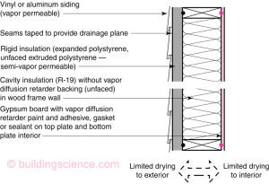

Figure 2
Example Wall Assemblies and Drying Direction
Figure_02
  • Semi-vapor permeable (unfaced) insulating sheathing allows limited drying to the exterior. Vapor diffusion retarder paint on the interior gypsum board limits but does not eliminate drying to the interior.
