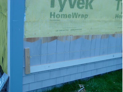

Gravity is the driving force in drainage plane function. Gravity is very reliable. Water management techniques that ignore or try to counteract gravity—reverse lapped flashings for example—are bound to fail.
In order for a drainage plane to be effective it must be continuous in the field of the water repellent material and integrated with flashings and to the water management strategies of other enclosure assemblies (such as roofs, foundations, and windows).

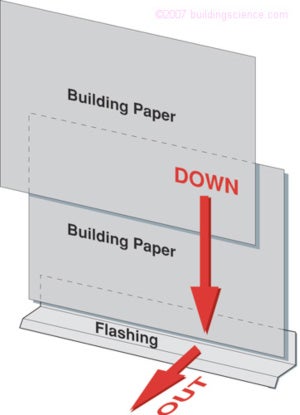

The continuity of the drainage plane is maintained in two ways: 1) through shingle lapping of the materials 2) taping or sealing of material joints in a barrier approach.

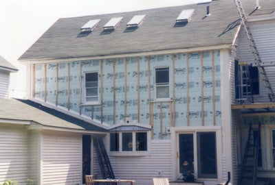

Wood lap siding has traditionally been installed tight to building paper drainage plane. This creates an intermittent drainage space and is largely dependant on the profile of the siding. This type of installation works well for most instances, however it often reduces the service life of the siding material and has been attributed to some building failures. Ideally wood siding and cementitious lap siding should be installed over vertical wood furring or a plastic spacer mesh to create a vented and drained space behind the cladding.

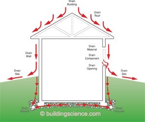

Figure 1
Fundamental Rain Water Control
- Drain the site – slope grade away from building
- Drain the ground – foundation perimeter drain
- Drain the building – roof system
- Drain the assembly – drainage plane and water management system
- Drain the opening – pan flashings
- Drain the component
- Drain the material
Figure 2
Shingle Lapped Assembly
Figure 3
Barrier Assembly

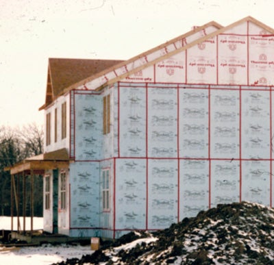

Photograph 1
Water Resistant Sheathing as Drainage Plane
- All joints and seams in sheathing sealed with compatible and durable tape
Photograph 2
Wood Furring Strip Drainage Space
- Furring strips fastened to framing through insulating sheathing.
- All openings top and bottom provided with screen to prevent insect entry
Photograph 3
Plastic Mesh Drainage Space
