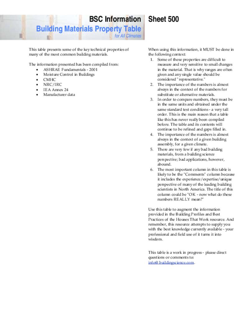

The information presented has been compiled from:
ASHRAE Fundamentals - 2001
Moisture Control in Buildings
CMHC
NRC/IRC
IEA Annex 24
Manufacturer data
When using this information, it MUST be done in the following context:
Some of these properties are difficult to measure and very sensitive to small changes in the material. That is why ranges are often given and any single value should be considered "representative."
The importance of the numbers is almost always in the context of the numbers for substitute or alternative materials.
In order to compare numbers, they must be in the same units and obtained under the same standard test conditions - a very tall order. This is the main reason that a table like this has never really been compiled before. The table and its contents will continue to be refined and gaps filled in.
The importance of the numbers is almost always in the context of a given building assembly, for a given climate.
There are very few if any bad building materials, from a building science perspective; bad applications, however, abound.
The most important column in this table is likely to be the "Comments" column because it includes the experience/expertise/unique perspective of many of the leading building scientists in North America. The title of this column could be "OK - now what do these numbers REALLY mean?"
Use this table to augment the information provided in the Designs That Work and Enclosures That Work resources. And remember, this resource attempts to supply you with the best knowledge currently available - your professional and field use of it turns it into wisdom.
This table is a work in progress - please direct questions or comments to: info@buildingscience.com.
