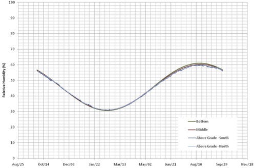

The relative humidity was predicted in the center of the open-cell spray foam insulation and was found to be at safe levels (Figure 2).
Low permeance interior wall finishes (< Class III) should be avoided with this construction strategy so the material characteristics of the spray on thermal barrier must be considered.
Figure 2: Predicted RH at the interior surface of open-cell spray foam
