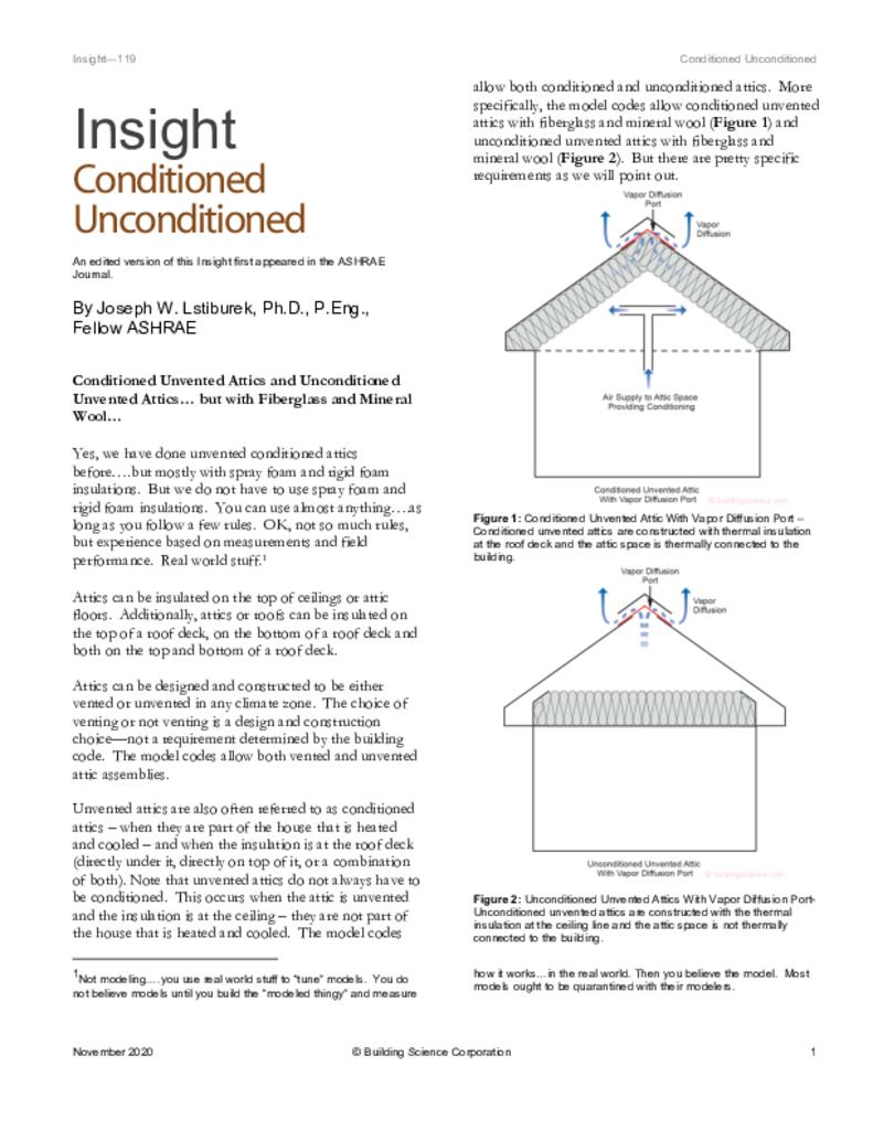

Attics can be insulated on the top of ceilings or attic floors.  Additionally, attics or roofs can be insulated on the top of a roof deck, on the bottom of a roof deck and both on the top and bottom of a roof deck.
Attics can be designed and constructed to be either vented or unvented in any climate zone.  The choice of venting or not venting is a design and construction choice—not a requirement determined by the building code.  The model codes allow both vented and unvented attic assemblies.
Unvented attics are also often referred to as conditioned attics – when they are part of the house that is heated and cooled – and when the insulation is at the roof deck (directly under it, directly on top of it, or a combination of both). Note that unvented attics do not always have to be conditioned.  This occurs when the attic is unvented and the insulation is at the ceiling – they are not part of the house that is heated and cooled.  The model codes allow both conditioned and unconditioned attics.  More specifically, the model codes allow conditioned unvented attics with fiberglass and mineral wool (Figure 1) and unconditioned unvented attics with fiberglass and mineral wool (Figure 2).  But there are pretty specific requirements as we will point out.
Figure 1: Conditioned Unvented Attic With Vapor Diffusion Port – Conditioned unvented attics are constructed with thermal insulation at the roof deck and the attic space is thermally connected to the building.
Figure 2: Unconditioned Unvented Attics With Vapor Diffusion Port- Unconditioned unvented attics are constructed with the thermal insulation at the ceiling line and the attic space is not thermally connected to the building.

Controlling Moisture in Unvented Attics
The key to unvented attic and roof assemblies is to control condensation or moisture accumulation on the underside of the roof sheathing.  This can be done several ways.  One way is to raise the temperature of the roof sheathing by insulating on the top of the roof sheathing (Figure 5).
