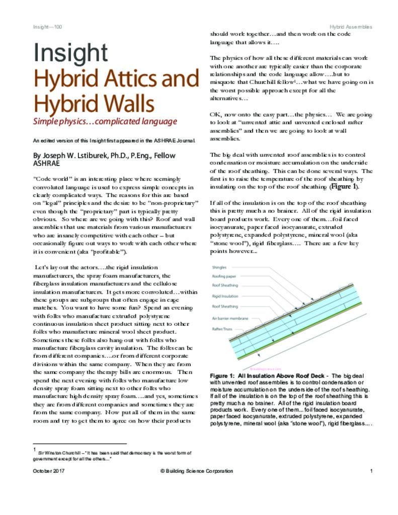

BSI-100: Hybrid Assemblies
“Code world” is an interesting place where seemingly convoluted language is used to express simple concepts in clearly complicated ways.  The reasons for this are based on “legal” principles and the desire to be “non-proprietary” even though the “proprietary” part is typically pretty obvious.   So where are we going with this?  Roof and wall assemblies that use materials from various manufacturers who are insanely competitive with each other – but occasionally figure out ways to work with each other where it is convenient (aka “profitable”).
Let’s lay out the actors….the rigid insulation manufacturers, the spray foam manufacturers, the fiberglass insulation manufacturers and the cellulose insulation manufacturers.  It gets more convoluted…within these groups are subgroups that often engage in cage matches.  You want to have some fun?  Spend an evening with folks who manufacture extruded polystyrene continuous insulation sheet product sitting next to other folks who manufacture mineral wool sheet product.  Sometimes these folks also hang out with folks who manufacture fiberglass cavity insulation.  The folks can be from different companies….or from different corporate divisions within the same company.  When they are from the same company the therapy bills are enormous.   Then spend the next evening with folks who manufacture low density spray foam sitting next to other folks who manufacture high density spray foam….and yes, sometimes they are from different companies and sometimes they are from the same company.  Now put all of them in the same room and try to get them to agree on how their products should work together…and then work on the code language that allows it….
The physics of how all these different materials can work with one another are typically easier than the corporate relationships and the code language allow….but to misquote that Churchill fellow[1]…what we have going on is the worst possible approach except for all the alternatives…
OK, now onto the easy part…the physics…  We are going to look at “unvented attic and unvented enclosed rafter assemblies” and then we are going to look at wall assemblies.
The big deal with unvented roof assemblies is to control condensation or moisture accumulation on the underside of the roof sheathing.  This can be done several ways.  The first is to raise the temperature of the roof sheathing by insulating on the top of the roof sheathing (Figure 1).
If all of the insulation is on the top of the roof sheathing this is pretty much a no brainer.  All of the rigid insulation board products work.  Every one of them…foil faced isocyanurate, paper faced isocyanurate, extruded polystyrene, expanded polystyrene, mineral wool (aka “stone wool”), rigid fiberglass….  There are a few key points however...
Figure 1:  All Insulation Above Roof Deck -  The big deal with unvented roof assemblies is to control condensation or moisture accumulation on the underside of the roof sheathing. If all of the insulation is on the top of the roof sheathing this is pretty much a no brainer.  All of the rigid insulation board products work.  Every one of them…foil faced isocyanurate, paper faced isocyanurate, extruded polystyrene, expanded polystyrene, mineral wool (aka “stone wool”), rigid fiberglass….
There must be an air control layer (air barrier) under the rigid insulation boards.  The air control layer can be a fully adhered membrane on the roof deck or the air control layer can be the roof deck itself.  Whatever.  It is also a good idea to have the rigid board products installed in multiple layers with joints offset to address the inherent dimensional instability of almost all rigid board products and to limit three dimensional airflow networks within the multiple layers of this assembly (see “BSI-036: Complex 3D Airflow Networks”, February 2010).
