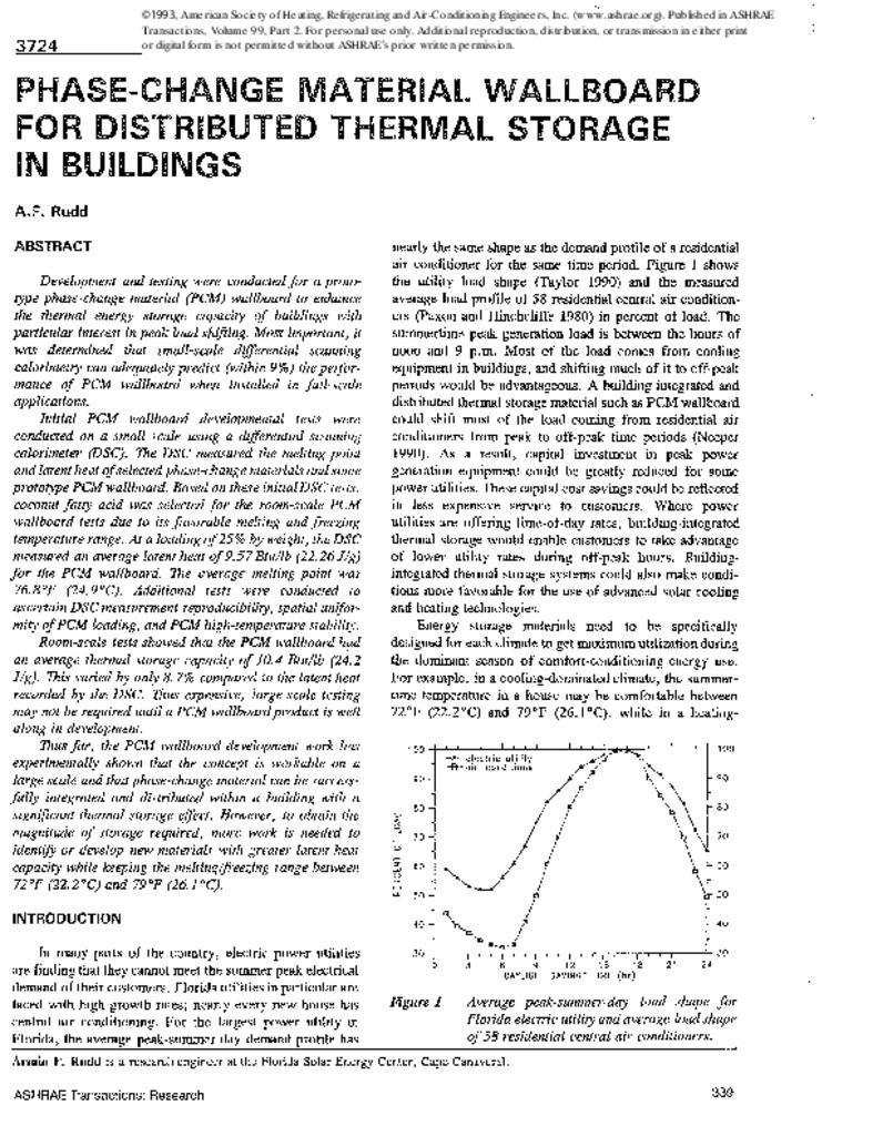

In many parts of the country, electric power utilities are finding that they cannot meet the summer peak electrical demand of their customers. Florida utilities in particular are faced with high growth rates; nearly every new house has central air conditioning. For the largest power utility in Florida, the average peak-summer-day demand profile has nearly the sames hape as the demandp rofile of a residential air conditioner for the same time period. Figure 1 shows the utility load shape (Taylor 1990) and the measured average load profile of 58 residential central air conditioners (Paxon and Hinchcliffe 1980) in percent of load. The summertime peak generation load is between the hours of noon and 9 p.m. Most of the load comes from cooling equipment in buildings, and shifting much of it to off-peak periods would be advantageous. A building integrated and distributed thermal storage material such as PCM wallboard could shift most of the load coming from residential air conditioners from peak to off-peak time periods (Neeper 1990). As a result, capital investment in peak power generation equipment could be greatly reduced for some power utilities. These capital cost savings could be reflected in less expensive service to customers. Where power utilities are offering time-of-day rates, building-integrated thermal storage would enable customers to take advantage of lower utility rates during off-peak hours. Building integrated thermal storage systems could also make conditions more favorable for the use of advanced solar cooling and heating technologies.
Figure 1: Average peak-summer-day load shape for Florida electric utility and average load shape of 58 residential central air conditioners
