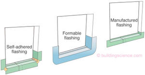

Material
In wood framed openings the pan flashings may be fashioned in the field from self-adhered flashing membrane, self-adhered formable flashing, non-water-sensitive sheet metal and certain liquid-applied waterproof membranes.
Manufactured pan flashing may also be used to drain the opening. Note that two-piece pan flashing will need to be sealed at the joint between the pieces and that pre-cast panned sills for masonry openings will need sealant at the joints with the side of the opening.

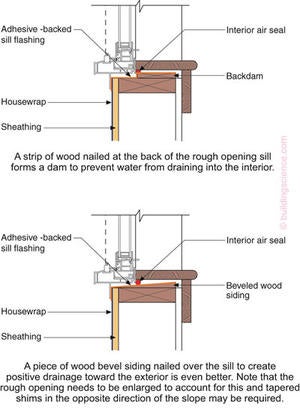

Back Dam and Sloping
A block of wood nailed at the back of the rough opening sill can be used with membranes to create a back dam. Similarly, beveled siding can be nailed at the bottom of the rough opening to create a positive slope under the membrane. The back dams of manufactured pan flashing and sheet metal pan flashing must be protected against bending and breakage during window installation.

Pan Flashing Materials
- Non-formable self-adhered membrane requires corner patches
- Formable flashing must be pressed into corners to prevent window corners from tearing membrane
- Two-piece manufactured flashing requires seal at joint
- Back dam of manufactured pan flashing must be protected from breakage during window installation

Back Dam Options for Membrane Pan Flashing
- A strip of wood nailed across the back of the rough opening sill forms a dam to prevent water from draining into the interior
- Beveled siding nailed over the sill creates positive drainage toward the exterior. Note that tapered shims in the opposite direction of the slope may be required to support interior trim.
