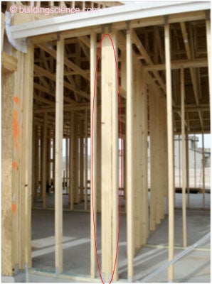

This article addresses the issue of interior wall at exterior wall connection with excessive framing resulting in extra costs of both time and materials that could potentially be avoided by using alternate construction techniques. Corrective measures are also suggested.
Interior wall at exterior wall connection with excessive framing
Ladder blocking should have been used at the interior wall at exterior wall connection
Issue
Interior wall at exterior wall connection.
Six unnecessary studs are used to provide this connection.
Risks
Had Advanced Framing techniques been used an overall savings of approximately $2,000 per building would have been realized. The money could have been available to improve other building components to make them more energy efficient in addition to increasing the builder’s profit margin and improving the marketability of the product.
Required Corrections
A ladder blocking strategy should have been used for the interior and exterior wall connection.
