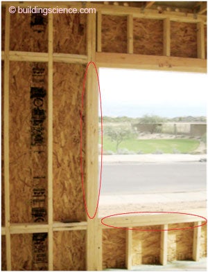

This article addresses the issue of extra framing used unnecessarily around window openings resulting in extra costs of both time and materials that could potentially be avoided. Corrective measures are also suggested.
Extra framing used unnecessarily around window opening

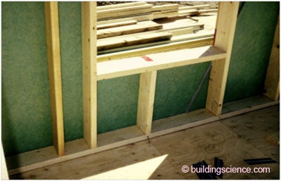

Correct window framing using Advanced Framing with single horizontal and vertical framing members
Issue
Extra framing used unnecessarily around window openings.
Extra horizontal framing members at the window sill and extra vertical framing members beside the window openings.
Risks
Incorporating Advanced Framing techniques around the windows would greatly reduce the wood required below the top plate of the upper story, and it’s estimated that between $500 and $750 in material costs could be saved in this example alone had a single beam been used directly under the roof trusses.
Required Corrections
Only one horizontal framing member is required at the bottom of the window; remove extra vertical framing members.
