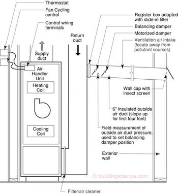

One example of a ventilation system design is a central fan integrated supply (CFIS) system, which is made up of a 6-inch outdoor air intake duct connected to the return side of the air handler with a fan cycling control to make sure the fan runs a programmed minimum amount of time. This duct draws outdoor air into the air distribution system and distributes it to the various rooms in the house. The intake duct has a motorized damper also controlled by the fan cycling control to close the damper to prevent over ventilation of the house during times of significant space conditioning demands. A schematic of the CFIS system with 6-inch motorized damper is shown in figure Outdoor Air Duct Connected to the Return of the Air Handler.

Figure 1
Outside air duct should be insulated and positioned so that there is a fall/slope toward the outside to drain any potential condensation due to blown snow.
Motorized damper allows control of ventilation air duty cycle (i.e., open time) separate from air handler duty cycle (i.e. run time).
Controller can be mounted on the air handler, or in the main space near the thermostat.
Balancing damper adjusted to provide required air flow.
Mixed return air (15% or less outside air mixed with 85% or more inside air) temperature should not drop below 55° Fahrenheit, or follow furnace manufacturer’s instructions.

Figure 3
