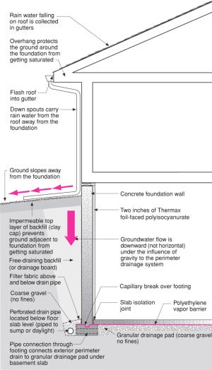

Figure 1
Groundwater Control with Basements
- Keep rain water away from the foundation perimeter
- Drain groundwater away in sub-grade perimeter footing drains before it gets to the foundation wall

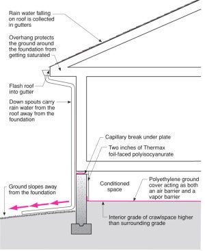

Figure 2
Groundwater Control with Crawlspaces
- If the interior crawlspace is lower than the exterior grade, a sub-grade perimeter footing drain is necessary as in a basement foundation
- The crawlspace in this configuration is conditioned space; it is part of the “interior” of the building and should be heated, cooled and ventilated as part of the building’s heating, cooling and ventilating strategy

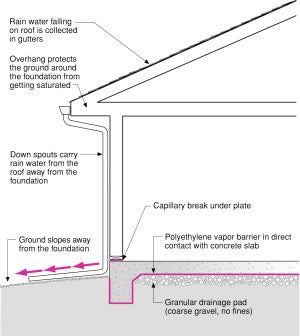

Figure 3
Groundwater Control with Slabs
- Do not place sand layer over polyethylene vapor barrier under concrete slab
