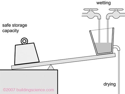

All enclosure design requires a balance of wetting and drying (Figure 1). Since wetting occurs at different times than drying, storage bridges the time between wetting and drying. If a balance between wetting and drying is maintained, moisture will not accumulate over time, the safe moisture content will not be exceeded, and moisture-related problems are unlikely. The storage capacity and the extent and duration of wetting and drying must, however, always be considered when assessing the risk of moisture damage.
Figure 1: The moisture balance analogy.

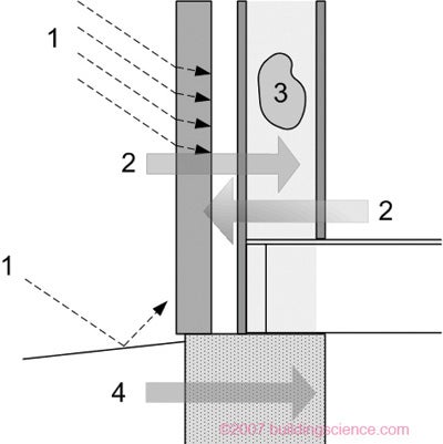

The four major sources of moisture for the above-grade building enclosure are (Figure 2):
precipitation, especially driving rain,
water vapor in the air transported by diffusion and/or air movement through the wall (from either the interior or exterior),
built-in and stored moisture, and
liquid and bound ground water.
Figure 2: Moisture sources and mechanisms for an arbitrary enclosure wall.

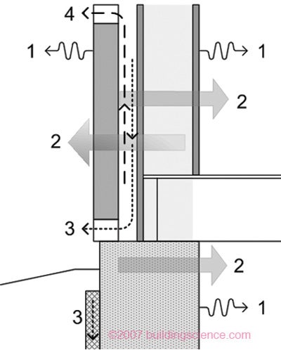

An assembly’s drying potential is an important factor in assessing its vulnerability to moisture problems. Moisture is usually removed from an enclosure assembly by (Figure 3):
evaporation of water at the interior and exterior surface transported their by capillary suction through microscopic pores;
vapor transport by diffusion (through microscopic pores), air leakage (through cracks and holes), or both, either outward or inward;
drainage through gaps, cracks and openings, driven by gravity; and
ventilation (ventilation drying), the intentional flow of air behind the cladding.
Figure 3: Moisture removal mechanisms.
