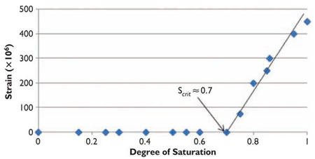

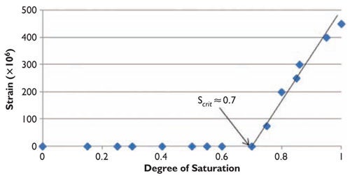

How can we tell good brick from bad brick? For this freeze/thaw thing it turns out to be the critical degree of saturation (Scrit).5 Frost damage results in permanent irreversible expansion. However, there is a critical degree of saturation (Scrit) below which no frost damage occurs regardless of the number of freeze/thaw cycles the material is exposed to.6 We are not entirely sure why this is, but we are sure that this is. So we work with this. Again, I point out that we are engineers and this is what we do. We don’t always have to know why something is, only that it is, in fact, is.7

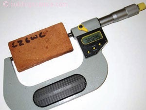

How do we determine this critical degree of saturation (Scrit)? Easy. Get a brick and wet it a little and cycle it through some freeze/thaw cycles. Then, wet it some more and do the same thing. Wet it even more, and keep doing it until the brick does not come back to its original dimension (Photograph 1 and Figure 1).
Photograph 1: Measuring Brick Expansion Under Freeze/Thaw Cycling—A micrometer is used to determine permanent irreversible expansion. The moisture content of the brick at which, under repeated freeze/thaw cycles, results in permanent irreversible expansion is called the “critical degree of saturation.”
Figure 1: Critical Degree of Saturation—This is measured as a percentage of the vacuum saturation of the brick. From Mensinga, P. 2009. “Determining the Critical Degree of Saturation of Brick Using Frost Dilatometry.” Master of Applied Science in Civil Engineering Thesis, University of Waterloo, Waterloo, ON, Canada. This youngster is on to something here. Memo to self: keep an eye on him, he looks destined for great things.
What is a good Scrit? About 0.8 and higher. What is a poor Scrit? About 0.4 and lower. How do we know this? We measure “good” brick, which is brick that does not seem to be affected by freeze/thaw cycles even where it is exposed to severe wetting. Modern, frost-resistant brick yields these values. Then, we compare it to measurements of “bad” brick that is clearly affected by freeze/thaw cycles even where it is not exposed to much wetting at all.

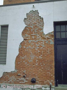

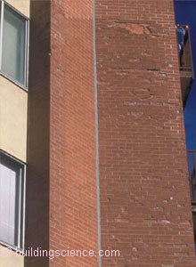

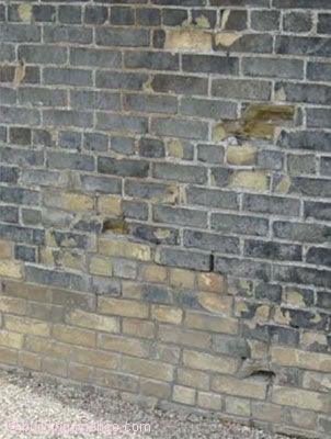

First, go to the building and look around very, very carefully. Look for brick that is damaged. What does damaged brick look like? Trust me, you will know when you see it. Check out these images (Photographs 2, 3 and 4) to help you “calibrate” your observations.
Photograph 2: “Classic” Freeze/Thaw Damage—Low to the ground, not very exposed to rainwater and in really bad shape. It turns out that this is a “bad” brick with a low Scrit.

Photograph 4: Early ’80s Ontario Apartment—The brick is clearly experiencing freeze/thaw damage. It should not be doing this because the brick is not being exposed to what I would define as an extreme exposure. The brick turned out to be pretty bad when tested with an Scrit of less than 0.5, which is unusual for a 30-year-old brick. Most of us felt that by the ’80s we had figured out how to make good brick. Apparently, that’s not the case here.
Photograph 2 is an easy one. This is “classic” freeze/thaw damage. It is low to the ground, not very exposed to rainwater and in really bad shape. It turns out that this is a bad brick with a low Scrit used in a high exposure application. But I know that already just by looking at it. I don’t actually have to test this brick type to know what is going on. Now, for a little bit more information to make this really interesting, which is this wall assembly is unheated and has been for many years. It turns out that the damage began to occur when the assembly became unheated and abandoned. This is an “ah ha” moment, folks.
Think about it. This is an example of what would happen to this type of brick if it were in a heated building that was then well insulated on the inside. An unheated building is a very good approximation of a wall in a heated building that is well insulated on the interior.
Now for the corollary: if an old building with a multi-wythe brick mass wall has been unheated for a whole bunch of years and the brick is not damaged it will not get damaged, if you decide to insulate it on the inside and heat it. If you measure the Scrit, will it be high or low or in between? It could be any one of the possibilities. It could be bad low Scrit brick that never gets wet. Or it could be good high Scrit brick that does get wet. Or in between. It does not matter because the important test turns out to be the real-world observation that shows the building has been fine even though it has been unheated. So, do you measure the Scrit? Sure, it is nice to know if it has been a bad brick that has not been getting wet or vice versa. It’s good stuff to know so you can put it in the file to cover your butt. Why? Exposures might change, and you might want folks to know if that becomes a problem.

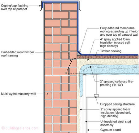

What if I have a heated building? Where do I look? Look for a part of the building that is unheated and exposed. Best place is a parapet (Figure 2). Parapets typically have the most extreme exposure to rainwater wetting, and they are unheated on their backside because they project above the roof. They also typically get wetted from underneath and inside due to the stack effect moving interior moisture laden air to the parapet. If a parapet has not been experiencing freeze/thaw damage, you can pretty much conclude that if you insulate the interior of the mass wall assembly you are not going to have a problem either.
Figure 2: Parapets—Parapets typically have the most extreme exposure to rainwater wetting, and they are unheated on their backside because they project above the roof. They also typically get wetted from underneath and inside due to the stack effect moving interior moisture-laden air to the parapet. If a parapet has not been experiencing freeze/thaw damage, you can pretty much conclude that if you insulate the interior of the mass wall assembly you will not have a problem either.

Photograph 4 is interesting for a couple of reasons. It is in Ontario, Canada, and it was built in the early ’80s. The brick is clearly experiencing freeze/thaw damage. It should not be doing this because the brick is not being exposed to what I would define as an extreme exposure. The brick turned out to be pretty bad when tested at an Scrit of less than 0.5, but it passed the ASTM C/B ratio requirement. This is unusual for a 30-year-old brick. Most of us felt that by the ‘80s we had figured out how to make good brick. Apparently, that’s not true in this case.

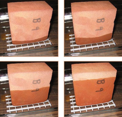

The two easy pieces of this are the absorbtion characteristics of the brick and the temperature profile. How much liquid water brick absorbs, and how quickly it absorbs it is called the capillary water uptake coefficient (the “A-value”) and it can be measured (Photograph 5). The temperature profile is pretty easy to predict with a computer simulation.
Photograph 5a (top left): Capillary water uptake coefficient after 30 seconds. Photograph 5b (top right): Capillary water uptake coefficient after two minutes. Photograph 5c (bottom left): Capillary water uptake coefficient after 10 minutes. Photograph 5d (bottom right): Capillary water uptake coefficient after 30 minutes.

Scrit is the moisture content at which freeze/thaw damage begins to occur divided by the vacuum saturated moisture content. Damaged is defined as irreversible expansion. Although damage occurs after one cycle, six cycles are used to determine Scrit because a larger expansion is easier to measure, and six cycles are not enough to destroy the sample. Notice that I did not use the standard c/b ratio or the 50-cycle freeze/thaw test as a criteria. For reasons why they don’t work check out: Mensinga, P., J. Straube, J and C. Schumacher. 2010. “Assessing the Freeze-Thaw Resistance of Brick Masonry Units for Retrofit Insulation Projects.” ASHRAE Transactions, Volume 116, Part 2. You will have to wait until the ASHRAE Annual Conference later in the year to get it. I know the guys who wrote it, and so I know what is in it.
