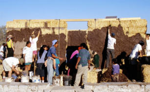

Photographs 1 and 2: Strawbale walls can be built with locally available materials and community labor (left) and are often chosen for their sculpted, massive aesthetics (right).

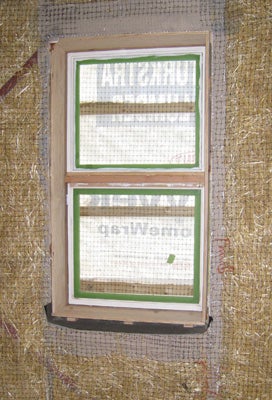

Photograph 3: Window framing (with subsill flashing), shear bracing and wire mesh reinforcement. This wall is ready for plaster.

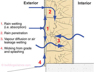

The three major sources of moisture for the above-grade building enclosure are:
condensation of water vapour transported by diffusion and/or air movement through the wall (from either the interior or exterior),
precipitation, especially driving rain, both by penetration and capillary absorption,
built-in and stored moisture.
(Enclosures at or below grade also need to deal with moisture from ground sources such as surface run off, melt water, high water tables, etc.)
Driving rain is usually the largest moisture source for above-grade walls. Rain deposition on one or more faces of an exposed building in many parts of North America has been measured to be in the order of 200 kg/m2/yr. The addition of an overhang, pitched roof, and protection from neighbouring buildings can reduce this exposure by a factor of 10. The majority of any rain deposited tends to be shed by stucco, with a significant amount absorbed while a small amount penetrates through cracks. The majority of water penetration problems with stucco occurs at penetrations. Driving rain control is dealt with in a subsequent section.
Condensation of the water vapour in exfiltrating air during cold weather or infiltrating air during hot-humid conditions can also deposit significant amounts of water within a wall. While diffusion wetting is typically not a powerful wetting mechanism, diffusion is an important means of moisture movement between the stucco layers and straw in a strawbale wall.
Built-in moisture can be important in some wall assemblies. The use of wet framing lumber, saturated concrete block, or green concrete within a wall may provide a large initial source of moisture. The built-in moisture from concrete foundations and stucco must be allowed to dry out. Thus, SB walls should be designed to allows drying by choosing properly vapour permeable materials. The major source of built-in moisture, the stucco skins, can dry very quickly because of their location.
Wicking and splashing from the ground can be a problem for walls close to grade. Both can be controlled by flashing, well-drained soils, good eavestrough and site drainage, etc. The stucco-coated strawbale must be kept at least 6” (150 mm) above grade, although 8-12” (200-300 mm) is recommended.
Figure 1: Wetting mechanisms in strawbale walls
Moisture control strategies for many modern walls have tended to focus on reducing the potential for wetting by, for example, increasing air tightness and interior vapour resistance, reducing the volume of water penetration and absorption, etc. However, it has become generally accepted that most building construction will not be perfect, and thus wetting will occur. Therefore, attention must be given to design approaches that increase a wall's drying and/or storage potential.

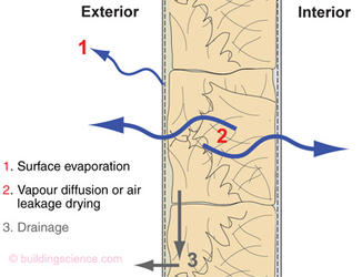

An assembly's drying potential is an important factor in assessing its vulnerability to moisture problems. Strawbale walls, like solid multi-wythe brick walls, adobe and straw-clay walls, are more susceptible to wetting than a modern wood frame wall. But as history has shown, these types of walls can be quite durable so long as drying is allowed.
Moisture is usually removed from a wall by:
- evaporation from the inside or outside surfaces,
 - drainage, driven by gravity,
 - vapour transport by diffusion either outward or inward or both; and
 - air flow either outward or inward or both.
Drainage is the mechanism capable of removing the greatest volume of water in the shortest period of time. Hence it is can be a very important mechanism for moisture control. Provided a clear drainage path exists (e.g. cavities, slopes, drainage openings), a large proportion of rain water penetration or condensation can flow out of certain walls, such as brick veneer, vinyl, etc. However, drainage is not the only mechanism or even sufficient on its own, to provide drying. Stucco clad walls, solid masonry walls, and strawbale walls can function well by using other drying mechanisms, and attempting to incorporate drainage in these time-proven designs often creates an inferior wall system.
Drainage within strawbale walls is not a reliable rain control strategy as the straw becomes too wet during the drainage process. Drainage of windows, doors, and any penetrations IS effective and should always be incorporated into a strawbale wall.
Figure 2: Drying mechanisms in strawbale walls
Under the right conditions the moisture from rain penetration and condensation not drained from a wall will dry by evaporation or desorption. The resulting water vapour can be transported out of and redistributed within a wall system either by diffusion or air leakage or both acting together.
Diffusive drying is one of the two mechanisms that can remove moisture that is absorbed or trapped in a wall. Diffusion outward, especially when driven by large vapour gradients in the winter, can remove a significant amount of moisture and be an effective drying mechanism. Outward drying for strawbale walls can occur in most parts of Canada since exterior stucco has a relatively high vapour permeance and the outdoor vapour pressure is often quite low in winter. Diffusion drying can only occur in an outward direction if very low permeance polyethylene vapour barriers are located on the exterior side of the interior finish. In walls exposed to solar heating, inward drying can be significant if it is allowed by the use of relatively vapour permeable interior layers. For example, a significant proportion of drying can occur to the inside in strawbale walls, so long as polyethylene or similar vapour resistant layers are not used.
Air flow (or leakage) through the enclosure can, under the proper conditions, move a large quantity of moisture. While air leakage usually leads to condensation wetting under many winter conditions, it can also remove moisture during warmer weather. Periodic reversals of air flow from exfiltration to infiltration (when the wind changes direction for example) can allow drying even under winter conditions. Similarly, cold weather stack-effect-driven infiltration and warm weather exfiltration can cause drying. Since the amount of air leakage drying and wetting cannot easily be predicted or controlled the recommended approach is to control all air movement and secure drying by other mechanisms.
Capillary transport, often termed wicking, is not itself a drying mechanism but it does act to redistribute moisture within a system. Stucco is highly capillary active and wicks water quite effectively. This means that water that is deposited on one face of the stucco can be transported to the other. In practice, water that penetrates stucco (from any source) will evaporate, diffuse to the back of the stucco and either pass through to the exterior or condense on the back face. Any vapour that condenses will wick to the exterior surface from where it can quickly evaporate. This drying mechanism is one reason not to introduce building paper between the stucco and straw.
Drying almost never occurs at the same time as wetting. Therefore, to bridge the gap in time between wetting and drying, some safe storage capacity within the wall is needed.
