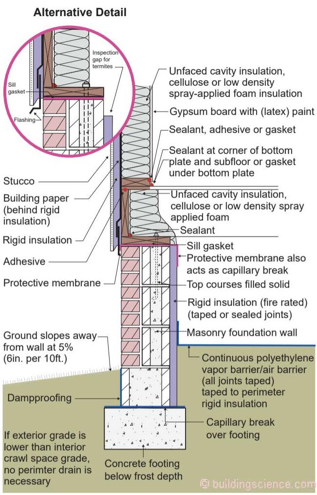

Let’s do the obvious one first. Build them like “mini” basements where they are completely connected to the house (or building). With this approach any floor finish or floor covering works…wood floors, tile floors, vinyl flooring…all of them work. The key to this approach to crawlspaces is that they are “conditioned". I hate the term “unvented crawlspaces”2…“unvented” implies that you just don’t install vents. Wrong. Big time wrong. There has to be a means of removing moisture from the crawlspace when the crawlspace is connected to the house just like there has to be a means of removing moisture from any room in the house. In the rooms and spaces in houses we do it with controlled air change during heating seasons and dehumidification via air conditioning (or via a dehumidifier) during cooling seasons. Houses are “conditioned” and conditioning means controlling temperature and relative humidity.3
So what does a conditioned crawlspace look like? Check out Figure 1 and Photograph 3. It is insulated on the interior with rigid insulation. It has a continuous vapor impermeable ground cover….do not forget the columns and posts (Figure 2). It is air sealed isolating it from the exterior air and the ground below. Now for the conditioning part…folks tend to forget this part. You have to provide air change between the crawlspace and the house or you have to provide dehumidification. The building code calls for 50 cfm per 1,000 ft2(approximately 25 l/s per 100 m2) of supply air or dehumidification.
Figure 1: Conditioned Crawlspace - It is insulated on the interior with rigid insulation. It has a continuous vapor impermeable ground cover. Note the termite inspection gap for you North Carolina folks….

So how do you do the conditioning? There are 6 typical ways (maybe more) of doing it (Figure 3a, 3b, 3c, 3d, 3e and 3f). When you supply air to the crawlspace from an air conditioner or furnace (Figure 3a) there needs to be a way for air to come back to the house…besides poor workmanship. A transfer grille is recommended (Figure 4). If you pull air out of the crawlspace with a return duct (Figure 3b) there needs to be a way for air to get from the house to the crawlspace….yes a transfer grille is recommended.
Figure 3a: Supply Air to Crawlspace - When you supply air to the crawlspace from an air conditioner or furnace there needs to be a way for air to come back to the house…besides poor workmanship. A transfer grille is recommended.
