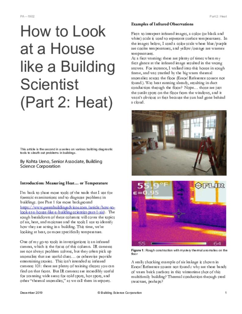

PA-1902: How to Look at a House like a Building Scientist (Part 2: Heat)
A nuanced look at thermal imaging and how it can shed light on much more than heat loss.
Introduction: Measuring Heat… or Temperature
I’m back to share more tools of the trade that I use for forensic examinations and to diagnose problems in buildings. (see Part 1 for more background https://www.greenbuildingadvisor.com/article/how-to-look-at-a-house-like-a-building-scientist-part-1-air).  The rough breakdown of these columns will cover the topics of air, heat, and moisture and the tools I use to identify how they are acting in a building. This time, we’re looking at heat, or more specifically temperature.
One of my go-to tools in investigations is an infrared camera, which is the focus of this column.  IR cameras are not always problem solvers, but they often pick up anomalies that are useful clues… or otherwise provide entertaining stories. This isn’t intended as infrared cameras 101: there are plenty of training classes you can find on that front. But IR cameras are incredibly useful for scanning wide areas for cold spots, hot spots, and other “thermal anomalies,” as we call them in reports.
Examples of Infrared Observations
First: to interpret infrared images, a color (or black and white) scale is used to represent surface temperatures.  In the images below, I used a color scale where blue/purple are cooler temperatures, and yellow/orange are warmer temperatures.
As a first warning: there are plenty of times when my first glance at the infrared image resulted in the wrong answer.  For instance, I walked into this house in rough frame, and was startled by the big warm thermal anomalies across the floor (Figure 1). Was heat running already, resulting in duct conduction through the floor?  Nope… those are just the sunlit spots on the floor from the windows, and it wasn’t obvious at first because the sun had gone behind a cloud.
Figure 1:  Rough construction with mystery thermal anomalies on the floor
A really shocking example of air leakage is shown in Figure 2: why are there bands of warm brick surfaces in this wintertime shot of this multifamily building? Thermal conduction through steel structure, perhaps?
Figure 2:  Gross air leakage visible on exterior building enclosure/shell
