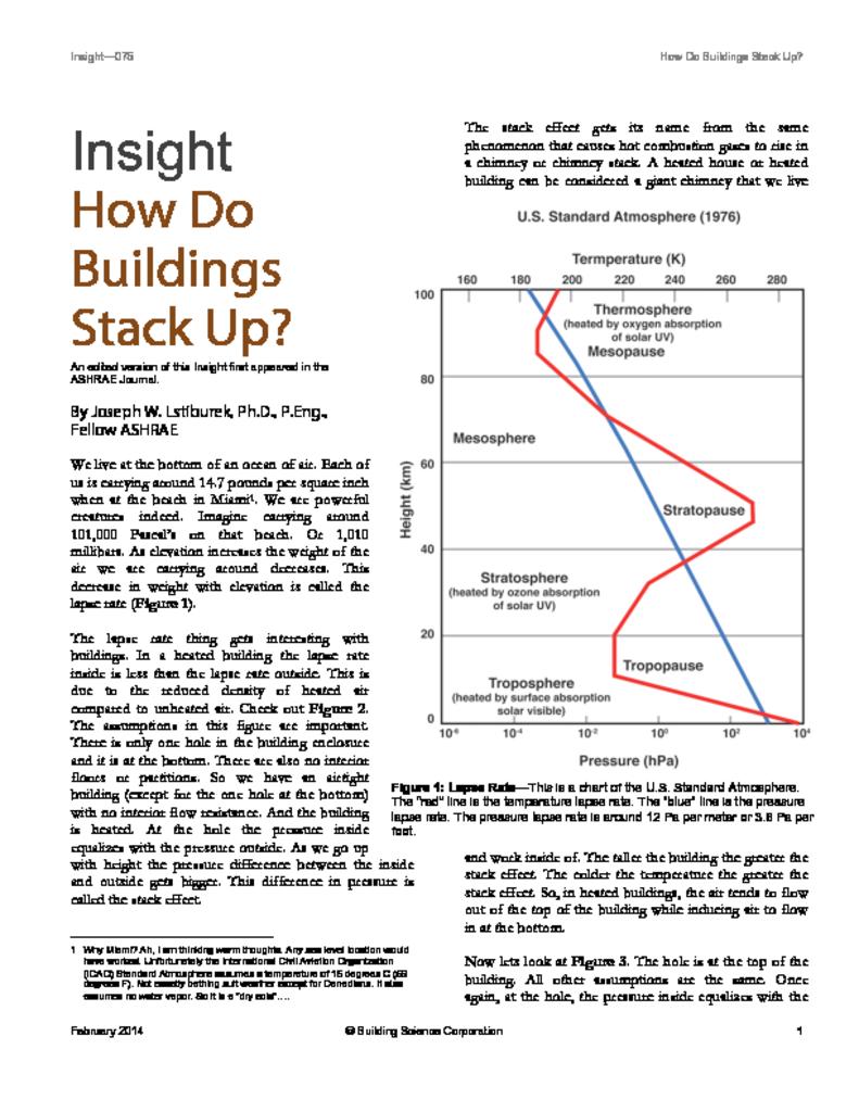

We live at the bottom of an ocean of air. Each of us is carrying around 14.7 pounds per square inch when at the beach in Miami1. We are powerful creatures indeed. Imagine carrying around 101,000 Pascal’s on that beach. Or 1,010 millibars. As elevation increases the weight of the air we are carrying around decreases. This decrease in weight with elevation is called the lapse rate (Figure 1).
Figure 1: Lapse Rate—This is a chart of the U.S. Standard Atmosphere. The “red” line is the temperature lapse rate. The “blue” line is the pressure lapse rate. The pressure lapse rate is around 12 Pa per meter or 3.6 Pa per foot.

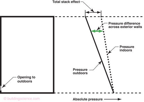

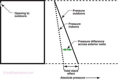

The lapse rate thing gets interesting with buildings. In a heated building the lapse rate inside is less than the lapse rate outside. This is due to the reduced density of heated air compared to unheated air. Check out Figure 2. The assumptions in this figure are important. There is only one hole in the building enclosure and it is at the bottom. There are also no interior floors or partitions. So we have an airtight building (except for the one hole at the bottom) with no interior flow resistance. And the building is heated. At the hole the pressure inside equalizes with the pressure outside. As we go up with height the pressure difference between the inside and outside gets bigger. This difference in pressure is called the stack effect.
Figure 2: Stack Effect - Building with no internal separations with opening at the bottom
(adapted from Handegord, 1998).
The stack effect gets its name from the same phenomenon that causes hot combustion gases to rise in a chimney or chimney stack. A heated house or heated building can be considered a giant chimney that we live and work inside of. The taller the building the greater the stack effect. The colder the temperature the greater the stack effect. So, in heated buildings, the air tends to flow out of the top of the building while inducing air to flow in at the bottom.

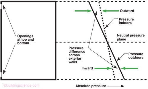

What happens when we have two holes the same size? One at the top and one at the bottom? Check out Figure 4. The “dotted” line shifts right partially. It crosses the “solid” line smack dab in the center of the building elevation wise. Where the interior lapse rate line crosses the exterior lapse rate line the pressure inside equals the pressure outside. No pressure difference exists. We call that the neutral pressure plane or neutral pressure zone. A real smart old guy wrote about this in this Journal in 1926.2
Figure 4: And Still More Stack Effect - Building with no internal separations with openings at the top and bottom (adapted from Handegord, 1998). Beginning to look familiar, eh? Notice the “neutral pressure plane”. At the neutral pressure plane no difference in pressure exists between the inside and the outside.

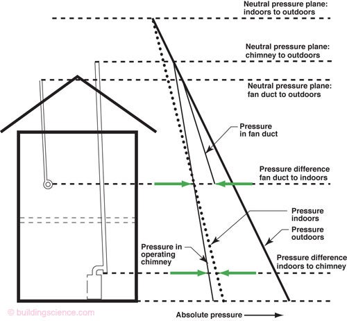

Most homes in cold climates were heated with fuel burning furnaces - gas and oil heat. These appliances had chimneys. As far as building enclosures are concerned chimneys are exhaust fans—big ones at that. Exhaust fans and chimneys tend to raise the neutral pressure plane. Most houses in cold climates with big oil and gas furnaces had neutral pressure planes located above attic ceilings (Figure 6). This had enormous implications for building durability.
Figure 6: House With Operating Chimney—The operating chimney depressurizes the house by raising the neutral pressure plane well above the ceiling (adapted from Handegord). It was hard to rot a house in a cold climate that had a neutral pressure plane located above the ceiling. It was hard, but not impossible, you could do it with rain leakage.
With neutral pressure planes located above ceiling lines the entire building enclosure sees infiltration. Infiltrating air does not bring moisture with it in a cold climate during the heating season. Exfiltration hurts you, not infiltration, in a cold climate. And exfiltration hurts you only if the exfiltrating air has lots of moisture in it. It was hard to rot a house in a cold climate that had a neutral pressure plane located above the ceiling5. The old big chimneys did two things—they raised the neutral pressure plane above ceilings and they also provided a large air change that served to dilute interior moisture levels.

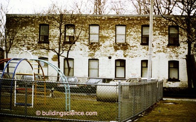

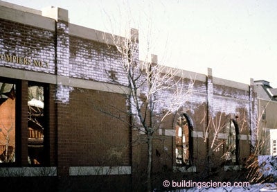

Getting rid of active chimneys and air sealing attic ceilings dropped neutral pressure planes and caused moisture havoc in cold climate exterior walls (Photograph 1 and Photograph 2). Just by looking at buildings you could often tell where the neutral pressure plane was. Many two story houses had frost on the second floor windows whereas the first floor windows were clear—infiltration through the lower windows and exfiltration through the upper windows—neutral pressure plane between the two.
Photograph 1: Peeling Paint “Tell” - Where is the neutral pressure plane in this photograph? Neat eh? Air exfiltrating above the neutral pressure plane typically carries interior moisture. This moisture is deposited in the wall leading to peeling paint problems. Below the neutral pressure plane air is infiltrating from the exterior carrying little or no moisture. Legend has it that in this building an old oil boiler with a large active chimney was replaced with a sealed combustion condensing gas boiler lowering the neutral pressure plane. Of course, this picture could also be explained by rain deposition, but I am sticking with the air leakage neutral pressure plane story because it is so cool.
Photograph 2: Stack Effect Damage—This is stack effect air leakage leading to moisture induced damage for sure. Not rain. Why? Only happens in winter when it does not rain. Efflorescence. It came from inside and ate your building…. wooo…scary stuff boys and girls…

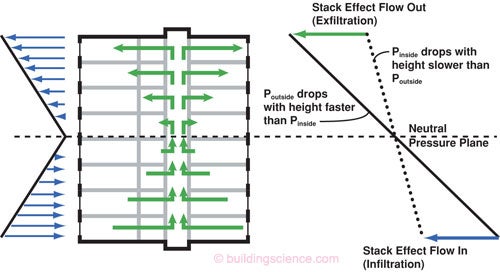

When we go to high-rise buildings the principles remain the same as do the problems. Stack effect driven airflows in tall buildings compromise smoke control and fire safety, adversely affect indoor air quality and comfort as well as increase operating costs for space conditioning energy (Figure 7). The air in lower units ends up in the upper units. I guess that is why folks in the upper units pay more for the privilege.
Figure 7: Stack Effect in a Tall Building—Stack effect driven airflows in tall buildings compromise smoke control and fire safety, adversely affect indoor air quality and comfort as well as increase operating costs for space conditioning energy. The air in lower units ends up in the upper units. I guess that is why folks in the upper units pay more for the privilege.

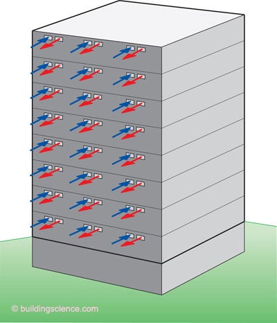

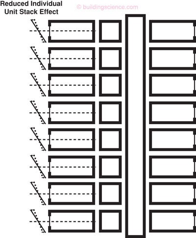

By isolating the units from each other and from corridors, shafts, elevators and stairwells stack effect driven interior airflows can be controlled (Figure 8). Today we call this compartmentalization. The most elegant argument for compartmentalization of tall buildings came from Handegord (2001).
Figure 8: Compartmentalization— Basically, you turn a ten story building into ten one story buildings that are stacked on top of one another. By isolating the units from each other and from corridors, shafts, elevators and stairwells stack effect driven interior airflows can be controlled.
Basically, you turn a ten story building into ten one story buildings that are stacked on top of one another. We wrote about this much earlier in BSD-110: HVAC in Multifamily Buildings.6

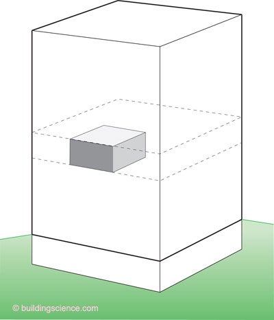

Achieving compartmentalization is not easy. You have to think 3 dimensionally and treat your interior walls like exterior walls (Figure 9). Back in the day some of us guessed at what unit air tightness should be. I proposed a minimum resistance or air permeance of 2.00 L/(s•m2) @ 75 Pa (Lstiburek, 2005). It seems to be working. This level of unit air tightness is necessary to control stack effect air pressures and to limit airflow from adjacent units and cross contamination.
Figure 9: More Compartmentalization—You have to think 3 dimensionally and treat your interior walls like exterior walls. A minimum resistance or air permeance of 2.00 L/(s.m2) @ 75 Pa of unit air tightness is necessary to control stack effect air pressures and to limit airflow from adjacent units and cross contamination.

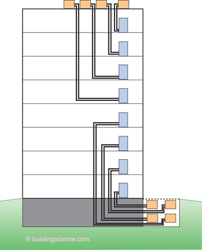

The compartmentalization principle can also be extended to heating, cooling and domestic hot water. Unit space heating and cooling and hot water is provided by individual mechanical systems located in each unit (Figure 11).
Figure 11: Space Conditioning and Hot Water—The compartmentalization principle can also be extended to heating, cooling and domestic hot water. Unit space heating and cooling and hot water is provided by individual mechanical systems located in each unit.

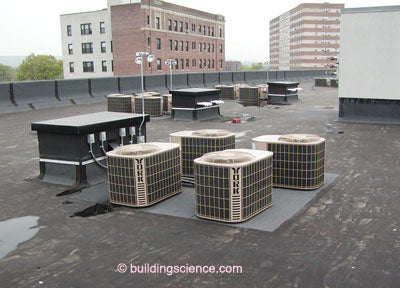

Rooftop penetrations are collected and located in “doghouses” minimizing penetrations. All cable, duct and pipes are run through walls of “doghouses” (Photograph 3). The “doghouse” lids are removable allowing for access.
Photograph 3: Distributed Mechanical Systems—This is why the Gods of Building Science invented flat roofs: a place to stash mechanicals. Rooftop penetrations are collected and located in “doghouses”—all cable, duct and pipes are run through walls of “doghouses”.
