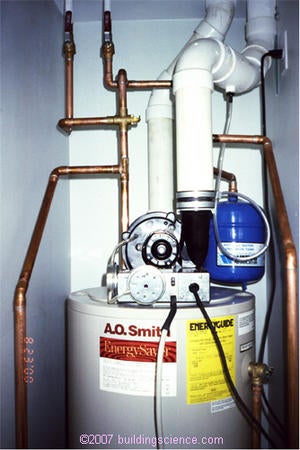

The compartmentalization principle can also be extended to heating, cooling and domestic hot water. Unit space heating is provided by sealed combustion gas furnaces and water heaters located in each individual unit (Photograph 1 and Photograph 2) that are vented either upward or downward through small diameter plastic ducts. Exhaust gases and combustion air are provided by separate ducts that follow parallel paths (Figure 5 and Figure 6). Most systems can be routed upwards or downwards 4 to 5 floors.
Photograph 1: Space Heating—Sealed combustion gas furnace provides space heating.
Photograph 2: Domestic Hot Water—Sealed combustion gas water
heater provides domestic hot water.

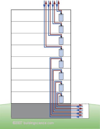

Figure 5: Gas Furnace Venting—Sealed combustion furnaces (two pipe systems – exhaust gases out and combustion air in) are vented to roof or down to dry well (“pit” with screen). Vent runs can extend up or down up to 100 feet.
Figure 6: Gas Water Heater Venting—Sealed combustion domestic hot water heaters (two pipe systems – exhaust gases out and combustion air in) are vented to roof or down to dry well (“pit” with screen). Vent runs can extend up or down up 100 feet.

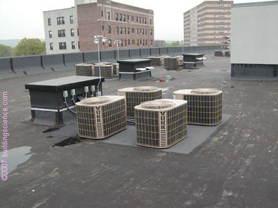

Air conditioning is provided in a similar manner with individual exterior units located on roofs or at ground level in dry wells or in parking garages (Figure 7). Combined heating and cooling with heat pumps is executed in the same manner.
Figure 7: Air Conditioners or Heat Pump Configuration—Individual units are located on roof or in drywell (“pit” with screen).
Rooftop penetrations are collected and located in “doghouses” minimizing penetrations. All cable, duct and pipes are run through walls of “doghouses” (Photograph 3). The “doghouse” lids are removable allowing for access.
Photograph 3: Services Located on Roof—Rooftop penetrations are collected and located in “doghouses” – all cable, duct and pipes are run through walls of “doghouses.”

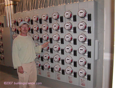

Central systems for heating, cooling and domestic hot water are not conducive to energy conservation since they do not encourage rational individual behavior unless individual metering is provided. It is the author’s experience that individual systems are the easiest to individually meter (Photograph 4 and Photograph 5).
Photograph 4: Individual Metering of Services—Rational behavior is encouraged when all services are metered and billed separately.
Photograph 5: Individual Gas Metering—Gas for space heating and domestic hot water is separately metered to each individual unit.

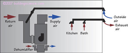

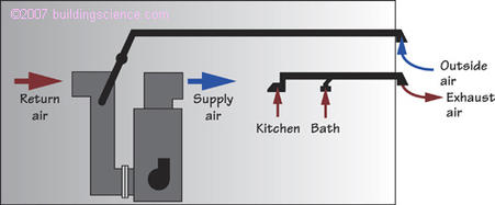

The author’s preferred system configuration is presented in Figure 8. An outside air duct is directly connected to the return side of an air handling unit. An inline motorized damper and the air handler blower is controlled by a programmable thermostat or other device to ensure minimum ventilation and to prevent over ventilation. Exhaust air is vented directly to the exterior from the kitchen and bath via an intermittently operated fan (or fans) controlled by the occupants. The author further prefers that the exhaust fan (or fans) are controlled by a switch with an integral timer that shuts off the exhaust fan (or fans) after a pre-set time (say 10 minutes) – a practice common in the hotel and hospitality industry.
Figure 8: Outside Air To Air Handler—Motorized damper in line with outside air duct connected to return side of air handler. Damper and air handler controlled by programmable thermostat or other controller. Kitchen and bath fans controlled intermittently by occupant.
Figure 9: Dehumidifier With Air Handler—Dehumidifier added to control part load humidity in hot humid climates.

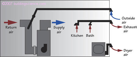

Dryers should be vented directly to the exterior (Figure 10). An even better approach, in the author’s opinion, is the use of condensing dryers that require no exterior vent. The water removed from the clothes is condensed and drained – no exhaust to the exterior occurs. This approach has obvious advantages with respect to make-up air (none is needed), and thus provides huge benefits in hot humid climates from latent load perspectives and negative pressures not to mention the benefits in cold climates arising from heat reclaim. In a hot humid climate a 200 cfm exhaust flow results in approximately a 1 ton load. During part load periods the 200 cfm exhaust is almost entirely a latent load dramatically skewing the sensible to latent ratio. And finally there is one less hole in the building enclosure to worry about.
Figure 10: Dryer—Dryer vented directly to exterior. Ventless condensing dryers are preferred.

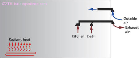

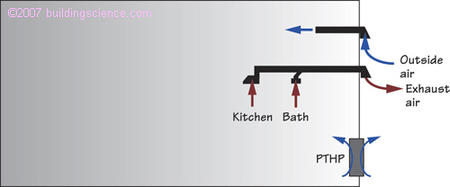

Not all apartment units or condominium units are designed and constructed with air handling units. Many units have electric heat and no air conditioning – particularly in the Pacific Northwest and others have through wall packaged heat pumps that provide both heating and cooling. Figure 11 and Figure 12 illustrate the compartmentalization approach for such units.
Figure 11: Exhaust With Outside Air Duct—Not the best approach as it relies on “induced infiltration” – the air exhausted will be replaced by infiltration air through the duct. Works best with effective compartmentalization (unit air tightness should meet a minimum resistance or air permeance of 2.00 L/(s.m2) @ 75 Pa).
Figure 12: Exhaust With Outside Air Duct – PTHP: Similar to Figure 11, but with air conditioning added via packaged heat pump.
Exhaust is provided by continuously operating exhaust fan with outside air (“make-up” air) provided by an outside air duct. In the authors opinion this is not the best approach as it relies on “induced infiltration” – the air exhausted will be replaced by infiltration air through the duct. In the authors experience this approach works best with effective compartmentalization (unit air tightness should meet a minimum resistance or air permeance of 2.00 L/(s.m2) @ 75 Pa) thereby limiting air drawn from neighboring units and the corridor and thusly favoring the outside air duct as a source of “make-up” air.

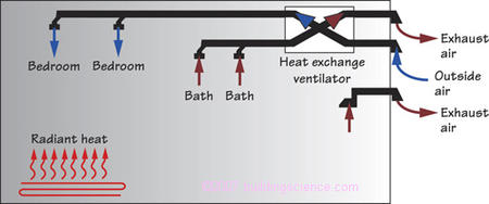

A better approach is presented in Figure 13 where both supply and exhaust of air is provided by a heat exchange ventilator. The installed cost of this approach is significantly more than the approaches described in Figure 11 and Figure 12. But the approach has the benefits of lower operating costs (in many climates – particularly extreme climates such as severe cold and hot humid) and not relying on “induced infiltration.”
Figure 13: Heat Exchange Ventilator—Expensive to install, economical to operate.
