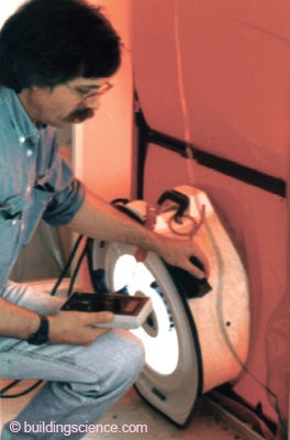

Folks are building houses and retrofitting existing houses with increased airtightness, and this is great. They use a blower door to help measure leakage, and this is also great. But then they think that a blower door actually is a precise measuring tool for how air will leak across the building during service. Wrong. Even more serious an issue is to then take the leap that using a wrong assumption about the results of an approximate measurement can be used to decide that mechanical ventilation is not needed. Bad, very bad, and potentially deadly.
A blower door measures a characteristic of the house, not the leakage rate of the house in service.
You can’t use a blower door to determine air change rates because a blower door does not give you the distribution of holes, and if you don’t know the distribution of holes, you can’t determine the pressure differences across them during service. If you don’t know both the distribution of holes and the pressure differences across them, you don’t know jack.1 Never mind that I love blower doors, and that I use them all of the time. Read on.
When someone puts a decimal place into a blower door-determined air change rate after a whole bunch of computer-assisted numerical manipulation, and proclaims that the interior environment in a house is safe without a ventilation system and without a provision for combustion air, I usually go have a bourbon because it tends to be more satisfying than getting a gun. I view these folks as little more than charlatans who run around for the sake of the show, rather than providing value to the process. If you are using a blower door for this reason, it makes more sense to take the money spent on the tester and the blower door and spend it on a ventilation system and combustion safety.2 I know I won’t win this argument because there is too much money involved in the show and managing the show, but I can get satisfaction in calling something “bull#@%!” when I see it.
Blower doors measure equivalent leakage area. Not the real leakage area and not the real leakage paths and certainly not the distribution of the real leakage area and the real leakage paths. Everything is sort of combined into a single near meaningless value. Not a meaningless value, but a near meaningless value. The real meaning, in my not so humble opinion, is that it can tell you when you get rid of the big holes3 and that is where I am going with this. We are going to focus on big holes and a great use for a blower door.
Blower doors are a quality control thing. But they are not the only quality control thing. They are one of many. And they are not always necessary despite what folks say. What they are not is a quality assurance thing. The difference is important. Quality assurance is figuring out what the right thing to do is; quality control is doing it. For example, the right thing to do is to “build tight and ventilate right.” Blower doors can help measure the “tight” part. They cannot measure the “ventilate right” part.
Photograph 1: The Ubiquitous Blower Door—I love what it can do and hate what it can’t do even though people say that it can. That is pretty clear, isn’t it?

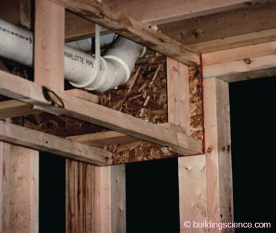

Photograph 2: Bathtub on Exterior Wall—The classic “Joe Hole”—a hole so big even I can crawl through it. It needs to be draftstopped with something rigid and airtight. Note to folks out there in the real world: fluffy insulation is not rigid and airtight. But a sheet of OSB or gypsum board over fluffy insulation makes the fluffy insulation happy and Joe happy.

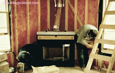

Photograph 3: Fireplace on Exterior Wall—OK, an even bigger hole than the bathtub hole. Kind of makes it funny to think about sealing an electrical wire going through a top plate when you have something this big.

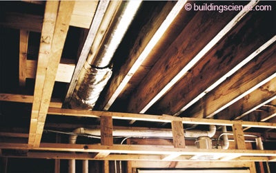

Photograph 4: Soffit on Exterior Wall—Wow, this allows for connecting your entire floor cavity to the outside.

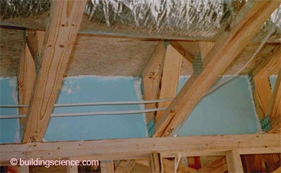

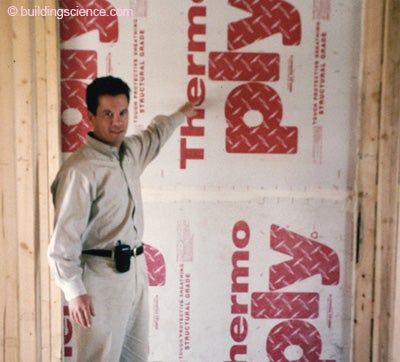

Photograph 5: Effective Draftstopping—Notice the rigid material behind the large soaking tub/whirlpool framing on the exterior wall. Notice the rigid material going up the exterior wall where the shower is going to be. Notice the big smile on the VP of construction for a major, major production home builder in Chicagoland. No comfort complaints for him anymore because there are no big holes.

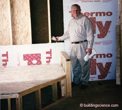

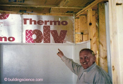

Photograph 6: Tub on Exterior Wall Before Tub Installation—Notice the rigid material on the exterior wall where the one-piece shower/tub thingy is going to be.
Photograph 7: Tub on Exterior Wall After Tub Installation—Notice the rigid material on the exterior wall behind where the one-piece shower/tub thingy is. Notice the even bigger smile on that VP of construction.
Photograph 8: Draftstopped Fireplace—Pretty easy to get right if you know this is a really big hole. The draftstop makes the fireplace work even better because the fireplace is also warmer. Warm fireplaces draft better. Warm chimneys draft even better.
Photograph 9: Draftstopped Soffit—’Nuff said.

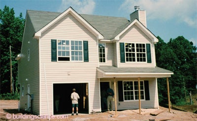

Anyway, nothing much happened over the next decade, and R-2000 fizzled out. I came to the U.S. to seek my fortune and got involved with a few big builders. Folks who built 20,000 to 30,000 houses a year each. It turns out that a bunch of the big U.S. builders had comfort complaints because they were building houses with big holes. I figured I knew about holes and I was off to the races. The good news was there was no standard so I could make one up. I had already had experience about how to make things up.
I picked one of the big builders’ worst divisions in terms of comfort complaints—it turned out to be Chicago—and focused on making the comfort complaints go away. Notice, energy had nothing to do with any of this. I figured that if they got rid of the big holes the comfort problems would go away. The list of big holes was pretty easy to compile. Bathtubs on exterior walls, fireplaces and chimneys on exterior walls, garages attached to houses with bedrooms over them, cantilevered second floors, interior soffits dead ending into exterior walls and dropped ceilings under attic insulation. Done. Make these go away with draftstopping and, presto, the comfort problems would go away.
In one year we did a thousand houses and, sure enough, the comfort problems went away. I measured a lot of stuff with blower doors, and the houses were coming in at around 3 ach@50 Pa—consistently. Apparently, the Swedes had been on to something. I wasn’t completely dumb by then and made sure that every house had a controlled ventilation system and made sure that all the gas furnaces and gas water heaters had combustion air and that we had tight return systems so we didn’t back draft anything. It became even easier when we started specifying sealed combustion 90 plus gas furnaces and power vented water heaters.
