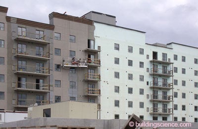

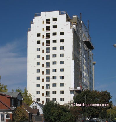

Canadians do live in igloos. Unlike the Inuit snow block version they’re typically taller than 10 stories and they are made out of foam. Insulated Concrete Forms (ICF’s) are beginning to come into their own in many locations, particularly Ontario (Photograph 1 and Photograph 2). Think of large Lego blocks made from polystyrene insulation filled with concrete (Photograph 3).
Photograph 1: High Rise ICF—Fifteen stories and counting…

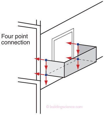

Photograph 2: Thermally Broken Balconies—Clip on balconies where exterior balcony corners are supported by columns supported by the balcony below.

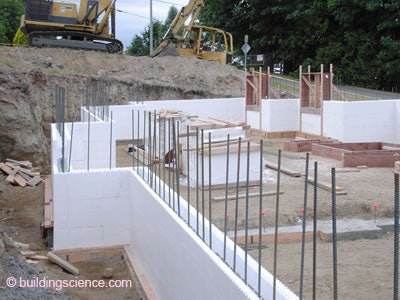

Photograph 3: Foam Building Blocks—Stack ‘em up and fill ‘em with concrete.

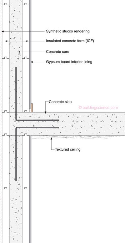

The foam is a stay-in-place form for cast-in-place concrete1 (Figure 1). The “effective” thermal resistances of these assemblies range from R-16 to R-25 depending on the specific product and the floor details. That is usually 2 to 4 times the effective thermal performance of most typical assemblies.2 No fluffy stuff shoved into steel stud thermal bridges. No exposed slab edges. Just continuous, glorious thermal insulation. It takes your breath away.
Figure 1: ICF Section—It’s a beautiful thing to see all of that continuous insulation. No thermal bridges. Makes me want to cry from happiness – in fact I can feel a little tear forming at the corner of my eye and running down my cheek as I write this…

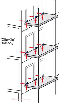

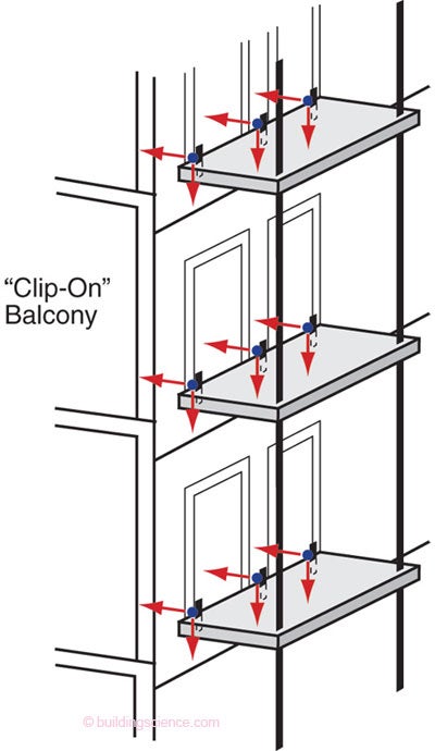

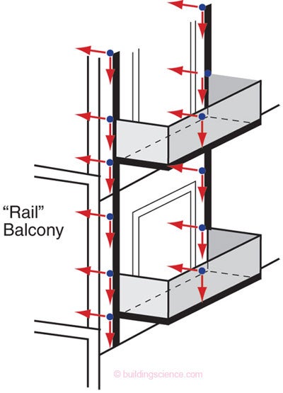

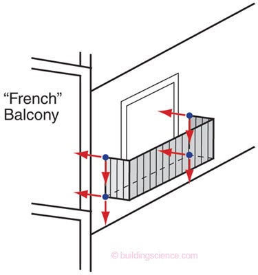

It gets better. Clip-on balconies, French balconies, rail balconies (Figure 2) and other structural innovations have seemingly banished the typical thermal bridging associated with multistory concrete frame apartment construction.3 Harley Davidson architecture is dead (see “BSI-005: A Bridge Too Far”).
Figure 2: Structural Engineers Getting Serious—Give smart folks a problem that needs to be solved and get out of their way. All of these approaches allow for continuous insulation behind the balcony slabs.

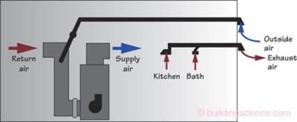

When ICF’s are used in apartment construction with internal compartmentalization (Figure 3), distributed ventilation systems (Figure 4) and distributed conditioning systems (Figure 5) the energy performance is nothing short of extraordinary (see “BSD-110: HVAC in Multifamily Buildings”). The only possible thing that can screw up the performance is over ventilation.4

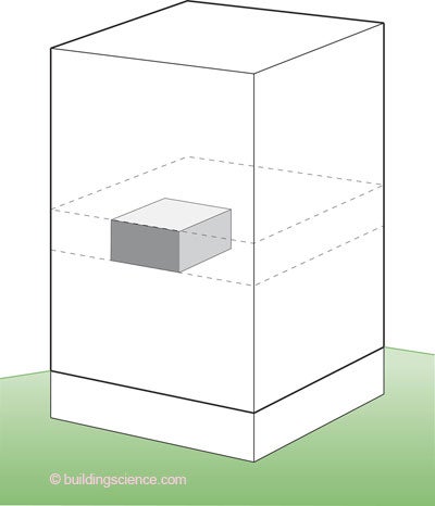

Figure 3: Unit Air tightness—Each unit is isolated from adjacent units and from the exterior by an air barrier system of minimum recommended resistance or air permeance of 2.00 L/(s.m2) @ 75 Pa. The inter-unit separation must also meet the specific fire-resistance rating requirement for the given separation.

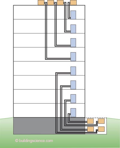

Figure 4: Distributed Ventilation—Individual unit ventilation is provided across exterior walls not across interior pressure boundaries such as floors. Outside air is supplied to unit air handlers. A motorized damper is installed in line with an outside air duct connected to return side of air handler. A programmable thermostat or other controller controls the damper and air handler. Occupant controls the kitchen and bath fans intermittently.

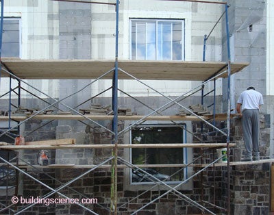

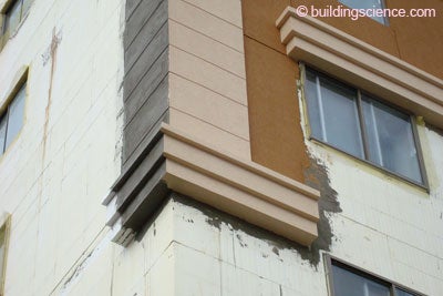

With ICF construction service raceways are routered into the interior layer of foam to run wiring. A gypsum board interior liner provides the interior finish. Exterior claddings are typically direct applied synthetic stuccos or manufactured stone veneers (Photograph 4 and Photograph 5).
Photograph 4: Synthetic Stucco Rendering—Complex aesthetics are possible and typical.
Photograph 5: Manufactured Stone Veneer—Wire mesh set in a cementitious rendering provides the base for an adhered direct applied stone veneer. Think lumpy stucco…
The water control layer is typically the rendering applied to the exterior face of the ICF. Think of a mass wall with no water sensitive elements. Incidental leakage through the exterior rendering is stored and dissipated in the foam and concrete layers of the remainder of the assembly. Drying happens in both directions.5 Claddings that do not require renderings are attached to the exterior of the foam blocks with furring strips. The back ventilation and back drainage of these types of claddings limit the water load on the exterior face of the foam blocks such that no treatment of the exterior face of the foam blocks is necessary. The joints in the foam blocks with respect to rain penetration can be ignored.

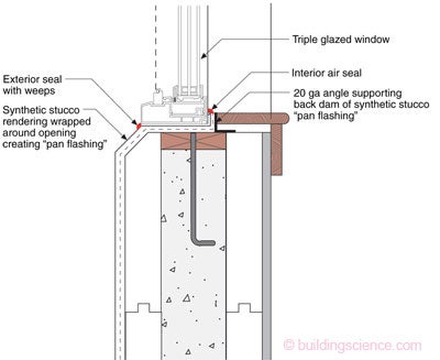

Another annoying issue is the water management of “punched openings” such as windows. There are only two kinds of windows in the world–those that leak and those that will leak. So what to do? Easy, wrap the water control layer around the window opening creating an under window “gutter” (Figure 6). In most cases the water control layer is a synthetic stucco rendering. It can also be a “liquid applied flashing system” that is then integrated with the exterior layer on the ICF’s. With back ventilated and back drained exterior claddings attached to the ICF’s with furring strips no additional water management on the exterior face of the foam blocks is necessary, as mentioned earlier. However, this does not apply to the punch openings in such assemblies. The punched openings need to be lined with a liquid applied flashing system to get rainwater out to the exterior face of the foam ICF’s. Punched openings in all ICF assemblies regardless of cladding system need to be lined.
Figure 6: Punched Openings—There are only two kinds of windows in the world–those that leak and those that will leak. Openings need to be wrapped with an “under window gutter.” Note how the exterior rendering is wrapped under the window unit.
