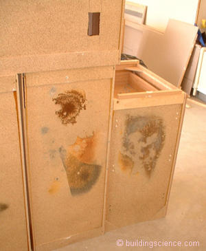

Now we can take the fibers and grind them up into sawdust and then compress them all together with glues and nitrogen. And we get particleboard. Where do we get the nitrogen? From the back end of a cow—urea from cow urine. What do you think the particleboard smells like when it gets wet? What do we make out of the particleboard? Floor underlayment, cabinets, furniture, tables. The nitrogen is like Cajun seasoning to the mold. If you are mold and you have a choice between hardboard and particleboard what are you going to choose? Particleboard (see Photograph 2).
Photograph 2: Grass Cabinetry—Greenie weenie compressed grass laminate used in kitchen cabinets didn’t fare very well in this “award winning” sustainable community. Solution? Get rid of the grass stuff? Nope. Back vent the cabinets.

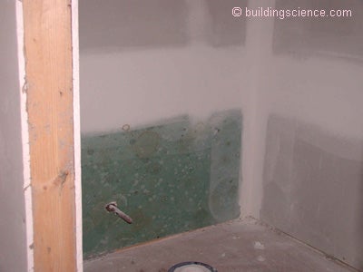

What next? We dissolve the fibers and reconstitute them and get paper. Old mold with no teeth can eat paper. What do we do with this paper? We laminate it to both side of gypsum board. We make paper-faced gypsum board. And what do we do with this gypsum board? We line the inside of our buildings with it. If we build commercial non-combustible assemblies we line the outside of our buildings with it. We build our demising walls, our shaft walls, our service walls, and our party-walls with it. We are in essence building paper buildings. Even the dumbest of the three little pigs didn’t build his house out of paper.
And then what do we do? We color the paper green like we are going to fool the mold. And then where do we put the greenboard? In a shower. Let’s put green paper in a shower and cover it with “lick and stick” tiles—there’s a good idea. Coloring the paper green to protect it from mold is like putting lipstick on a pig—at the end of the day you still have a pig (Photograph 3).
Photograph 3: Greenboard—It’s not a good sign when the mold is already on the greenboard before the tiles are installed. What gives? The waxes added to protect the paper from liquid phase water—to meet a ridiculous ASTM spec—are “mold food.” When products are optimized to meet arbitrary ASTM specifications rather than optimized to meet the “real world” problems result. Of course paper in a shower regardless of color is pretty dumb.
So what do we do? Not use paper-faced gypsum? No, paper-faced gypsum is one of the miracle products of the last century. It made housing affordable and is the mainstay of commercial construction—it replaced wet applied interior finishes such as plaster and lath. “Drywall” replaced “wet walls.” What we have to do is not use it in wet areas. Don’t put paper-faced gypsum in a shower or the outside of your building or in a party-wall that is constructed before the roof is on and the building is “dried in.” We have other products such as glass-faced gypsum and cement boards for these applications. Paper-faced gypsum is a fantastic material that we are going to use well into this century—but we are going to have to pick our spots where we use it better.

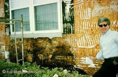

Photograph 4: Window Openings 1—Leaking windows and OSB are a match made in consultant heaven. Notice the smile on the famous unidentified consultant. Of course the EIFS cladding had a little to do with this as well.

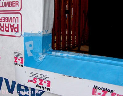

Photograph 5: Window Openings 2—Notice the pan flashed opening. The products are discretely left unidentified.
The trends are already obvious. Every window and door opening will have a pan flashing because incidental water is no longer tolerable with engineered materials (Photograph 4 and Photograph 5). We have committees and manufacturers going crazy figuring out installation practices for windows and doors. No double vapor barriers allowed.5 Crawlspaces are going to have to be constructed “conditioned” or will have to have use rigid insulation to protect OSB based I-joists and OSB based sub-floor sheathing from exterior moisture (Photograph 6 and Figure 1). Greenboard in wet areas has just been banned in the Model Codes6 (Photograph 7). We are going to have to back vent our cabinetry. And this is just the beginning.

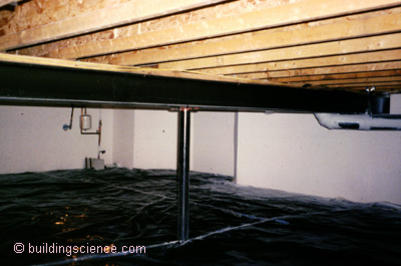

Photograph 6: Conditioned Crawlspace—Constructing crawlspaces like mini basements locates the engineered products within the interior environment.

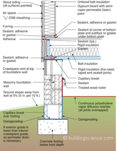

Figure 1: Protected Vented Crawlspace—Rigid, non water sensitive, vapor impermeable insulation is installed on the underside of the floor framing and floor sheathing creating a micro-climate suitable for engineered wood structural framing and sheathing.

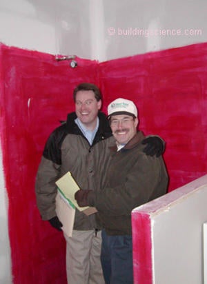

Photograph 7: Cement Board Shower Enclosure—A happy couple inside a cement board shower enclosure that has been coated with a liquid applied waterproofing prior to the application of tiles. They are happy as they are service and warranty personnel from a major production builder—they are celebrating the banishment of greenboard.
